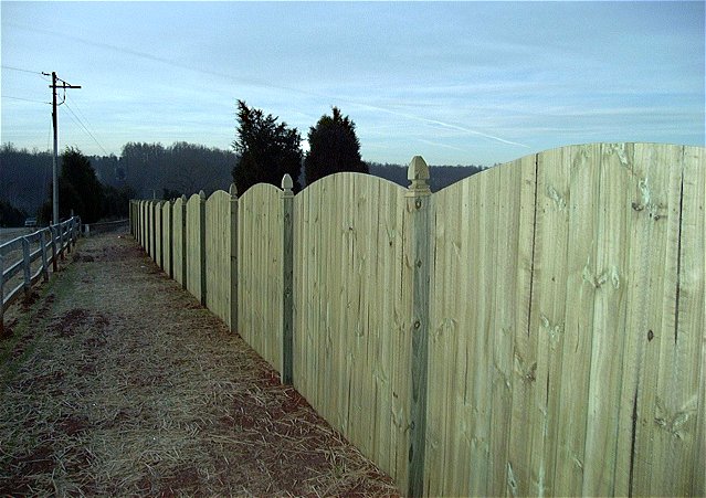

When my parents moved from GA to NY they had some 8'L x 6'H wooden fence sections that looked like the ones in the attatched picture, they screwed them together (2 long along the sides and a slightly shortened one on the front and back) on a 16' double axle landscape style trailer. they tarped the whole thing and off they went. The fence sections are now making a leanto off of the shed to park the lawnmower in.
The fence sections originally came from when a road was being moved and the city ripped out the "old" (less than a year old) fence and installed a new one, we got a couple of trailer loads of fence sections for free out of that.

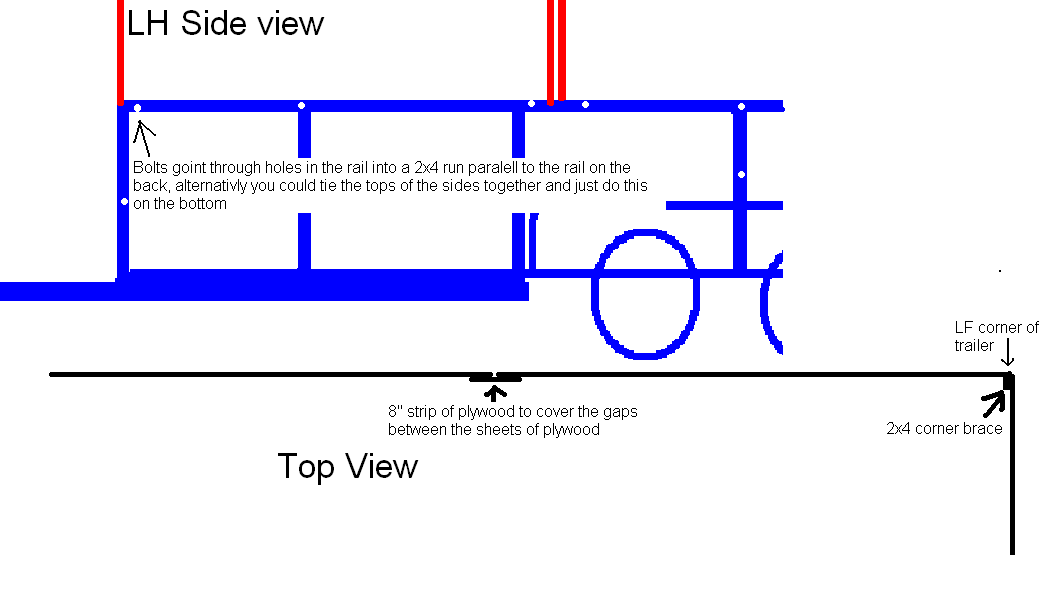

Attached is an idea on how you could make a set of sides with plywood and 2x4s

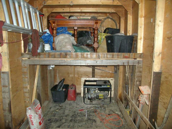

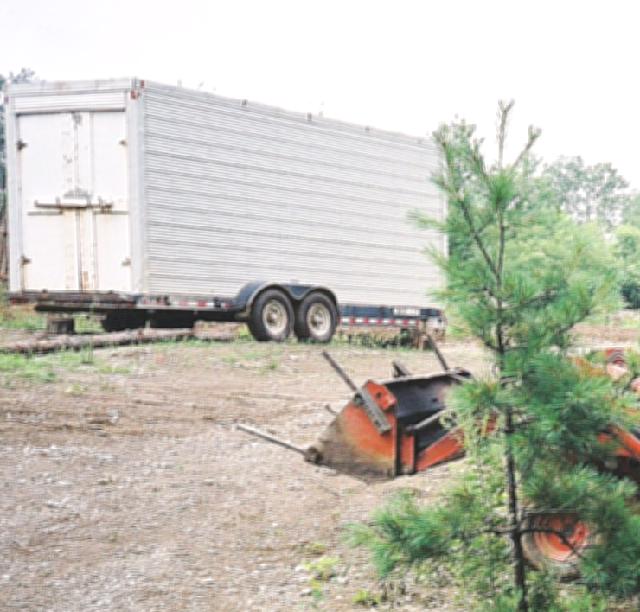

I have built a box on a twenty foot bumper pull trailer for the exact purpose the OP is wanting.
It had a 2x4 frame covered with the 1/4 plywood and then sheathed with metal roofing. The frame was bolted to the trailer frame. Inside I had two levels as this made it easier to stake stuff inside. It was heavy and ugly.
Just last week I removed the box for good.
Doing it again I'd really consider a buying cargo type trailer.
