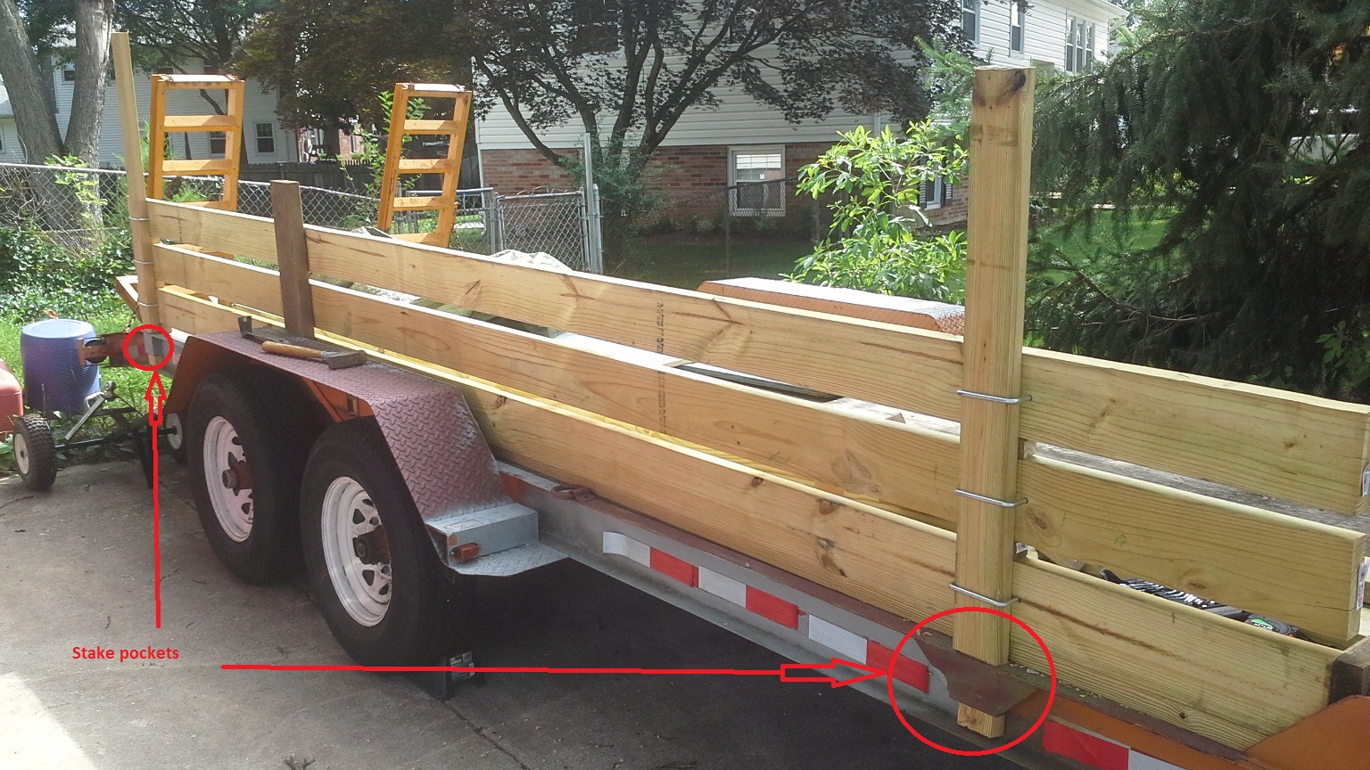

I've got several threads going since 2009 regarding my quest to make my Hud-Son 18' equipment trailer
a temporarily enclosed trailer.
to facilitate moving household goods from the DC area to Mississippi, about 900 miles, mostly interstate.
First of all BUYING AN ENCLOSED TRAILER HAS BEEN VETOED BY BOTH SWMBO AND AVAILABLE SPACE. and having the 12K equipment trailer is vital.

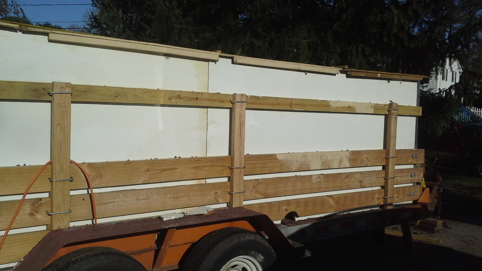

When I finally got around to building I was also faced with the need to haul mulch and gravel so I started with "stake sides"
http://www.tractorbynet.com/forums/trailers-transportation/319092-new-sides-my-trailer-double.html?highlight=

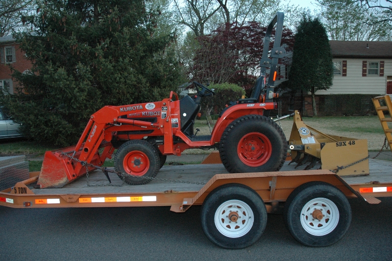

then added 4x8 sheets of 3/4 PT plywood horizontal sides with 1/2 PT for the roof as seen in the second pic. This worked fairly well.
Almost everything is fastened with 3/8" bolts and most of those are 3/8 square U bolts. Assembly BY MYSELF from pic 1 to pic 2 can take me a few hours, but with my DeWalt 20V max screwdriver and a nutdriver it goes fairly quick. Reverse the process and it's quicker. I haul it down to Mississippi, unload, disassemble, haul it back folded up.
I only went 4' high at first because I was concerned of wind loading etc. Well, that's worked great for two trips, now I want to get high(er). When I first built it I was thinking I'd slap the sides up, put the roof on, haul the stuff down. The last time, mainly because of offspring returning to the nest, it became put the sides and roof up and load over a few weeks. This required loading the front of the 4' high cave in a squatting position. Higher will be better for that.
I will probably put shelves in up front, it depends on what the load will be.
I was originally thinking of going to 6' (I'm 6'2) but am wondering how much the "extra" wind loading will affect the hauling. I think I can get by w/ a 5' ceiling by stooping.
So any recommendations as to height? I've moved all the "tall" stuff down already.
