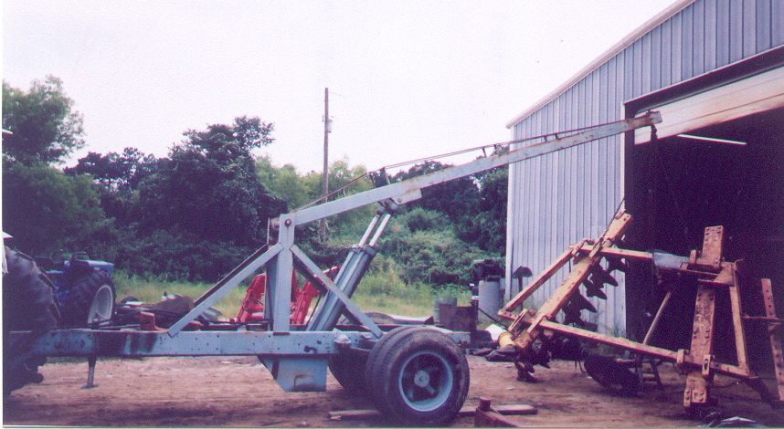

I remebered the post some one put here a few months ago about a homebuilt trailed boom they saw. A few years ago I worked in Clarksdale MS and there is a tractor store outside of Bates ville that has a booom they built from a 2 ton truck frame. Its pulled with a big Ford TW15 I think. I drove by there this summer to look at some belarus engines they had. I took a few pics of this tool lifting a disc. I m wanting to build one in a few months. I saw one similar but was out of film that was built like this but the tubiing the boom was made out of had a reciver on the end for a man basket or a set of forks for placing materials. PS the dealer is Delta Tractor

I dont know what any of you want to do with this, but remember that the rear end of a TW 15 is about 2500 kg, something different than the compacts most of the people on this board have....
I think it will launch the rear end of a Kubota if you try to lift a disk harrow with one of these... /forums/images/graemlins/grin.gif
Some years ago, we used a borrowed 3 point lift boom, that worked pretty well, even without the lifting rams, it worked just on 3p lift force.
With a 3p lift boom with those rams, i would put a wheel or a slide foot on the underside of the 3p lift frame.
Maybe your top link will break, but the risk of lifting the rear end instead of the load, is a lot smaller then.

Renze A smaller berssion would be handy, also a counter weight could be used on tounge for heavy loads. A company in Argentina used to make a compact tractor boom like this that had an attach ment for a hay bale spear.
The main reason one of these booms is handy is to to place an akward load that you wouldnt want close to the tractor like a metal truss or setting poles. THe other handy thing to have with their othr boom is the manbasket attachment for there orchard and farm. They have some safety valves on the cylinders to preven a fall. They also have a remote lift so one person can use it to lift themselves to paint or weld on the pole sheds.I do agre not everyone would have a use for on that big.

A couple of downriggers on the back would help with the stability prob.
   / trailer boom #5
then how ya gona roll it around tho if ya have outriggers on back

As you might have read in my posting tag, i live in the Netherlands. At this side of the Pond, a popular lifting attachment is an old, used forlift mast with three brackets to convert it to tractor 3p lift use.
Biggest problem with these is that the mast is quite heavy, i think the compact tractors alike the average board member of this site have, will have trouble lifting the forklift mast alone.
I really like to watch over the borders for good ideas, and ask why people do things the way they do.
About the outriggers on the pictured boom, putting the axle of the lifting boom more to the back, or putting the attachment point of the lifted load more to the axle, would give the same effect.
The best effect is aquired when the load is lifted inbetween the wheels, but that means that you're going to need a very wide axle in U-shape.

Renze your right on the ushaped frame and stub axles. I used to have a rig I built like that for settin posts for signs and such I had to have a high lift and the abilty to hold it plumb. We also use alot of forklift fronts on farm tractors. Here there alot of old warehouse lifts like the 1200 pound capacity Clark lifts and they have light masts. Usually the forks are the highest item but when you weldthe lift arms o nthem they shoot up the price. I can buy whole lifts 200 dollars each. I have some big pallet stackers Im cuttin up now one is for a 1066Farmall and the other is for a TW15 Ford. Ithink they have a lift of around 15 feet.
