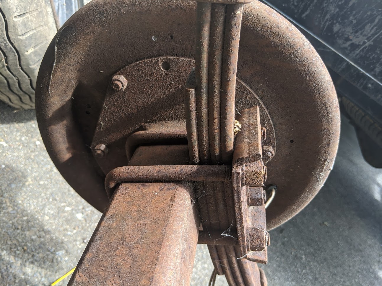

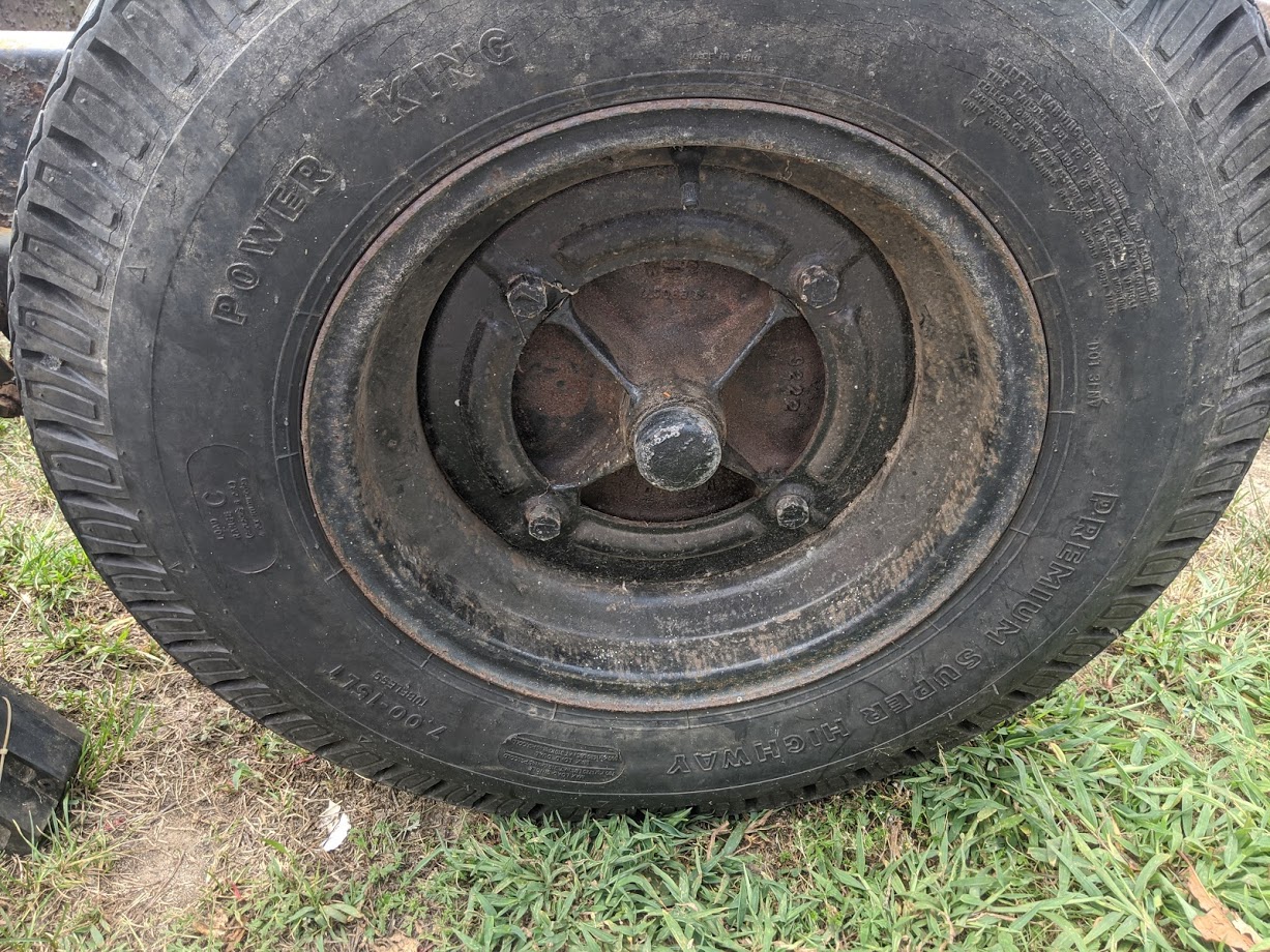

Hello!
I picked up a 1979 travel trailer to use as a project, going to put a dump body on it.
The axles that are on it appear to be original dexter axles, the 4 on 9.44" bolt pattern ones. (NOT rim clamp MO axles). These are about a 4.5" drop with a 2.75" tube. Not sure of the rating, figure at least 3500lbs each? Brake drums say "max diameter 10.040". Backing plate is welded to the stub, NOT bolt on which concerns me about future upgrading of brakes/drums. Tires are 7-15.

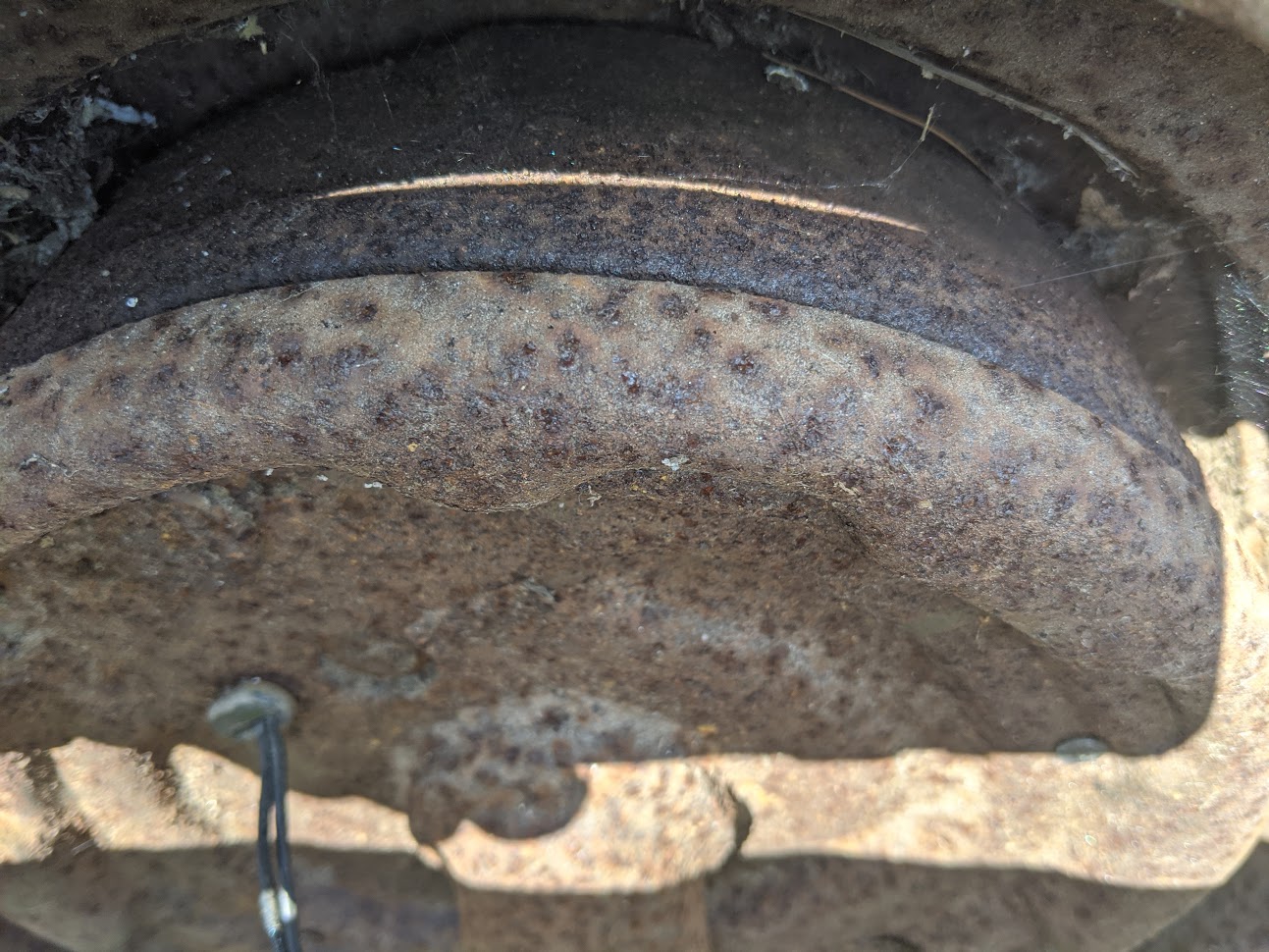

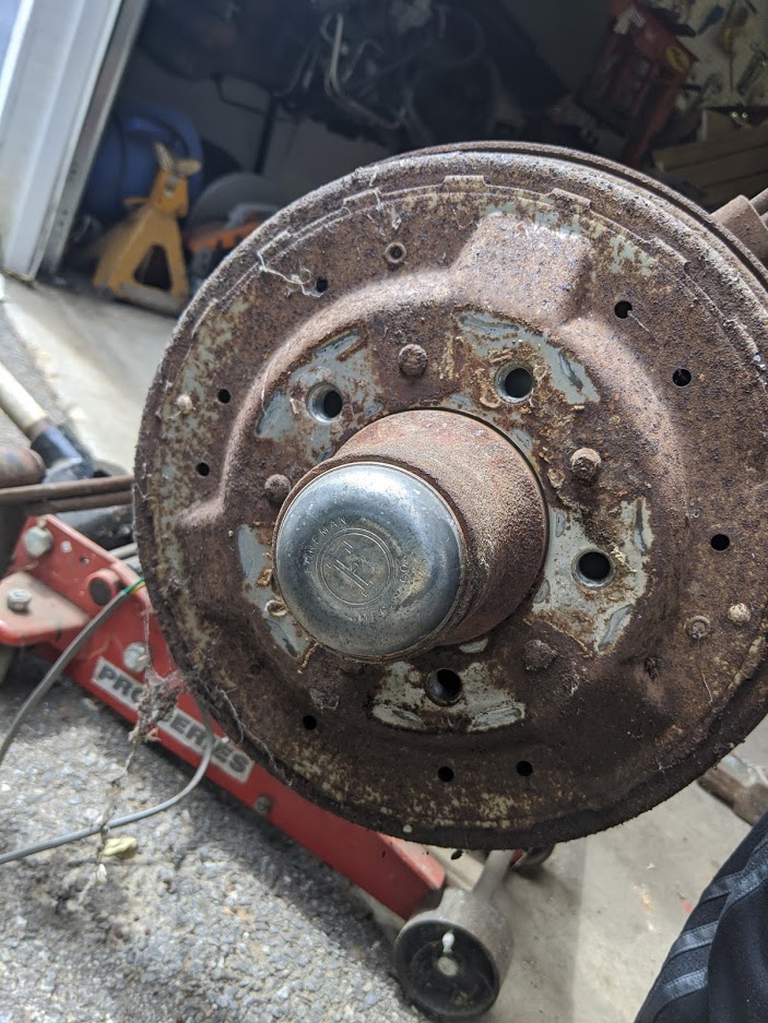

I also have a set of axles + springs with a 5 on 5.5" bolt pattern, with a large 3.75" center hole, and 7-15" tires. The drum appears to be at least 12", and the hub and drum seem to be riveted together as one assembly. The backing plates appear to be bolt on, which gives me hope that the axle can be upgraded to a modern brake/hub if I needed. The beam is a 2.75" square. The cap on the hub says "Foreman". These are straight, no drop.
So assuming the brakes work and have sufficient lining on both sets, I'm trying to decide which axles make more sense to use for my project. I have some flexibility in the tongue height and deck height since I need to cut up and shorten the trailer anyway. Just trying to decide which axles are a better starting point?

If your in Salem, take a ride over to TexTrail Trailer Parts, 125 Northeastern Blvd., Nashua - TexTrail is a Dexter distributor, when you go, if you have a truck bring the axle if not bring the pitchers - ask for Steve Masson - he's the branch manager, knows dexter product / trailer parts - been doing it for 20+ years - The four bolt has not been made for a long time - I would not use - I'm sure Steve will be able to assist in answering any questions as well as getting you what you need -

I'm really leaning towards using the Foreman axles, mainly because I can use a normal 5 on 5.5" wheel, and hopefully update the hubs down the road. (and the axles appear to be in better shape). The bolt on backing plate gives me hope that even if I had to re-drill the bolt pattern I could mount modern backing plates.
The dexter "dexstar" axles use the unique 4 on 9.44" rims (which I also can't use my tire machine on) and with the welded backing plates it might be more work to convert them.
Was hoping someone had experience with both on here..
