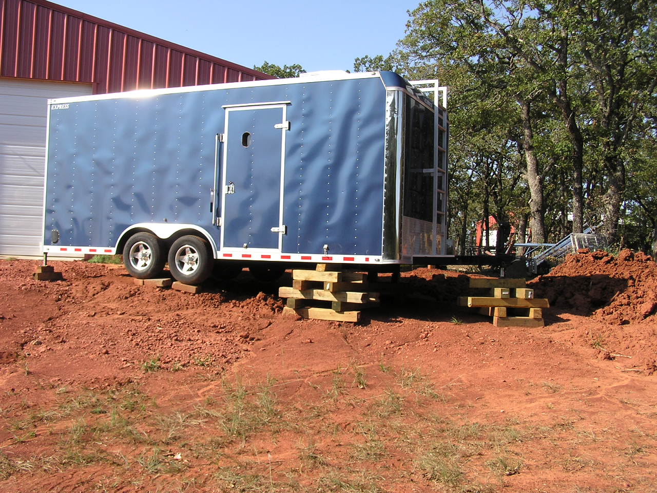

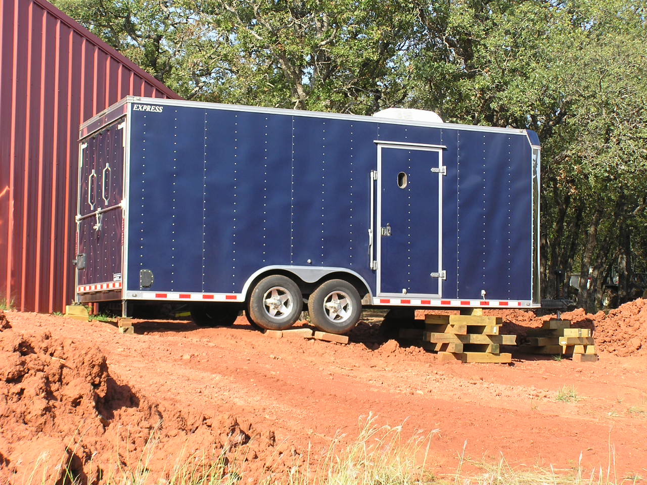

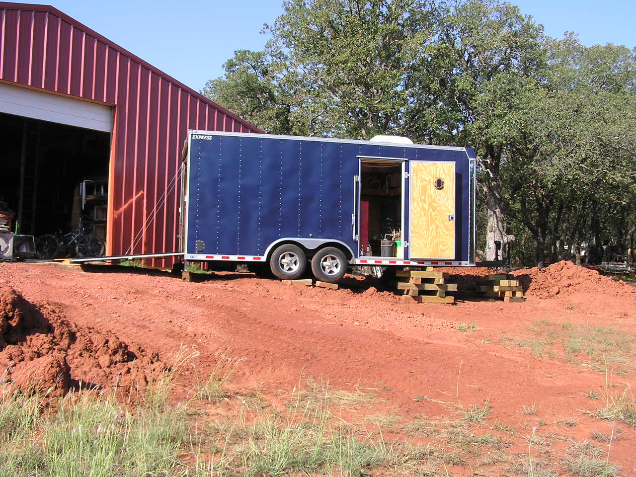

Back in 2011 I found this Express cargo trailer on craigslist. Used it to move stuff to the new shop.
The side door would be handy for tying down the front of the tractor.
