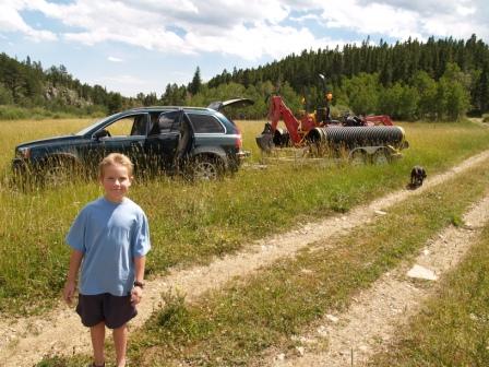

As an update -
I ended up getting a dual-axle 7000# 6x12 trailer with stowable ramps. It's actually more of a car loader design - very beefy frame with only a front rail made here locally in Fort Collins.
I had to play with the loading position and found that backing on was the best as it presents only the backhoe arm instead of the FEL to the back of my Volvo. I bought load straps at a farm store and strap down each corner. When the guy brought the trailer by for me to load his truck lifted up 2-3 feet when I drove on - scared me silly at first. Now I have a short block of timber that I put below the back end of the trailer - much safer feeling. I also used some marking paint and marked the center line of all four wheels on the wood bed with bright orange paint so it's easy to know where to be on the trailer.
I drove up and replaced my parents' culverts in one day. The plastic culverts strapped on the trailer made it look like I had solid-rocket boosters on my GC2310 - take a look at the attached picture.
Thanks again for the advice and help!
