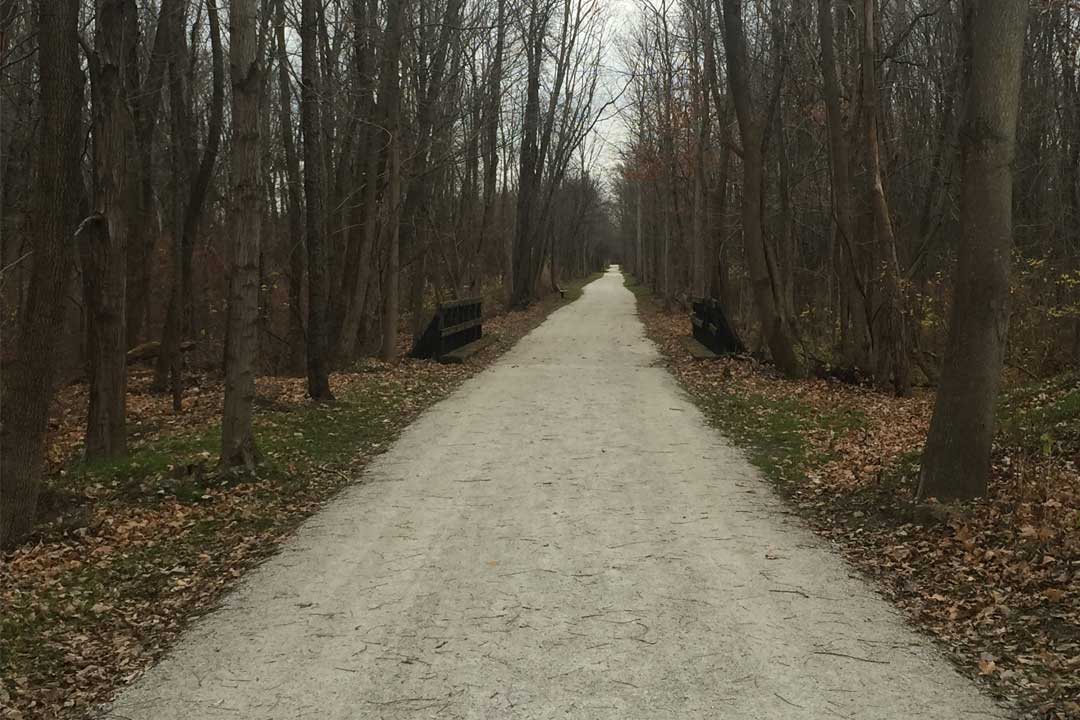

So I will be adding pictures to this but wanted to get it written out while I was thinking of it...I've started working for the local county parks. Our trails are mostly limestone, 304 base and crushed fines topcoat. It holds up rather well aside from the occasional washout after a good downpour....anyways my question is about laying new trail, we use pavers to spread the material and it is a slow process because of the fact that we put it down rather thick and have to use 5ton trucks to fit down most of the trails. Our pavers are showing their age, 26 years, and lack of maintenance.
Is there something else out there that I don't know about that could do a decent job of spreading the material?
Boxblade behind a tractor is even slower and not even enough over the whole trail. I'm wondering about the box blades that get pulled behind a tractor to level a field, not 3 point type but a pintle hitch. We could hook that to the trucks and tailgate the material and pull the blade as we're going. I'd have to sort out the hydraulics but it's doable.
The trails for the most part are 10 foot wide, for perspective think of old railroad beds. Not usually real twist and turn.
Sorry for the long read, like I said just wanted to get it out there while I was thinking of it. I'll add pictures tomorrow sometime hopefully. Thanks in advance for any ideas!

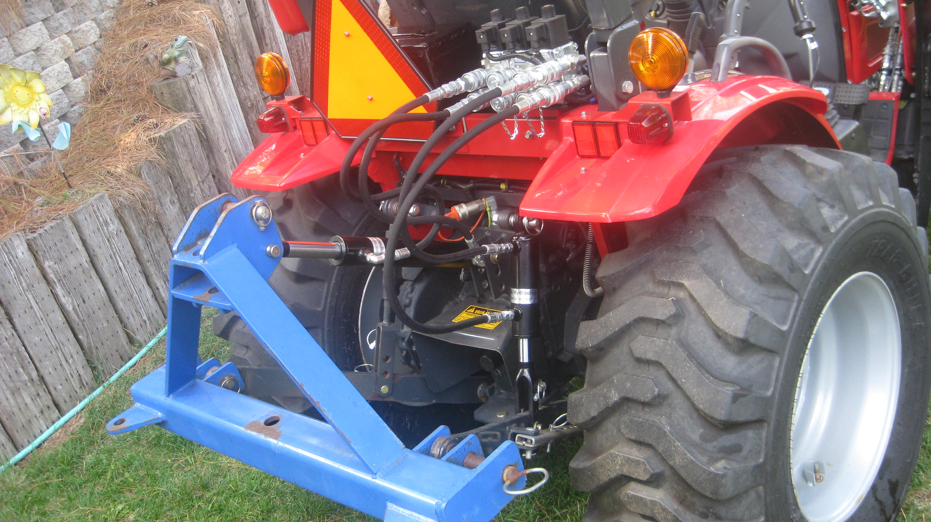

T&T
The top link and side link of your 3pt hitch are changed to hydraulic cylinders. Making adjustments without leaving the seat really changes things. Get good at making adjustments and you never even stop, just make them as needed on the move. :cool:

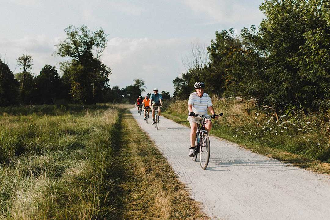

Yea a land leveler is along the lines of what I am thinking, just not sure its the ticket either. we will probable end up sticking with what we are doing but thought i would tap into this wealth of knowledge to find out.
I like to think we are doing a pretty good job on the trails, 150+ miles and growing. A couple pictures below to give an idea of what we are working with, of course every trail is different.

T&T
I see, i didn't know that is what those are called. No, we do not have them. I will look into them.

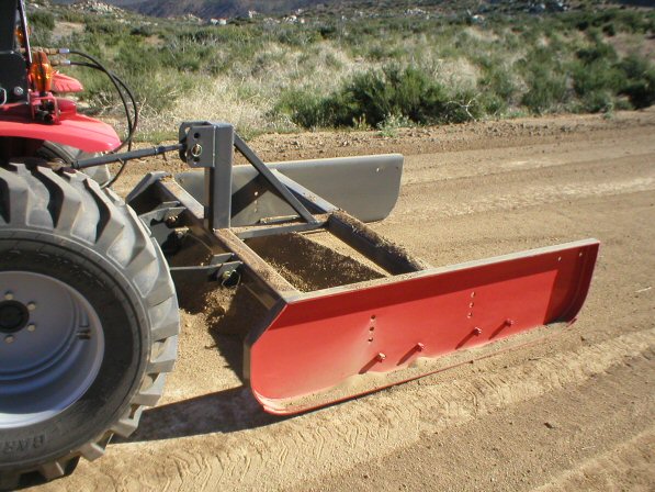

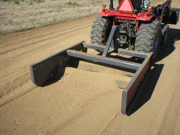

   / Trail maintenance #9
If you guys are getting it close tailgating the material, A LPGS will finish the job as well as being the best implement for general maintenance IMO. :thumbsup:
