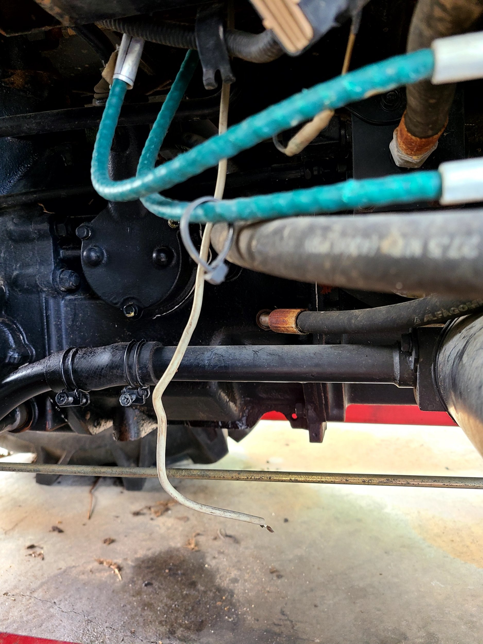

3. While looking and checking everything regarding the tractor not starting, I noticed that above the battery, the Glow Fuse (50 Amp) was blown. I replaced with a new fuse and as soon as I turned the ignition key, the fuse is blown again. I noticed a grayish wire tangling on the right side underneath the tractor. See photo. Does anyone know what this wire is? Is this the reason the Glow Fuse is blown? Is this somehow related to the tractor not starting?

To me, the wire seems not related to your problem. It might be the wire for a third function.

Don't know where the wire went but is looks like it used to have a connector on it. Perhaps it goes to something else that is now damaged. Or has a lonely connector and no wire. It may go to a safety switch/relay which doesn't allow the tractor to start. Diesels don't need electric to run--All they need is air, compression and fuel. All the electric stuff is add-ons for convenience and safety.

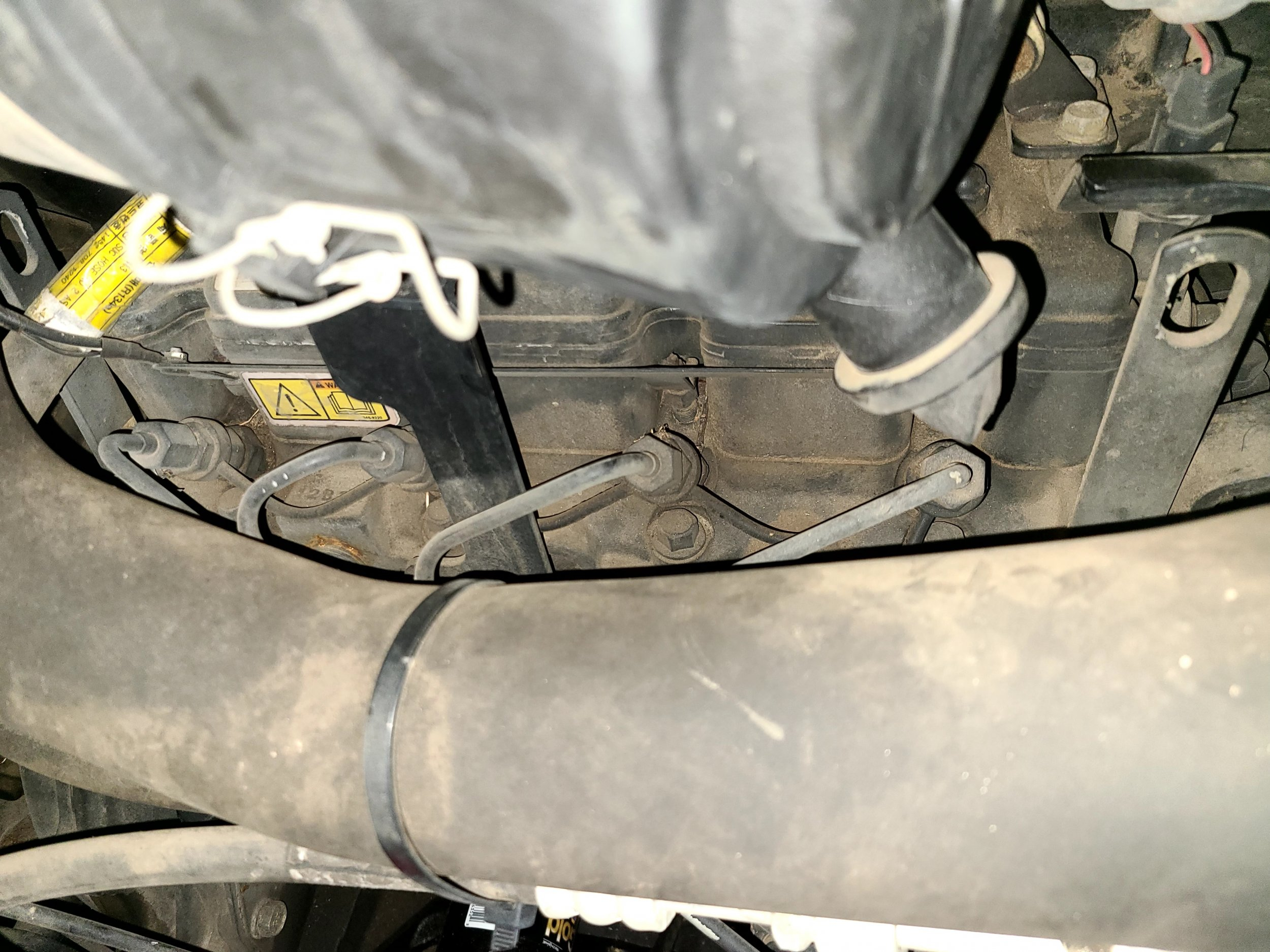

Apparently the fuel pump went out and the result is that the tractor ran out of fuel.
replaced fuel pump. still tries to crank but not starting.
I let the air out of the fuel filter assembly.
I then went to the injector lines and loosed the 4th line at the rear position (to far left in photo). Air (bubbles and fuel came out). I did this with the other three lines. Even after 30 seconds, No air, no fuel coming out of 2 and 3. Finally a little fuel out of #1 (to the far right in the photo), the closest to the front of the tractor. Does this seem to be right?
Any suggestions.

I was able to get the tractor to start. It will run for about 10 seconds and then it shuts down as if out of fuel.
I am sure that this has something to do with the fuel injector lines mentions above.
Thoughts.
