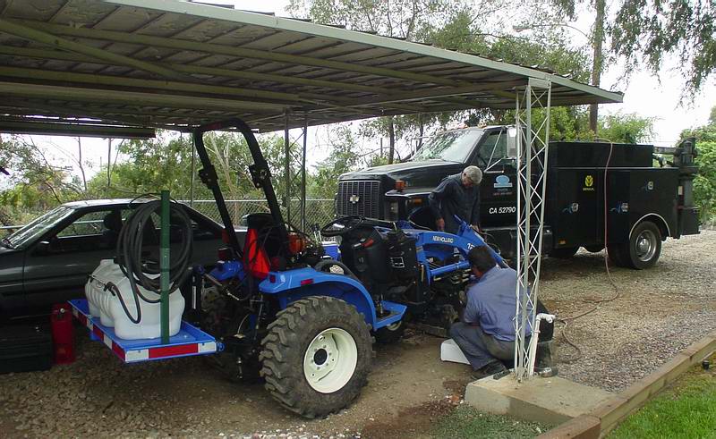

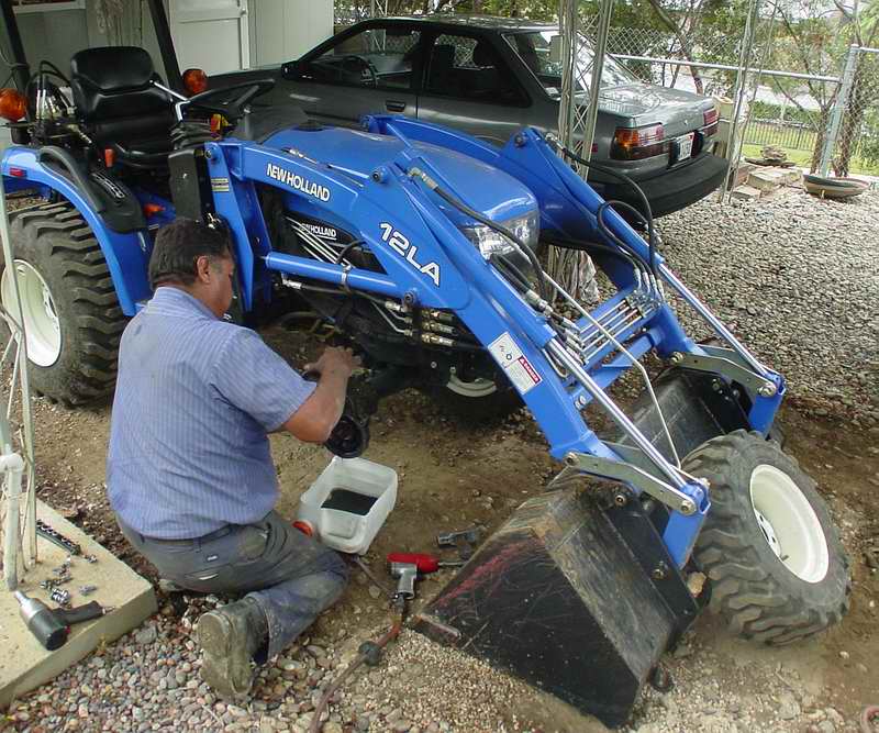

Hello everyone, well got my tractor fixed 2 days ago after 21 days waiting for a new rim for the tractor (see attachment). In addition to the rim the hub and the bolts had to be replaced as well. Everything was covered under warranty by New Holland. Apparently my incident was not an isolated one. Just 90 miles from me another TC 24D lost it front wheel except it was on the left side. New Holland management told me that the front axle assembly including the wheels had QC issues. This explains why all the bolts on the front axle were losing and fluid was leaking from the axle pumpkin at the halves.
I urge everyone to check the bolts on the their TC 24D’s in case there is another one that got away from the QC department.
Since I had to wait for so long I had to make things work so off to Home Depot I went and got some really questionable bolts that I was going to use to hold on my wheel. I was able to find some that fit the treads of the hub (only 2 were not stripped out) I also got some washers, lock washers and nuts to go with them. I then drilled out the bad holes in the hub and inserted a bolt and bingo I was back in action. I had lots of work to get done and as they say, a man has to do what a man has to do. I also moved 42 tons of heavy wet clay like dirt. Must have been the heaviest load my 54 inch bucket has ever lifted. I kept an eye one the bolts and they seemed to be holding. After the task I checked the nuts and they were starting to work loose so I tightened them and off to the next task. This time it was very light duty, just spraying weeks. I noticed the wheel was moving a little so I stopped and checked and they were loose go figure. So I guess I owe Home Depot some gratitude for keeping in business while my dealer looked for a new front wheel.
I know many out there must be horrid at my deed but solutions like that is why they don’t pay me the big bucks. It does not help that I have all these can do people around me either.
So in conclusion we have learned that one must check their nuts often /forums/images/graemlins/grin.gif, and bolts too. And where there is a will there is always a way.
George
PS: Thank you for the great advice it keep me on my toes. And the dealer was great they even sent out their best man, a really nice guy.
Oh and for who asked what kind of engineer I am. Remote Television Engineering is my gig; I keep TV on the air when there is a big event such as a Nascar Race or big trial.

Picture 2 of 2
