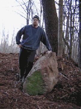

JCA -
Regarding "lightweight" - since I was primarily replacing a lawnmower ("garden tractor") - I didn't want to go "too big" (soil compaction). But I knew that I would have to - occassionally - move a big rock or two.
I've attached a pic of a rock that I pushed around with my B7610 (24 hp) - I can't pick it up - but I can move it around without *too* much difficulty. (You are looking at the rock "end on" - it's about twice as wide) That's why I went for the B7610 with the LA 352 loader.
If you're going to be *pushing rocks* / or doing heavy soil work (FEL or 3PH implements) - then heavier may be better. But if you are going to be doing generally lighter chores ("estate maintenance") - then something like my "lightweight" /forums/images/graemlins/laugh.gif B7610 is plenty tough too!
Good luck on your decision!
Dan
