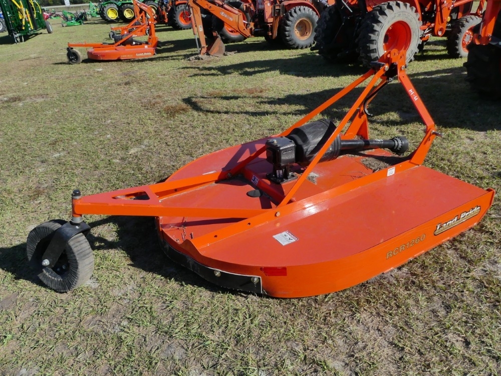

45-horsepower will adequately power a 72" medium duty Rotary Cutter / Bush Hog through tall grass.
