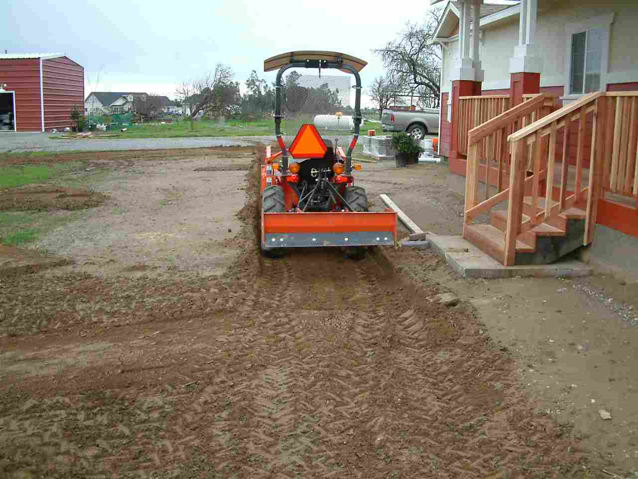

The PTO doesn't have lift capacity. YOu mean the lift capacity of the 3-point hitch (3pt). The 7800 has 1655 lb lift capacity at the ends of 3pt lower arms and 1300 lb lift 24 inches aft of the arms. This should be plenty to handle a 5-ft wide box blade, 5-ft rotary mower (brush hog), etc.
I have a B7510HST that has 1356 lb and 1058 lb at the corresponding points of its 3pt. It does just fine with 4-ft wide implements. In fact I add about 360 lb of concrete weight to my 4-ft King Kutter box blade that weighs about 250 lb to get it to bite better.
From your task list it looks like you'll need a front end loader (FEL) and possibly a backhoe for trenching. If that's the case you might want to look at something like the BX series.
My Bota has 4WD and a hydrostatic transmission. Makes FEL work a breeze.
The box blade and FEL are nice for excavating work for paver block sidewalks, etc.
