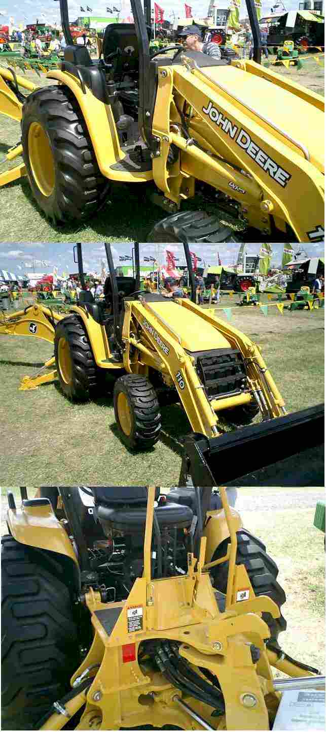

One of the nice features of the JD 110 TLB is that the backhoe is removeable. 3 PH arms can then be attached and there is a rear PTO.
OkieG
   / Tractor vs. Tractor/backhoe #9
<font color="blue"> One of the nice features of the JD 110 TLB is that the backhoe is removeable. 3 PH arms can then be attached and there is a rear PTO. </font>
Here ya go. Pictures of the 110. I'd tell you who that is peering at it, but then I'd have to... /forums/images/graemlins/grin.gif
