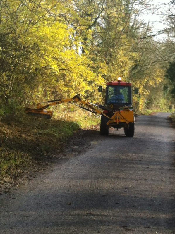

My Kubota B2410 has always been fitted with turf tyres, and around my small holding it has always been fine and never come near to getting stuck.
So last weekend I took my tractor to a 'real' farm to do some hedge cutting.
My friend said his fields were a bit boggy, and I replied with, "that doesn't matter, this thing will go anywhere"
2 hours later I was down to the axles with the phone in my hand asking for help!
So how much better are agri tread tires, coz I've heard people say that they're really good.

Ah yes, you're right, my turf tyres did just fill up and turn into completely smooth round bits.
The trouble is, my hedge cutter weighs 300kg and I've only got 45kg of front weights, so it's very heavy over the back end.
What is the maximum weight you could put on the front?
