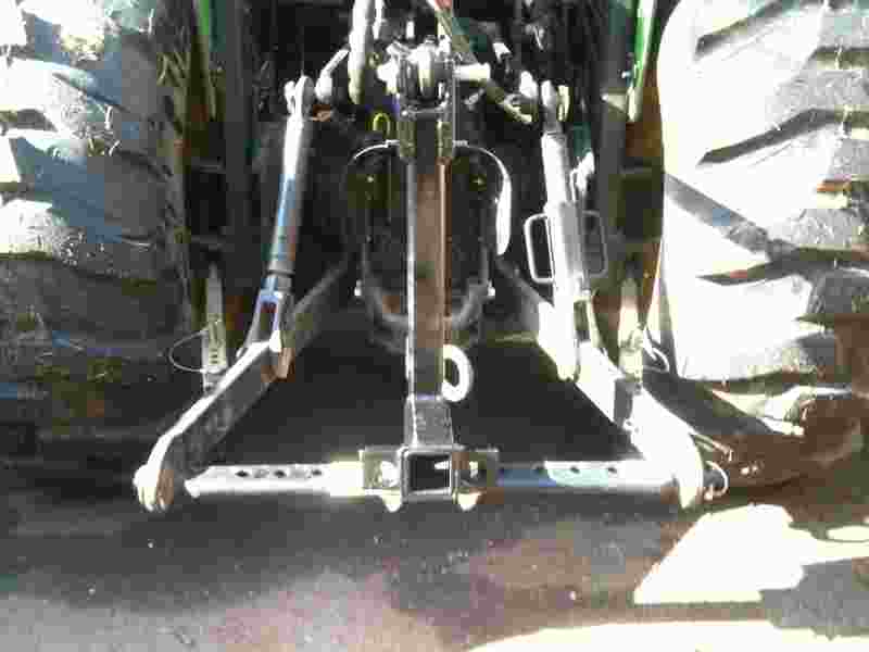

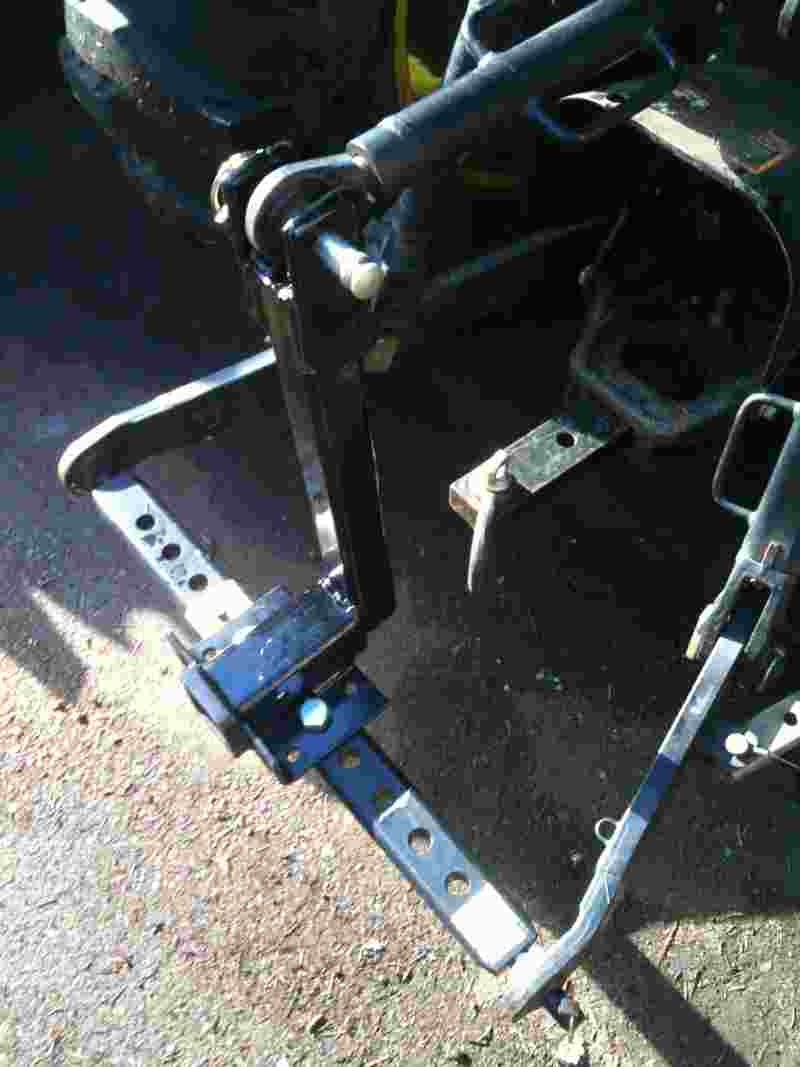

I was in need of being able to move normal ball hitch (2 5/16") trailers with my tractor (JD4720). I looked around at the quoted prices and was appalled; mid 3 figures and up. Thinking that was absolutely ridiculous I got to thinking about an alternative. Mind you this is for moving with a tractor not driving on the interstate highway.
I found a receiver tube welded on a small piece of flat plate. ($16)
Next I found a short scrap piece of 2"x2"x 0.25" wall square tubing left over from another project. Miter cut a 90 elbow to insert in the back of the receiver tube and two small pieces of 1/2" plate to make the top link connection. Mounted (3/4 inch bolts) it on the three point universal bar that I use for so many things. Had to drill two new holes in the receiver hitch plate as did not like the existing hole placement.
Welded the miter cut, welded the stub in the back of the receiver, and welded the top link plate forks on and painted. Now I can put any of my trailer hitch stingers in the tractor trailer hitch receiver and go move a trailer without hooking up the tow vehicle.
Total cost under $20. Hugh savings over the ones I found offered.

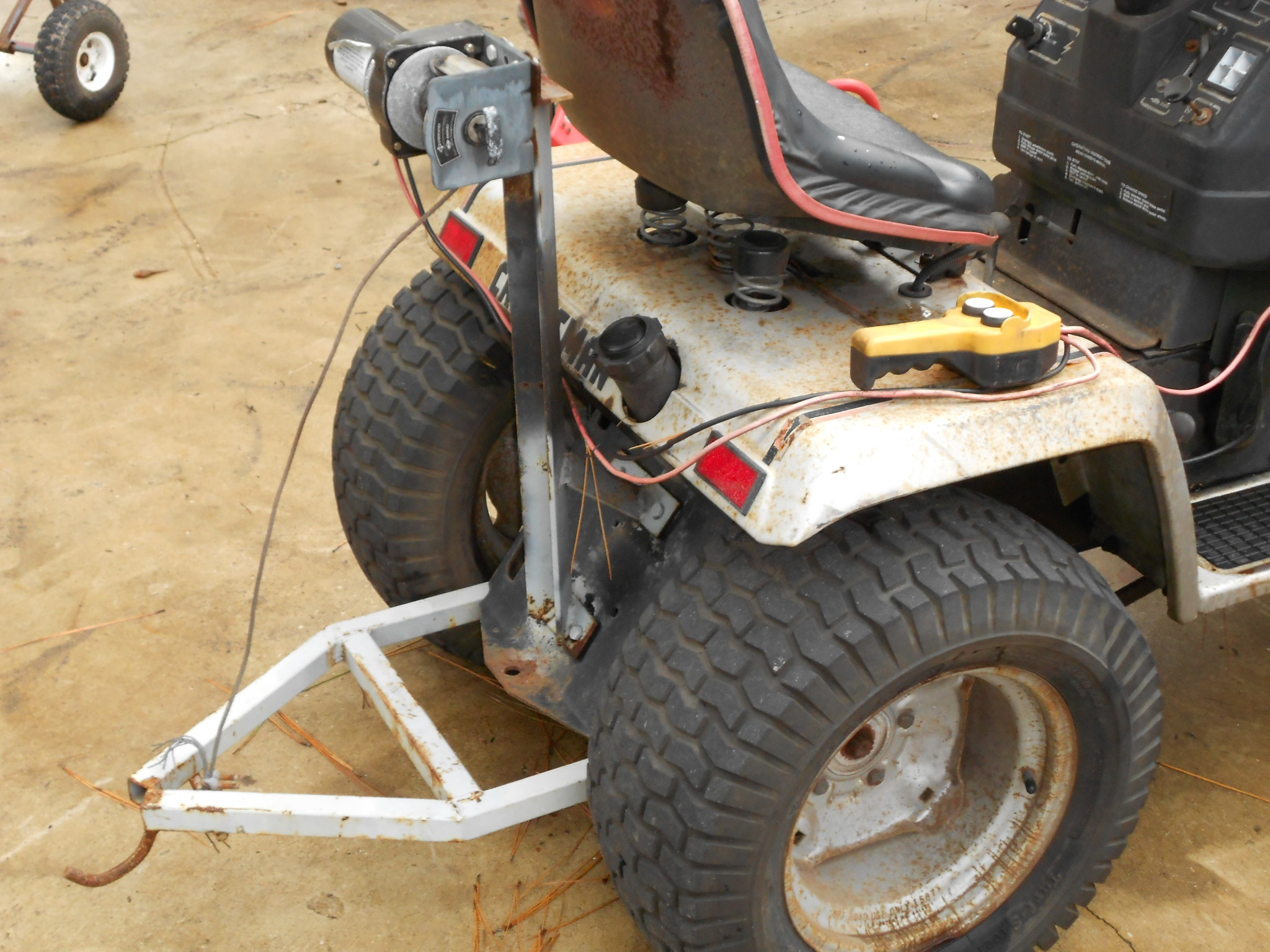

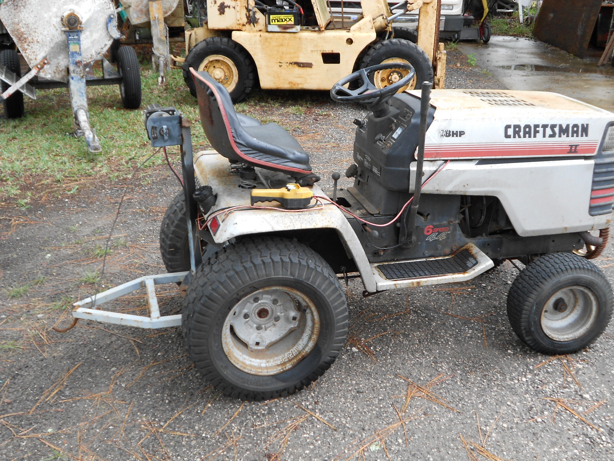

I made something similar only I just made an "L" bracket for the top link and used the regular holes for the ball.
Also here is pics of my tractor for trailer moving.
I have to move small construction equipment around, some with ball hitch and some with loop hitch.
This is what I came up with.
A neighbor set the tractor to the curb not running with a bad deck so I got it running and put on a $49.00 HF winch.
It will lift the tractor front end off the ground if the trailer is too heavy!
