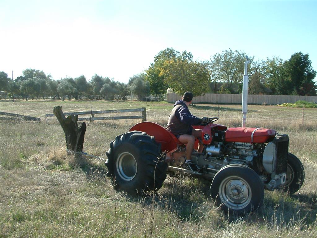

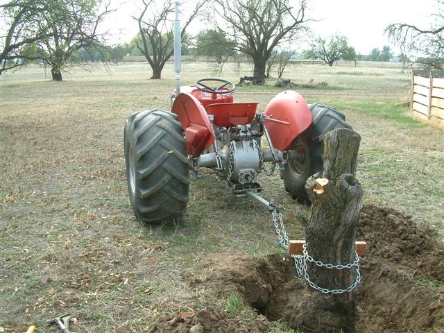

I bought this 1964 MF135 diesel tractor from an olive grower. He lowered it with those large rear wheels (16" diameter rims, 18" wide tread) and shorted the front axle spindles to keep the tractor level. Used it to disc, mow and spray his 15 acre orchard. A low cost solution to your problem.
Good luck
