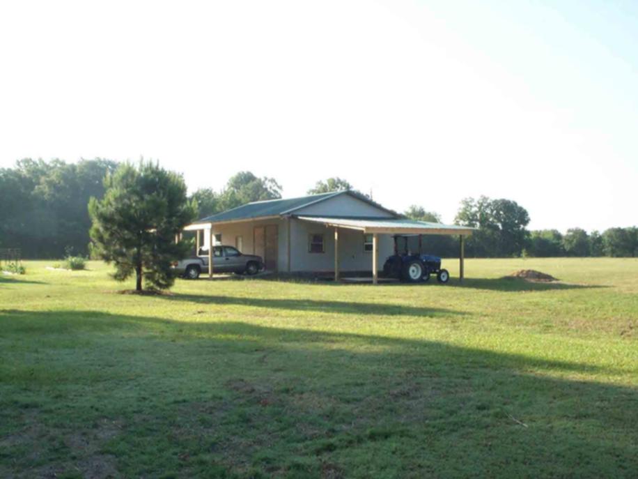

No idea where you're located, but in my area I don't need complete enclosure. Protection from sun and rain are primary and I use drop-sheds unless I need to move something into the shop to work on it. My shop is 24x40 with 10' ceilings. I have an 18'X42' drop-shed down the north side with 24'X24' drop-sheds on each end. I've decided I still don't have enough covered space and am in progress of adding a 24'X42' shed across the south side. I don't think you are likely to build too large...
