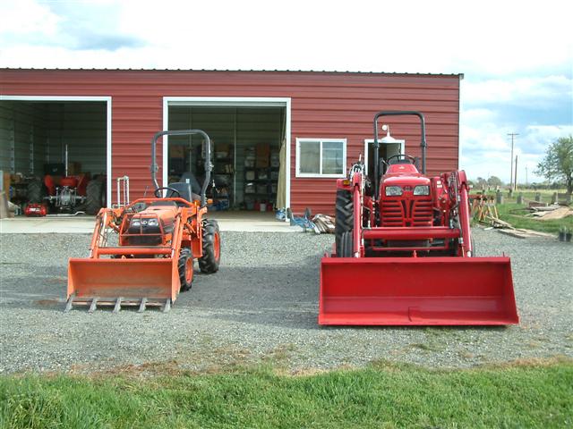

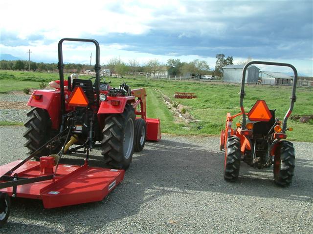

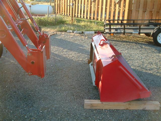

Tractor: speed=hp, so look for something like this:
45-60 hp pto, 4WD, power steering, shuttle shift gear tranny, FEL with 6-ft wide bucket. For example, my tractor is a 2008 Mahindra 5525 (54 hp engine, 45 hp pto, 2WD, power steering, gear tranny 8F/2R, triple hydraulic remote couplings) with the ML250 FEL (6-ft bucket, 2950 lb lift to 10.5 ft height, skid steer quick attach option, 3 chain hooks welded on bucket). Cost: about $19K new. Something like this would handle all your jobs with ease.
DSCF0061 (Small).JPGDSCF0062 (Small).JPGDSCF0066 (Small).JPGDSCF0067 (Small).JPGDSCF0110 (Small).JPG
The small tractor in the photos is my 2005 Kubota B7510HST (21 hp engine, 17 hp pto, 4WD, hydrostatic tranny) that I traded in as part of the 5525 deal.
Don't make the mistake of buying a tractor without the FEL. It's the single most useful implement on a tractor and generally is less expensive if bought with the tractor as part of the package.
