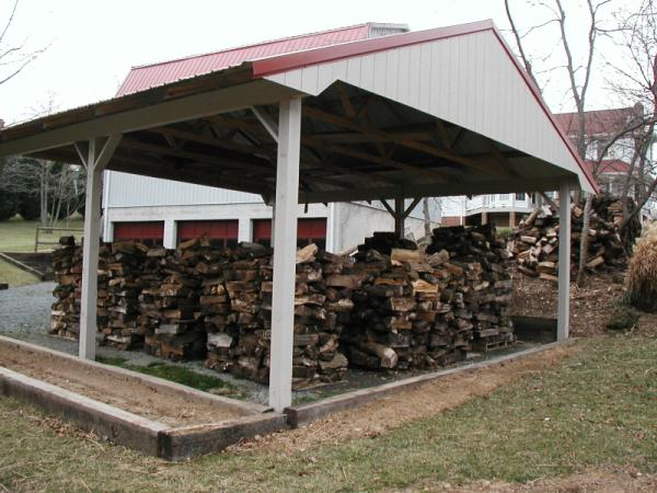

WTA, You could do something similar to what we did for protecting outside stuff... You could build it next to your garage/shop, at the height that fits your equipment ... It wouldn't look bad at all.. We call it a polevilion

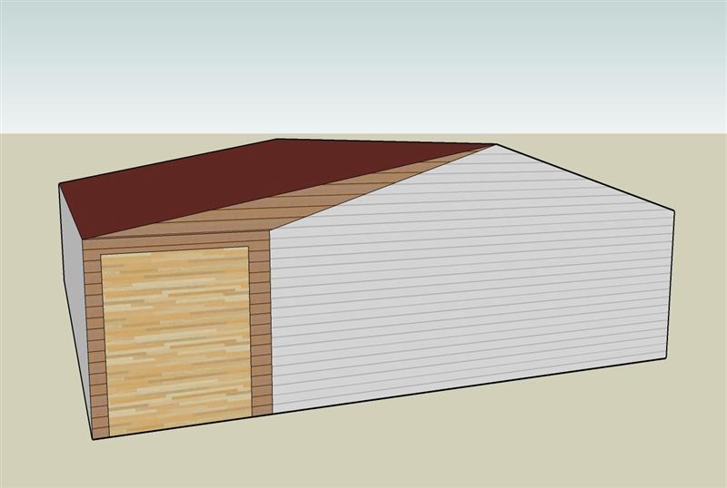

Looks like you might have to go with a separate structure. Or build a shed off the back starting at the ridge line. You can remove that part of the existing roof and reuse it on the new shed roof. With a metal roof I think you can get away with a minimum 1-12 roof pitch.
Rob
   / tractor shed #9
Rob
Maybe like this?
