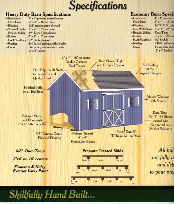

I kept my B7500 in one of what we call those "Amish Barns" for a while (till there was too much other junk there). It has a 3//4" plywood floor, and it worked fine. The reason it did was the floor is built on treated 4x4's that are pretty much spaced for the wheel tracks of the tractor. They take all the real weight. Picture laying out the 4x4's to drive on, then building a shed around them.......................chim

Maybe the attachment will help. It should give you some ideas of how the skid/floor is built.
