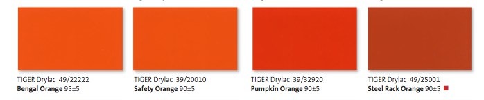

Finally, color... there are a couple of orange colors in the Tiger/Drylac powder coating catalog: Bengal Orange, Safety Orange, Pumpkin Orange, and Steel Rack Orange. Bengal and Safety Orange look pretty similar as a bright orange, Pumpkin Orange has a reddish tint, and Steel Rack Orange has a darker look. I'm thinking that Steel Rack Orange has the most original look, but I'd be interested to hear opinions.
