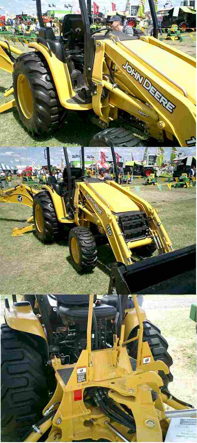

What do you think of the JD 110 tlb. I have seen some slightly used in the mid $30k range?
   / Tractor question from a future buyer #6
I've never driven one, but I hear they are great.
   / Tractor question from a future buyer #7
I saw one at the Empire Farm Days a few years ago. Very nice piece of equipment if your tasks run more towards things better suited to a TLB, which yours seem to.
   / Tractor question from a future buyer #8
After you're finished with most of the heavy work, you may not be happy having just a TLB unless you can easily remove the backhoe and put on a cutter and other implements like a boxblade. Check out tractors you think you will be interested in, and then check out a Kioti DK35 or DK45 with a backhoe and a loader. I think you will find a lot of extras included in the sale price instead of added on as with many other brands. These are very capable tractors that should do all you want to do and more. Make sure when you compare, you compare an equal tractor. Basically the same HP, lift capacity, weight, etc. Not different class tractors, or you won't really see the deal. If you read the Kioti forums, you'll find some very happy DK35/45 owners, DK35Vince in particular, who have done a lot of grading, digging, etc. both of these tractors, with loader and backhoe will be well within your budget. My dealer had a Kioti DK45 with a Woods loader and Woods Backhoe recently on his lot for around $26,000. It was a sharp setup. John
   / Tractor question from a future buyer #9
The nice thing about the 110 is that it's got a 3ph and the backhoe is removable.
BTW, there's a well known TBNer in the first picture. /forums/images/graemlins/cool.gif
   / Tractor question from a future buyer #10
</font><font color="blue" class="small">( The nice thing about the 110 is that it's got a 3ph and the backhoe is removable. )</font>
That would be good then. So many other jobs will come up and the 3pt will be important. I was sort of under the impression that the 110 was rather dedicated. Thanks for the info. Is that you Mike? John
