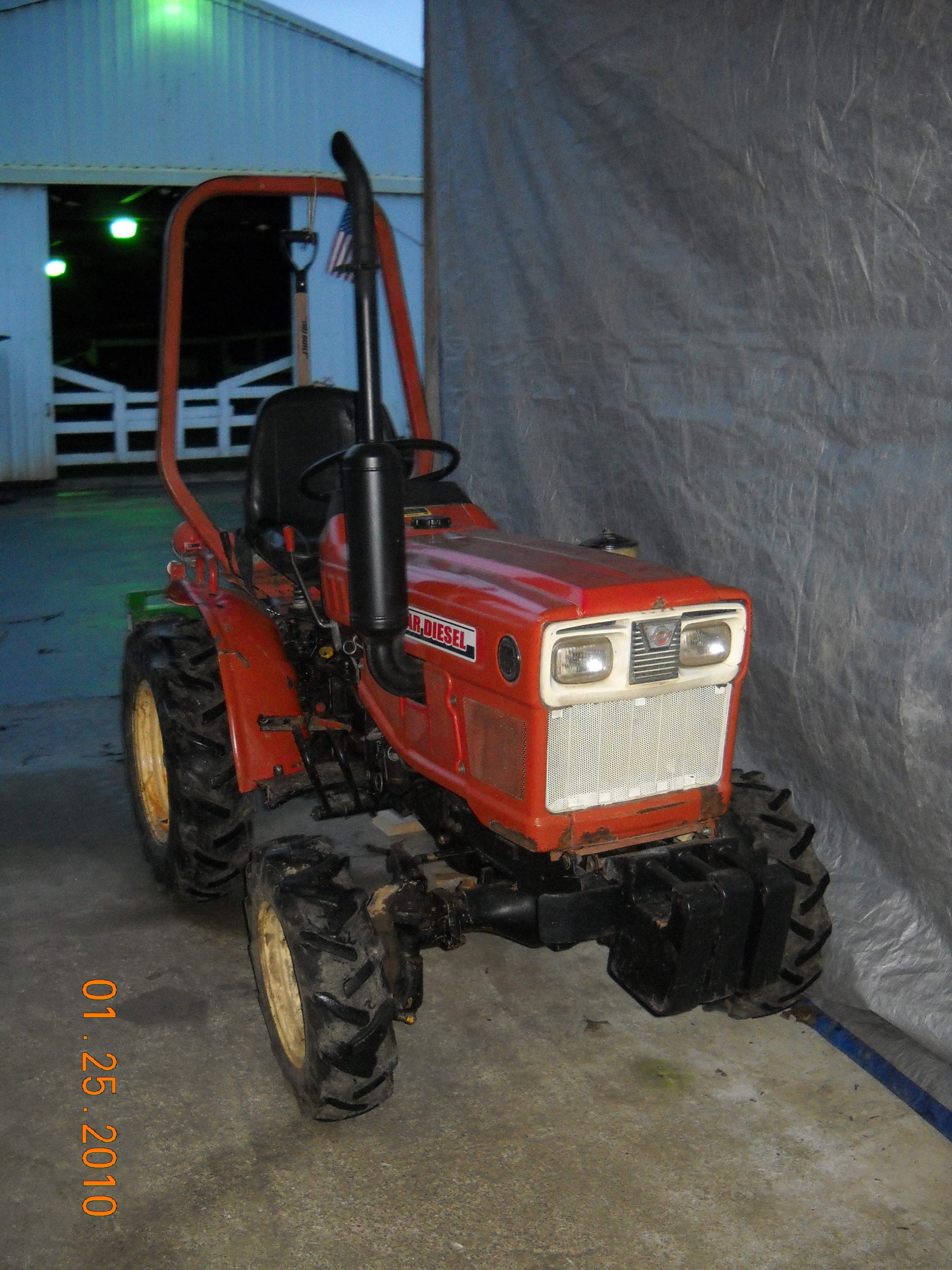

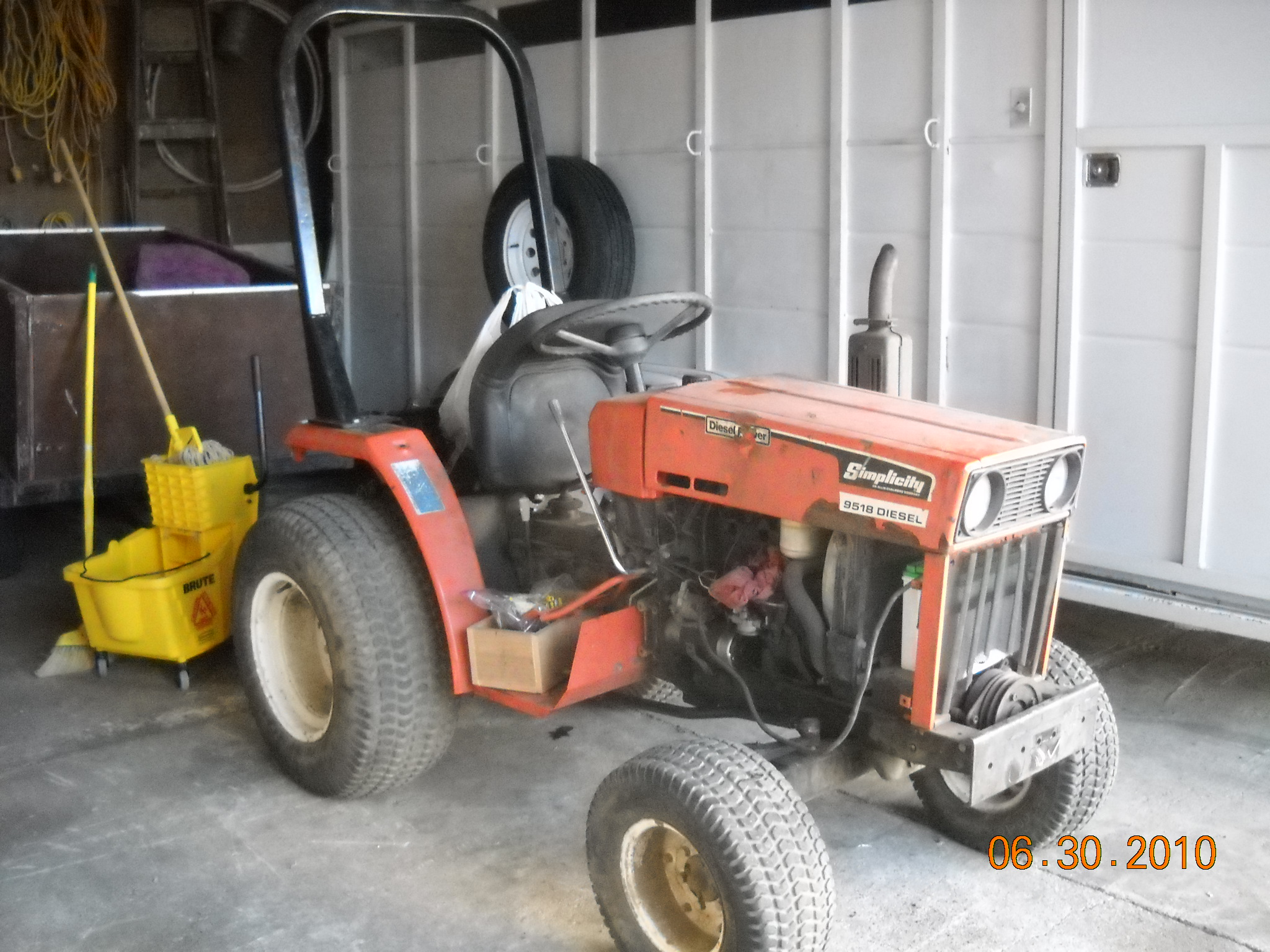

   / Tractor Purchase Advice.... 5015 or YM186D #5
There are actually 4 versions of the AC, the 5015 AC, Simplicity 9518, (i own one:D), Massey Ferguson 1010, and Hinomoto C174. These are all the same tractors but Massey Ferguson has the best parts availability. The thing about the 5015 is...
1. it is 2wd
2. 3 point doesnt work
3. operator station is more cramped than the Yanmar (I know since I have both of them)
4. the 5015 does not have a fuel guage, just a dummy light
The Yanmar is really a good tractor and the 4wd is a definate plus. I cant even back my Yanmar on the trailer in 2wd unless i used high gear which is very dangerous. I understand that the fact that it is close definatly makes you want it but if you really plan on working efectively in the snow and wet or muddy ground, you will want the yanmar? Do either of these tractors have ROPS (roll bars)? I am very into safty on my tractors and luckly my yanmar has factory ROPS and i was able to add ROPS to my simplicity. IMO, try the Yanmar out, it is more roomy, has 4wd, and has more weight = more traction in the snow. This is coming from someone who has both tractors.
The Yanmar has...
1. 4wd
2. working 3 point
3. more roomy operator station
4. fuel guage
I have to say though, what ever you do, dont get both, the two different H pattern shifters are definatly confusing!:D
And, whichever tractor you choose, post pics!:thumbsup:
