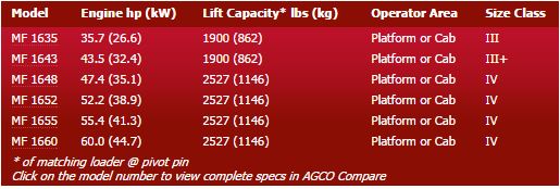

I know what a Cat2 three point is, but what is a category 2 tractor and why is this confusing nomenclature introduced rather than focusing on PTO power and three point category?
Moreover, your post hole diggers are not quick hitch compatible. Do you know if a QH compatible post hole digger exists?
Thanks.
   / !!! Tractor Post Hole Digger with the Best Value & Complete Video Tutorial !!!
Re: !!! Tractor Post Hole Digger with the Best Value & Complete Video Tutorial !!!
Thanks.
Ted touches on the differences in tractor classes in the video.
The little Bobcat in the video is a Class 1 compact.
The class, referring more to the frame size, goes beyond PTO power and 3point category.
I do not know of a QH compatible PHD because the boom connects directly to the toplink housing on the tractor.
Travis
As a reference, here are a couple of charts from the Massey Ferguson website showing the frame classification of their 1500 and 1600 series tractors:
