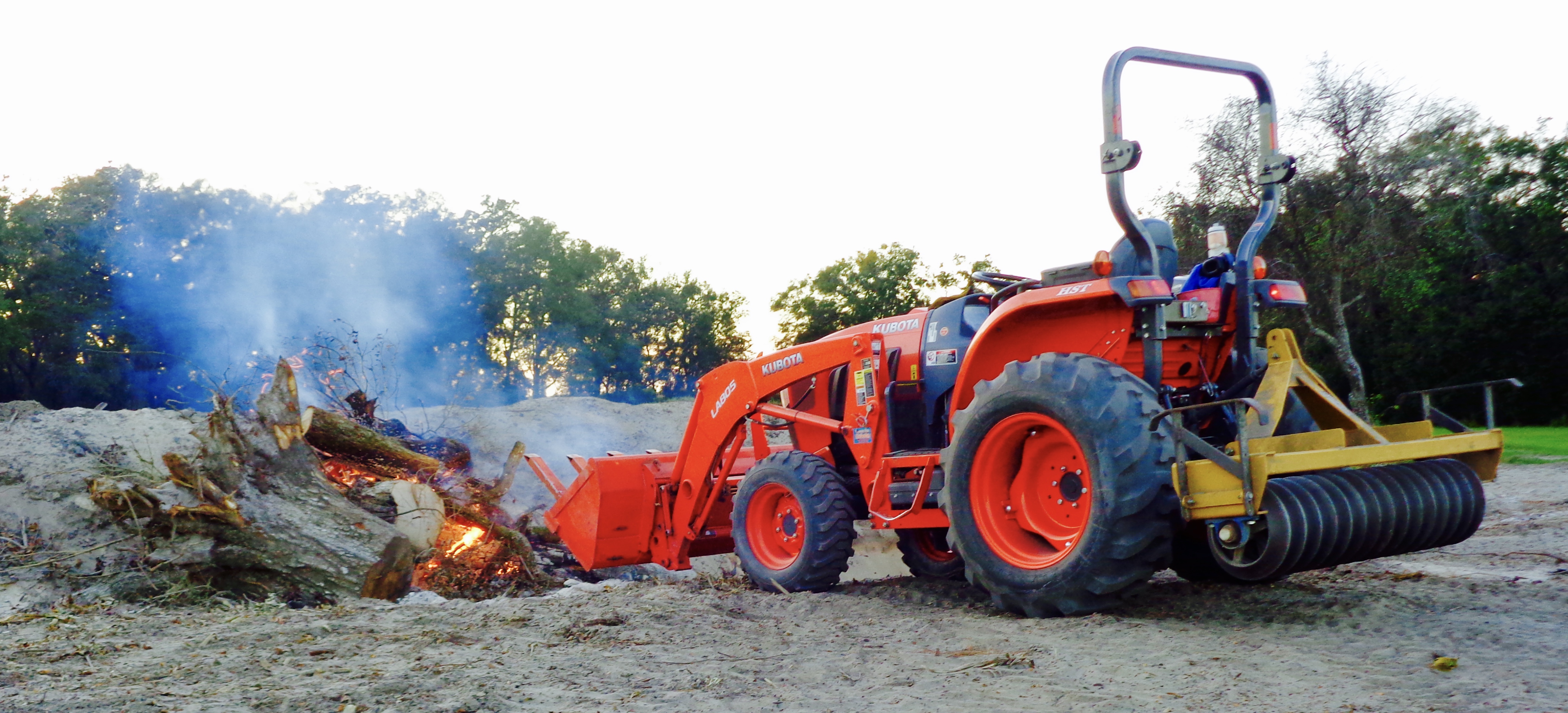

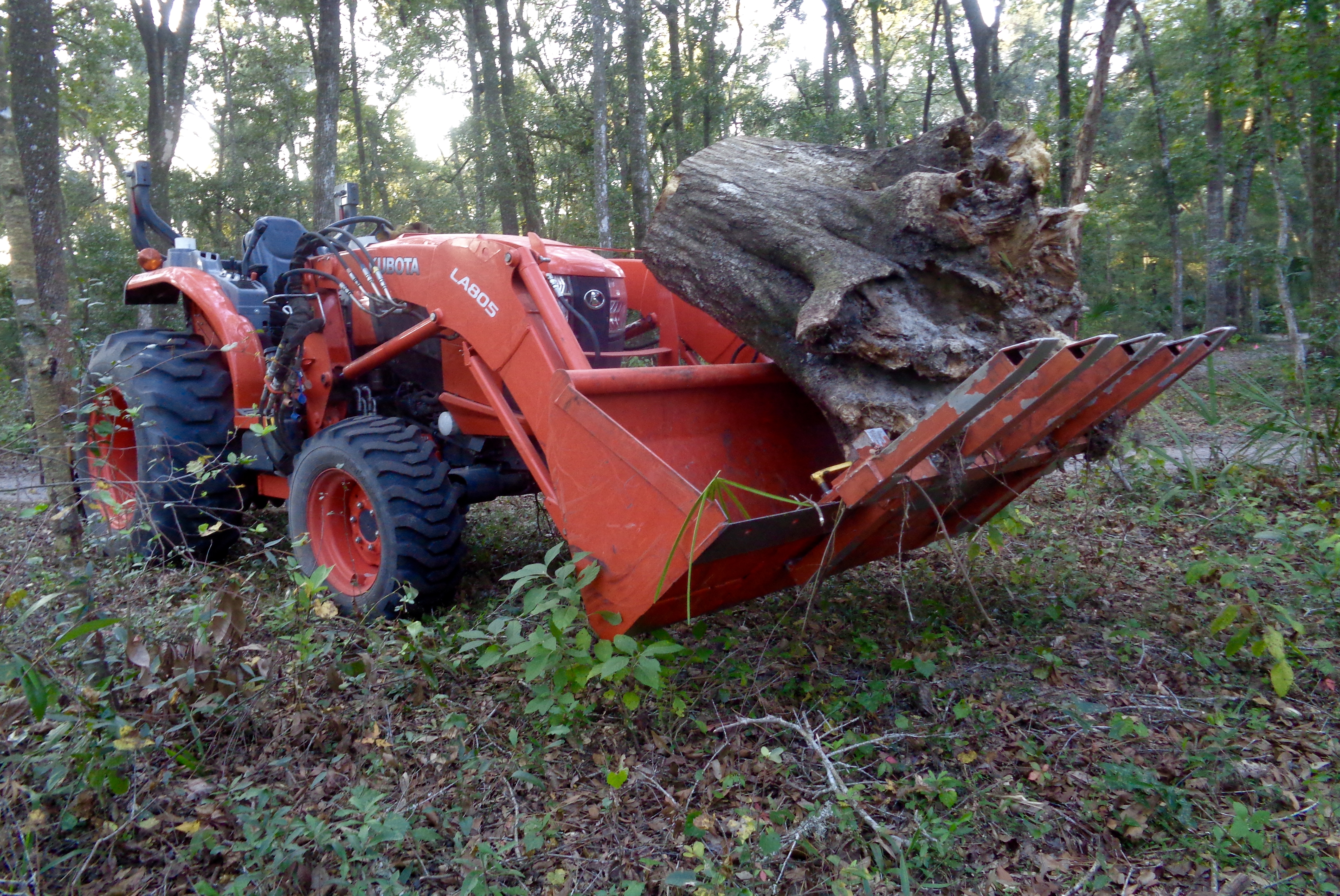

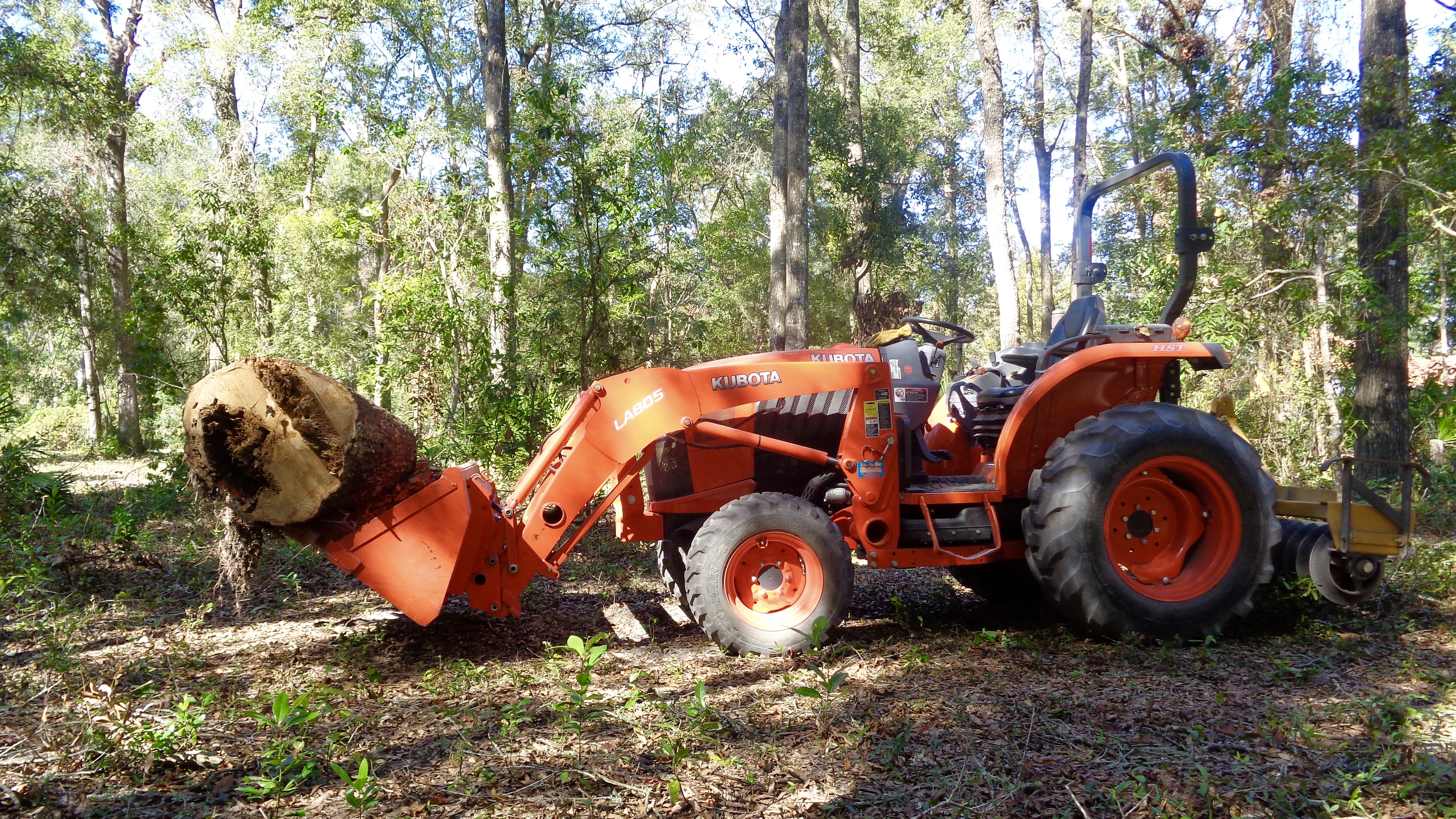

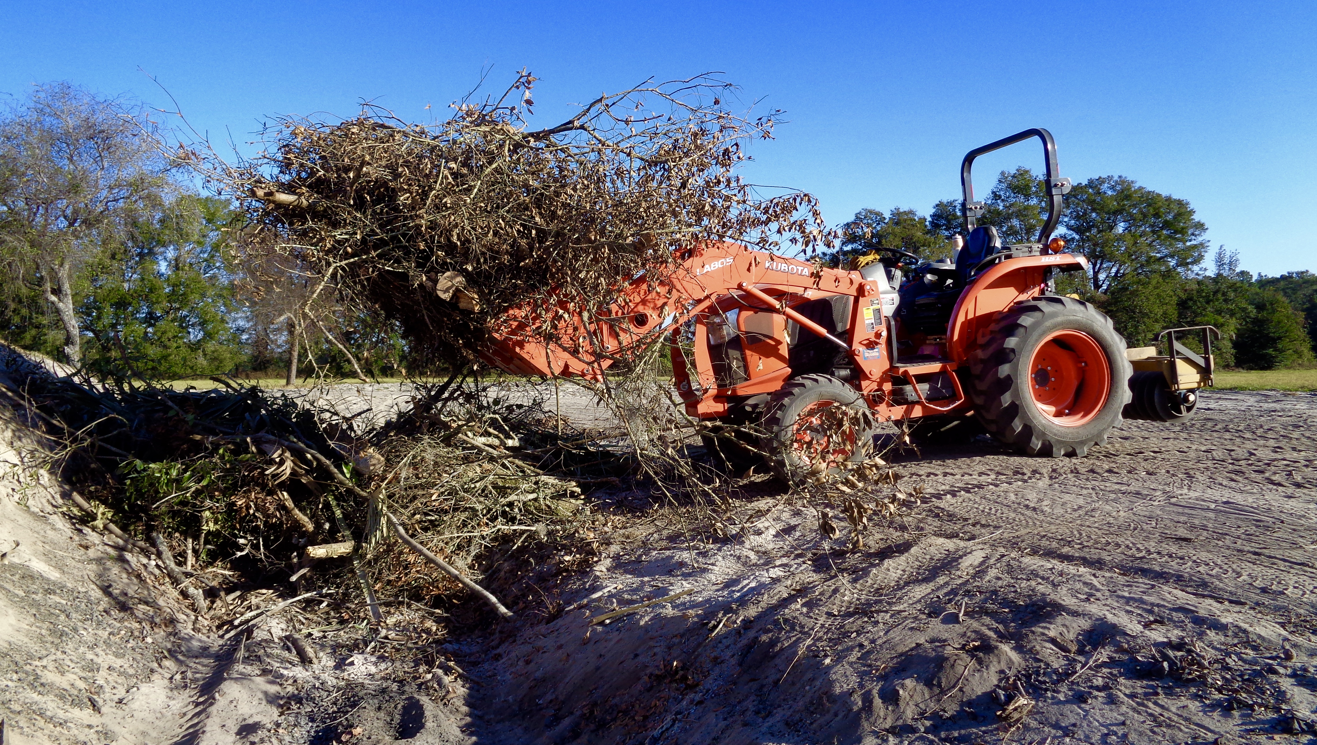

My wife and I recent purchased 33 acres in NW Ohio. 29 acres of woods and 4 acres of open field (mowed). Our plan, within the next two years, build a new home, larger outbuilding and 1100+ foot gravel driveway.
In the meantime, I need a tractor for land maintenance (cutting trails, moving downed trees, moving brush, setting fence posts, mowing.
I am new to tractors and hydraulic systems. However, I am mechanically inclined and plan to perform the routine maintenance on my equipment. I have been reading the forums for the past several months and I have learned a great deal... but I am looking to gain more knowledge from TBN members.
Thanks in advance for advice!

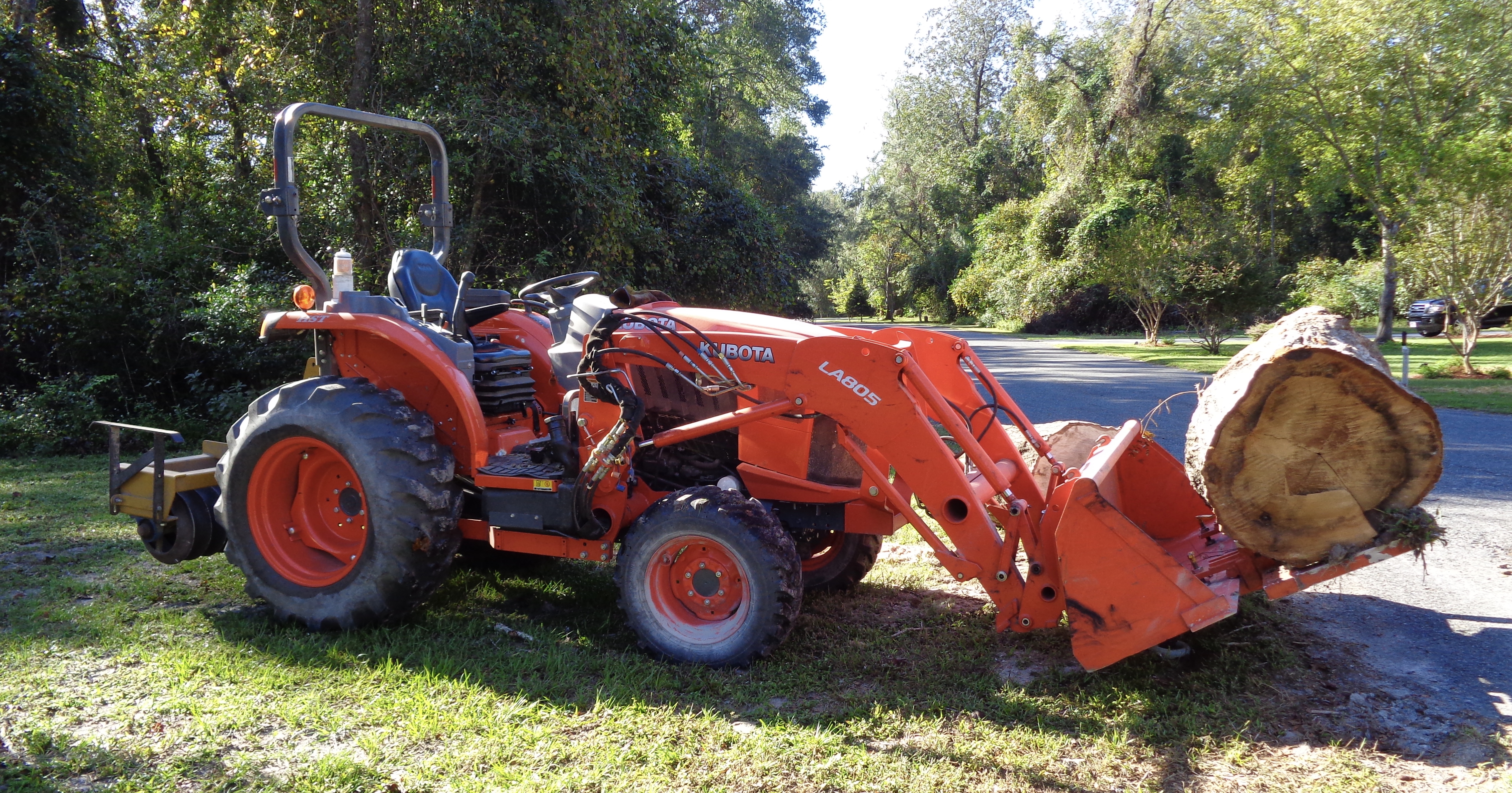

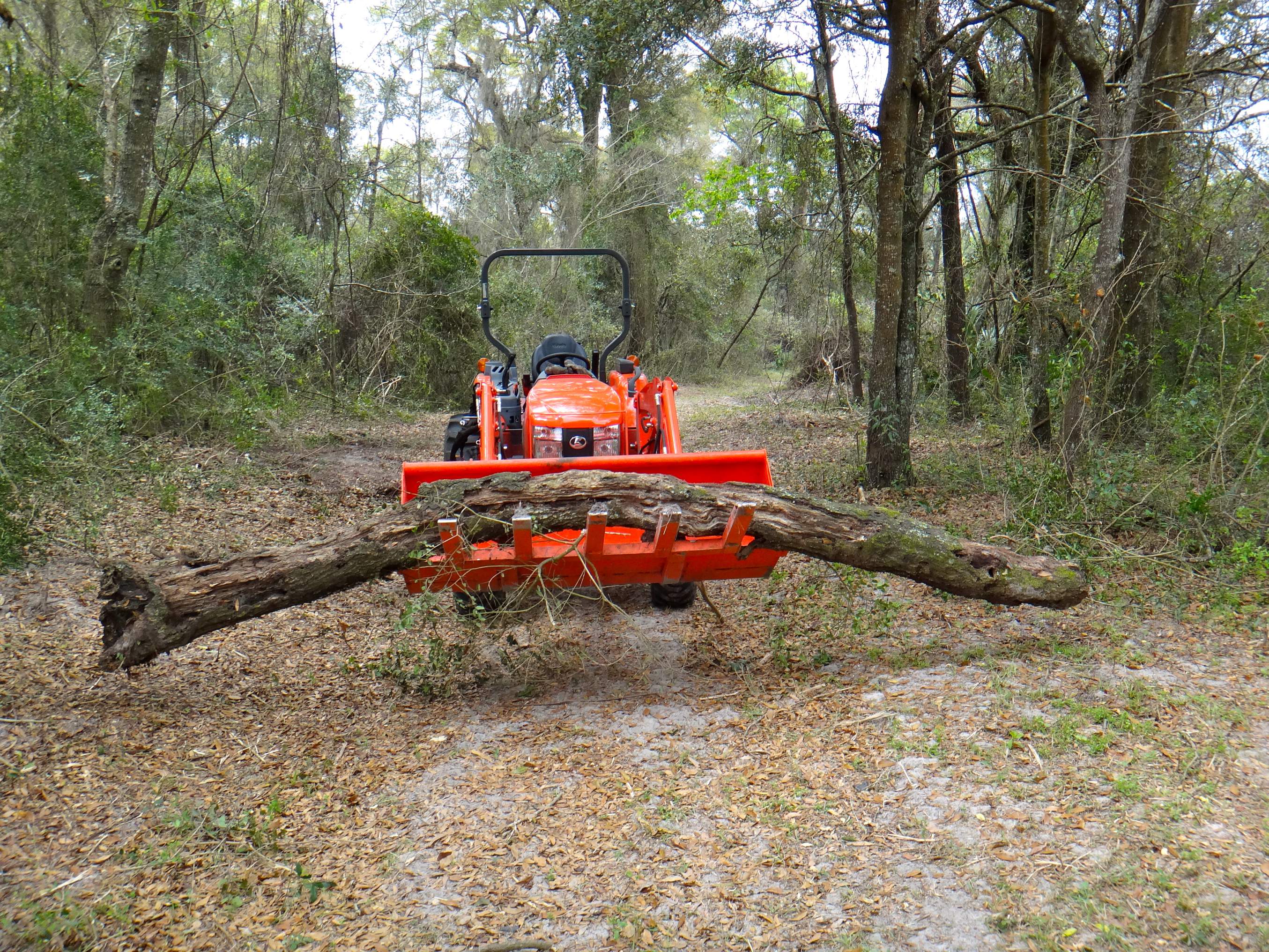

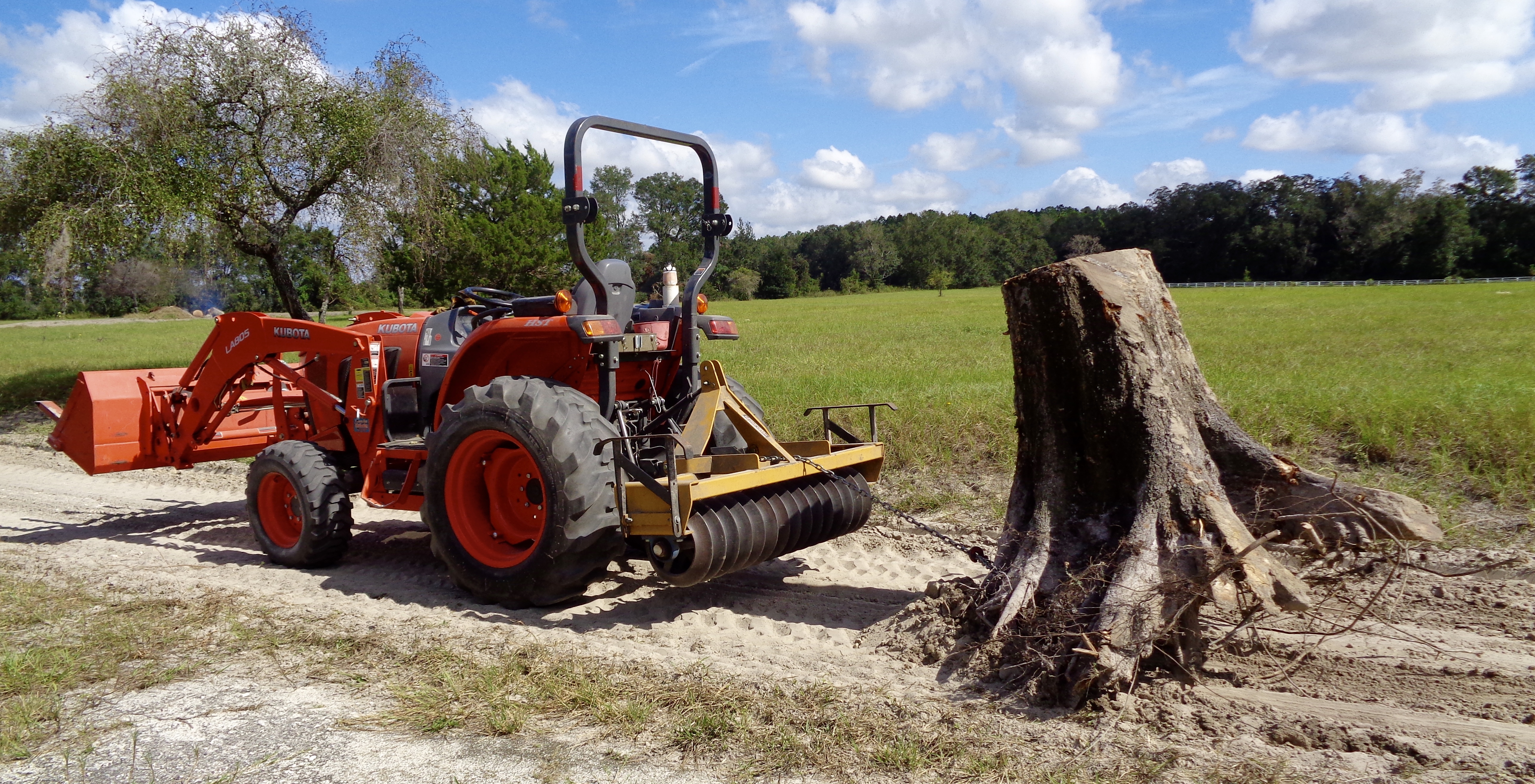

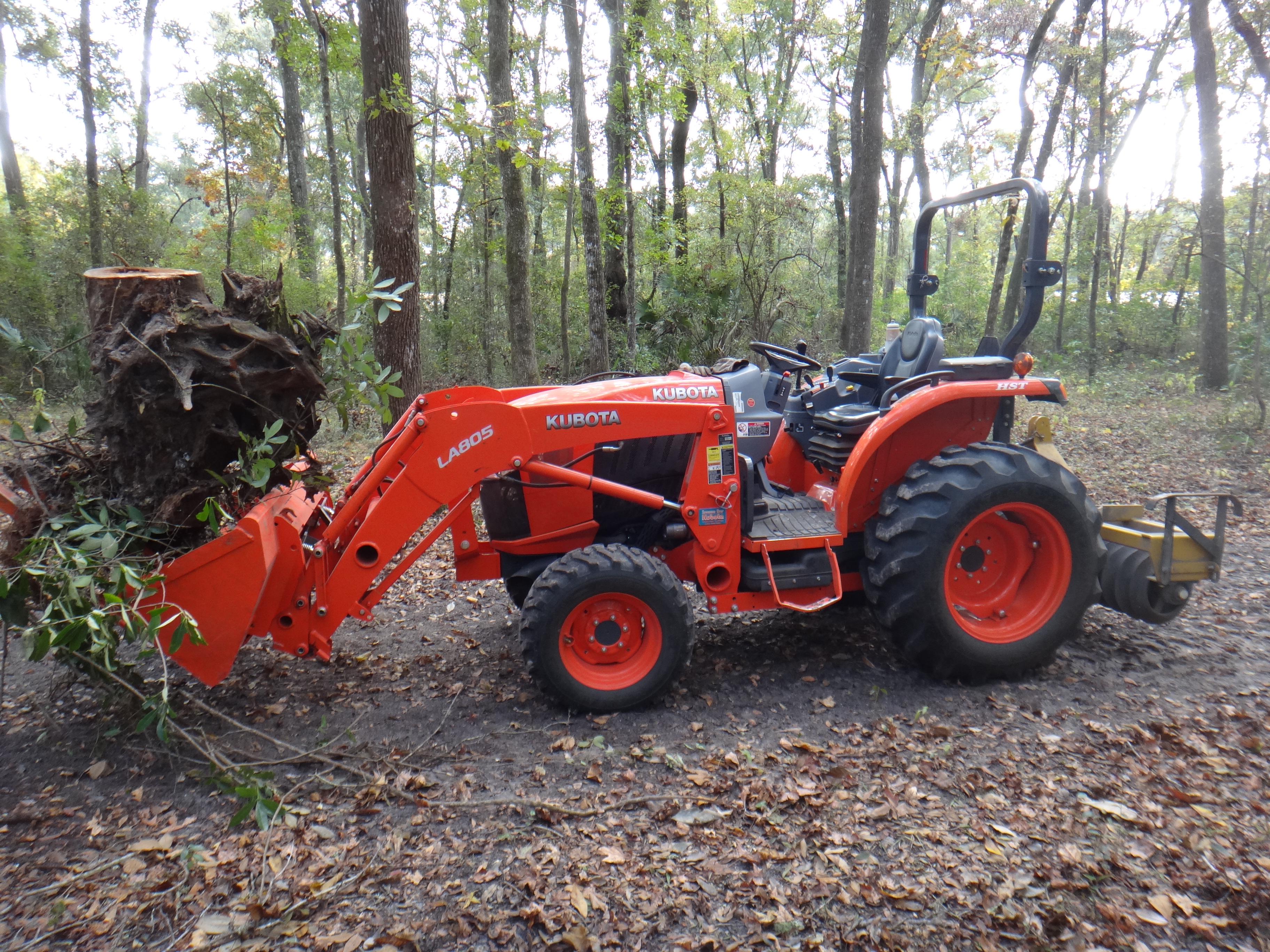

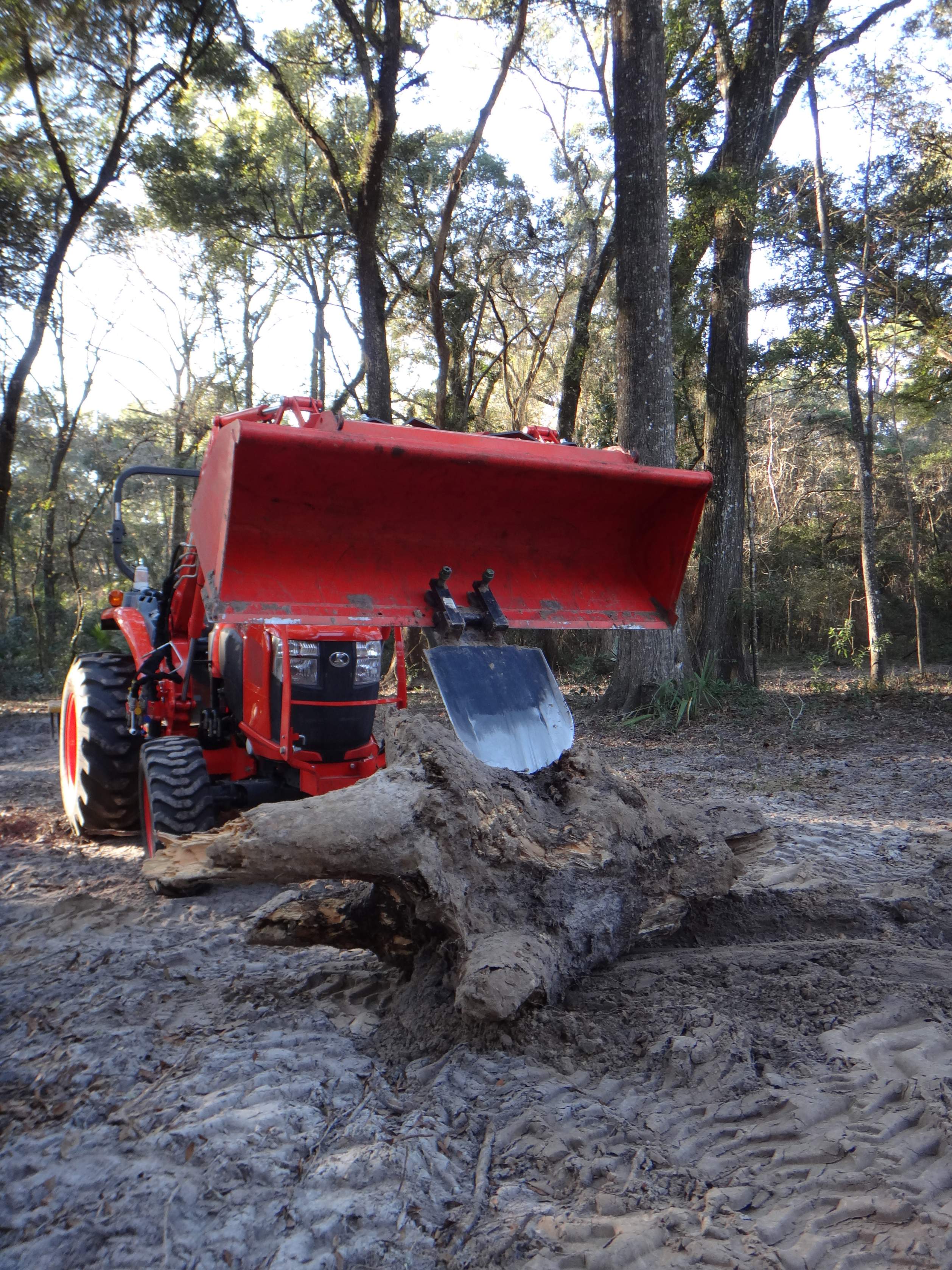

You have not mentioned if your property is flat or sloped -- a key factor. What about snow moving?
Your tractor need is for ground contact work on four acres plus 1,100 foot gravel driveway, plus twenty-nine acres woods work.
If your land is flat I believe a 2,300 pound to 3,000 pound bare weight tractor will serve well. All have at least 12" of ground clearance, essential for woods work. Every tractor brand includes tractor models in this weight range.
In Kubota's line, the only tractor line I am knowledgable about, that would be the full featured B2650/B3350 @ 2,400 (+/-) pounds or the more sparely equipped L2501/L3301 @ 2,700 (+/-) pounds.
If you will operate on hillsides consider an increment heavier, the (bare tractor) 3,500 pound L3560. This model is the lightest of Kubota's heavy-chassis 'Grand L' tractors. Rear wheel width is adjustable from 47" to 58" wide, a huge variable.
The L3560 is available with LA805 Loader with 1,700+ pounds lift capacity @ $27,000, pre sales tax. I have L3560/LA805 setup, which I use in woods work, and it is the berries. For heavy loader lifts you need Three Point Hitch counterbalance. With the LA805 FEL I typically mount either a 600 pound Cultipacker or a 900 pound TR3 Rake as Three Point Hitch counterbalance.
Plan your outbuilding with a door tall enough for the tractor to enter/exit WITH THE ROPS UP.
I have to fold my ROPS. It is a dangerous temptation to leave the ROPS down when I exit garage intending short duration tasks.
BUY ENOUGH TRACTOR.​
