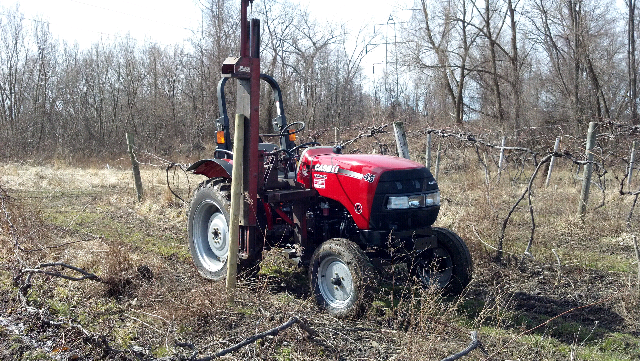

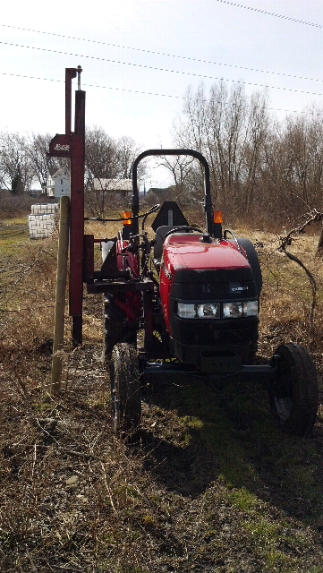

Around here we can usually find used post pounders for around $150. Nothing wrong with them, just old. We mount them in the middle of the tractor as it is easier in the vineyards to have attachments mounted there. The hardest part is adapting the mount to each tractor. Here is mine mounted on a Farmall 45A. Originally this pounder was mounted on a Ford 3910. I also had another pounder that was off a Ford 640 that came to me when I bought all the equipment from another farm. Sold it for $300. So if this style will work for you it may be an option to start looking at some vineyard areas in Europe and see what is available there used. If nothing else an auger would be a good option.
As for your idea, if you have very soft ground you can push a thin post into the ground but around here you won't be able to do anything more then a steel t-post. A 4" round wood post wouldn't even sink very much at all and definitely not enough to hold itself up on its own. ForumRunner_20120310_115731.pngForumRunner_20120310_115650.png
