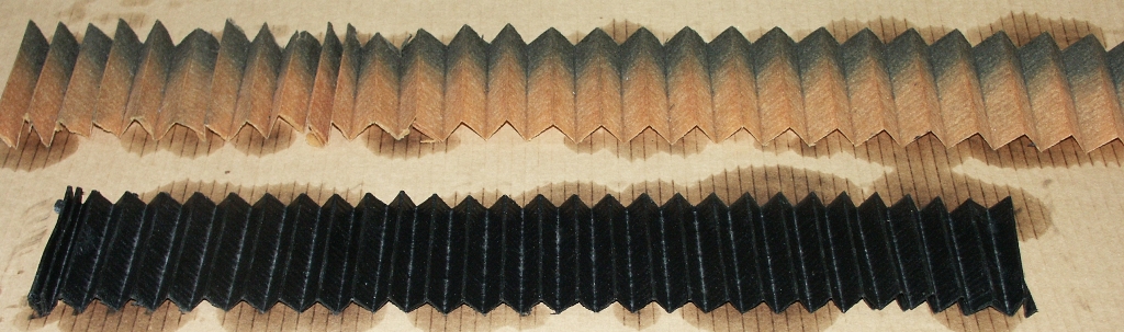

You say you cleaned out your filter bowl, but did you not change the filter? Here is a picture of the filter media from a 2 filter system. The machine had symptoms similar to yours, taken a few years back, Minnesota in January. Examples of probably the worst elements can look like after encoutering gelled diesel (in this case 2% bio per Minnesota law - hey, MN is a farm state and one way to support the farmer is to burn their crops in our engines).

Ditto on the filter change. Once a filter gets plugged by gelled fuel it takes a lot of heat to 'melt' it out.
