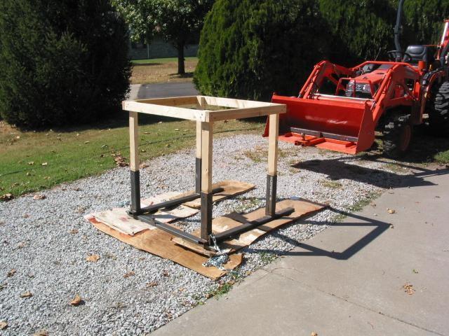

   / Tractor loader for scaffold? #4
I'm looking now for a thread that showed a setup I want to build. I don't think I'd be happy with the clamp on forks. I have a QA with forks. But the setup I'm trying to find was built for bucket use. These are the only two pictures I have I hope they help.

   / Tractor loader for scaffold? #6
My JD TLB 110 has a mechanical lock which can be used to prevent the FEL from lowering in the event of a hydraulic leak or failure.
While this is provided because the only way to get under the hood without climbing around in the bucket is to raise the bucket, it is effective and something similar might make your proposal more sane.
Of course, the JD lock does nothing to prevent curl/uncurl but take a look at the JD system and see what you could adapt. I bet you could provide a safety lock for both actions.

   / Tractor loader for scaffold? #10
To be on the safe side if a pressure hose should brake, you could install safety valves on the cylinders that locks the oil in the cylinders if a hose brakes. With these valves you need oil pressure to get the loader down.
