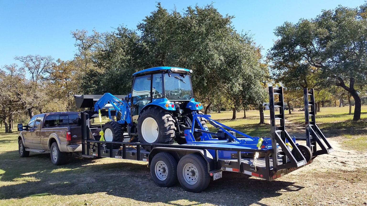

Looking at pulling the trigger on buying the new tractor and wonder if anyone know the full length of a XR4155HC with loader and 6' Brush cutter. I want to be sure it will fit on a 18' or 20' bumper pull trailer that I plan on borrowing before I buy and Gooseneck. Also will be getting a box blade and posthole digger with 9" auger. Thanks for the help

Including the loader and brush cutter I think the minimum trailer deck length would be 20'.
I have a smaller XR3037HC. With loader and brush cutter the tail wheel was right at the back of the 20'er so had no room fore or aft to balance the load. My 20'er was also only a 7K trailer so it was a few hundred lbs. overloaded. I sold that trailer and bought a 14K 22' PJ TF model. Now have plenty of room plus can move forward or back to balance the load better.

My present gooseneck is 18’ + 2’ dovetail.
Here’s my XR 4046HC with FEL and 6’ Woods Brush Bull cutter.
