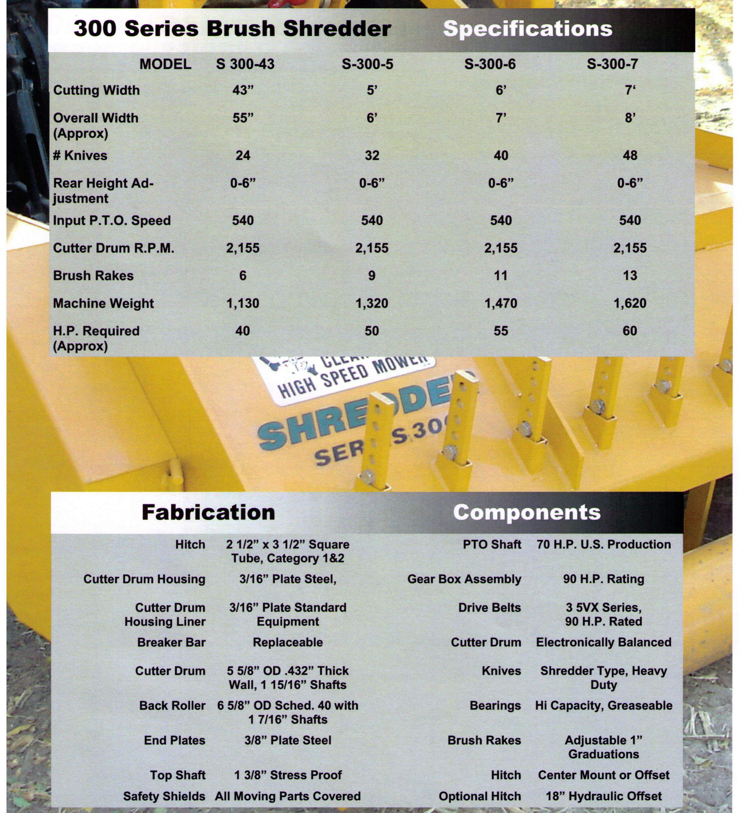

By this MFG. I think you maybe biting off more than the tractor can chew up.
Heavy Duty Brush Cutting Tractor Mounted /Tow Behind Flail Mowers
