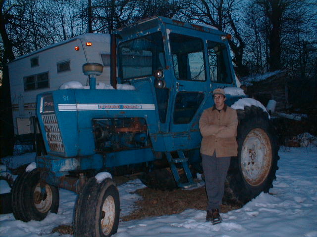

yep i cant agree more with ya soundguy on the cheap prices of big tractors,i had been looking for a while to find a 45-65 hp tractor and wasnt having too much luck finding anything decent for a reasonable price, i ended up picking up a ford 8000 with 6500 hrs for $4000. it is a big tractor and it would be hard to use for all purposes,but we already have 2 ford NAAs and a ford 3400 to use for the small work, i wanted something with live pto and heavier 3pt so this tractor worked out great, the rear tires were like brand new, the only thing i had to do was put on new brakes,which was about 700 bucks worth of parts,they are wet brakes so they should last for another 5000 hrs or so. i love having a heated cab too!

yea there is somethin great about going up the street taking up the entire lane while riding on tires as tall as most suvs,and all this comes with a sound that lets people know your coming long before ya get there,that 401 cubic inch six cylinder diesel realy sounds nice wound up to 2400 rpm.
