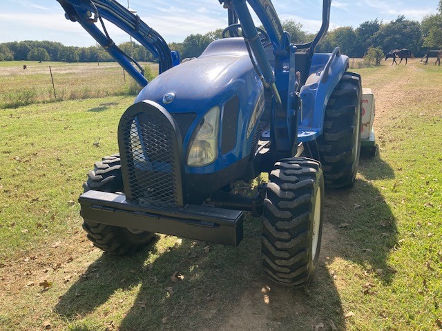

Evening folks, I cut this tubing many years ago for another tractor but finally got around to building it out. It was all made with scrap pieces.

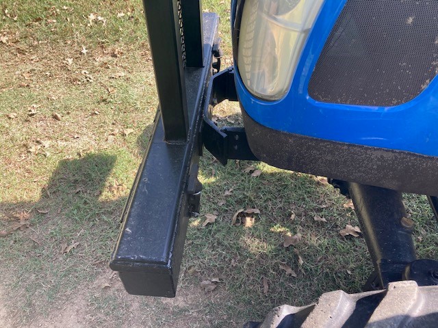

The bumper/box is 4X6 tube. I welded ends on then cut lengthwise. After the top was off I welded a drip edge on and added the grill guard. bumper.jpg

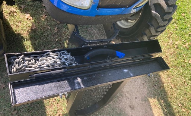

I used Jeep hood type latches and put the hinge in front so when something hits the grill it pushes it closed.bumper2.jpg
The storage part. My rollbar is filled with chain I can't get out. Nice to have a place for some chain and a few tools.bumper3.jpg

That makes a nice rugged water proof box for your chains and a novel idea :thumbsup: That bent tubing grill looks pretty slick too.

That’s unique and useful. Might have done two lids and solid center. Could open when loader is down also. Maybe having the guard fold forward gives you needed engine access? Looks good and adds good protection. Careful working under loader without a brace.

Gordon, I lucked into that bent square tube. It was a weight rack at an athletic complex they were throwing out.
