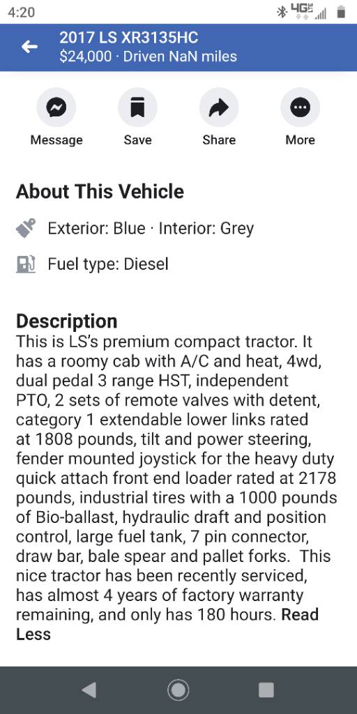

Hi everyone,
These 2 tractors are for sale near me. We have a big problem with drifting snow on our place. I would like a front mounted PTO snowblower on a tractor some day.
I'm a total noob, never owned a tractor before. Any thoughts on these 2 for my needs?
Generally speaking for a PTO blower would a 50 hp tractor be better than a 35 horse?
Thanks for the help

Front mounted snowblowers are nice, but they are tractor specific and require a mid-PTO which not all tractors have. You will have to do a little more research to see if those tractors have mid-PTO and if a snowblower is available. 35 HP should be plenty to run a 6 foot blower or even a 7 foot.

Generally speaking, yes a 50 horse tractor will always be better than a 35 horse tractor.
Always.
The question really becomes will a 35 horse tractor work?
Usually it will. As long as you size the attachments to the tractor.

I would look at the Kubota if those are your two options. Not knowing where you live or how large of an area you have to clear I don't have much more to add.
The larger tractor is larger not just in HP, but weight which helps control the snow load. I would avoid a loader mounted blower for tractors. On skid steers they are fine. I need my FEL in the winter and don't want to deal with swiping out the units.
I just went from a L4240 to a M7060. What a difference in moving dirt and I cannot wait to try it with snow. I think the 50HP would definitely be the ticket here. I hear a lot of good things on the board about LS so I am not bad mouthing brand, just recommending larger.
