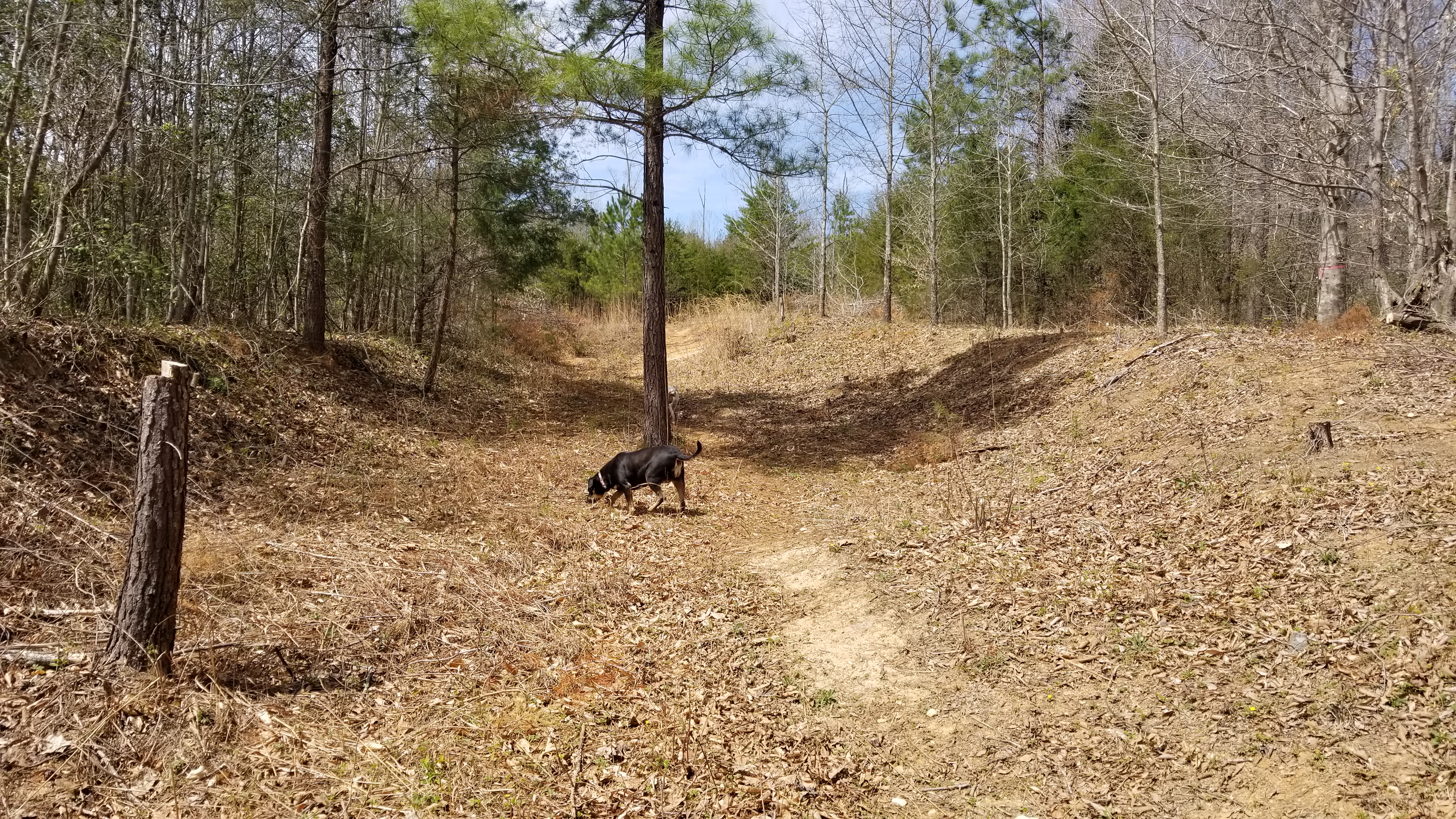

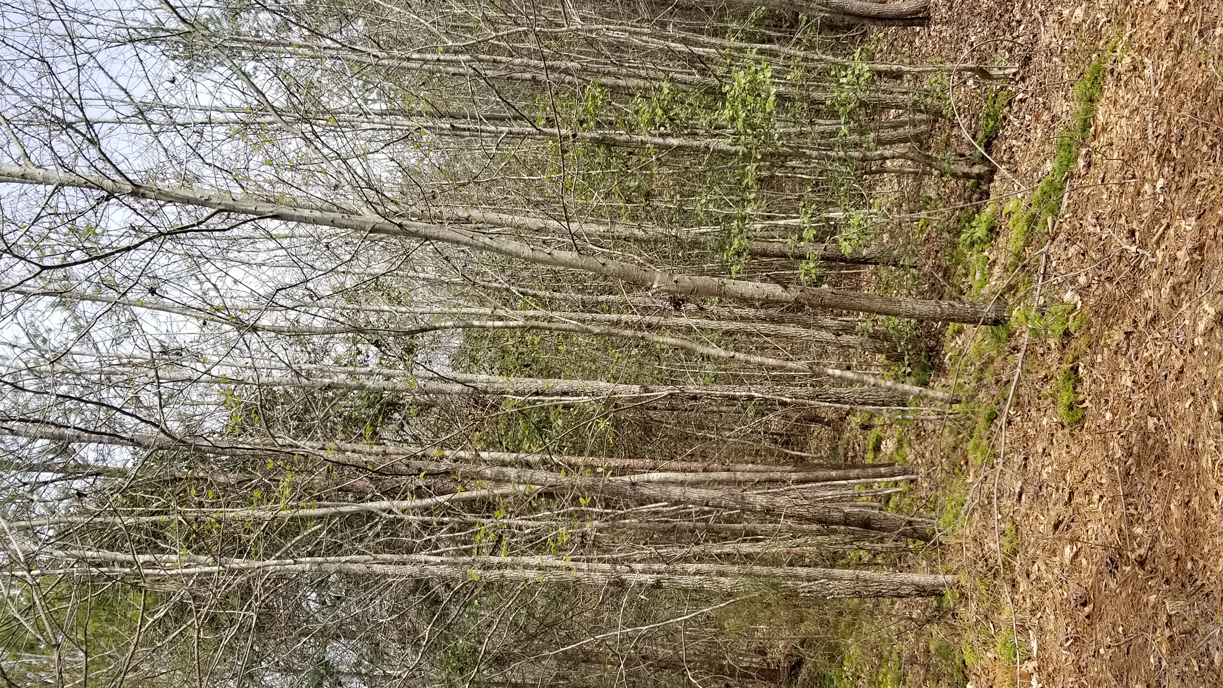

Hi Everyone,
My husband and I would like to ask for some help in choosing a tractor. We are going to a Kioti and a Kubota dealer this weekend to look at open air tractors (hubby doesn't want a cab). We have almost 40 acres that was recently paid off and we would like to build our home and a barn on it. About 1/2 the land is 2-3" saplings with some trees about 5-6" wide.
Initially, we would like to use the tractor to clear about an acre of trees, add fill dirt to raise up the driveway, and add about a 15' culvert (maybe a 12" pipe would work). We were quoted $4k to clear (mulch) the 1.25 acres of trees and $7k to level the driveway and install the culvert. Maybe use it to excavate our foundation if it could do it (crawlspace). We would rather put that money towards a tractor and put in a few months of hard work to save this money.
Afterwards, the tractor would be used to bush hog a few trails around the house, maintain a 1/4 gravel mile driveway, and transform a 2 acre low area near a creak into a garden / orchard, and install some fencing. We plan on a few chickens, goats, small farm and other land maintenance.
Would we be able to do all of this with a tractor? What size tractor would you recommend? Are there any implements besides a bush hog, front end loader and maybe a backhoe? We'll probably need an auger later. We've seen forestry mulcher take down trees, but there's not much information about using it on a tractor.

I would look at around 50 hp fwd tractors with shuttle or hydro. A grapple and box blade would be very useful for the tasks you list. a tree puller might work good for getting rid of the smaller trees. look at as many brands as you can. have fun, they can be addictive.
   / Tractor for homestead / land maintenance #3
A brush hog can take 1" or 2" stems but not much more. You can buy PTO driven forestry mulchers but they're expensive (like over $10k) and are limited compared to a dedicated setup on a skid steer. They won't mulch 5-6" diameter trees. (measure the trees- I usually guess way too small. The trees in those pics look larger than 5-6").
With a tractor you can chip smaller material (about 8" or less) and move brush and logs. You can cut the trees and brush with a chainsaw and chip or burn or turn it into firewood. It's a lot more work of course and you can't cut the trees below ground level. There are PTO driven stump grinders for a reasonable cost if you need the stumps to be below ground level.

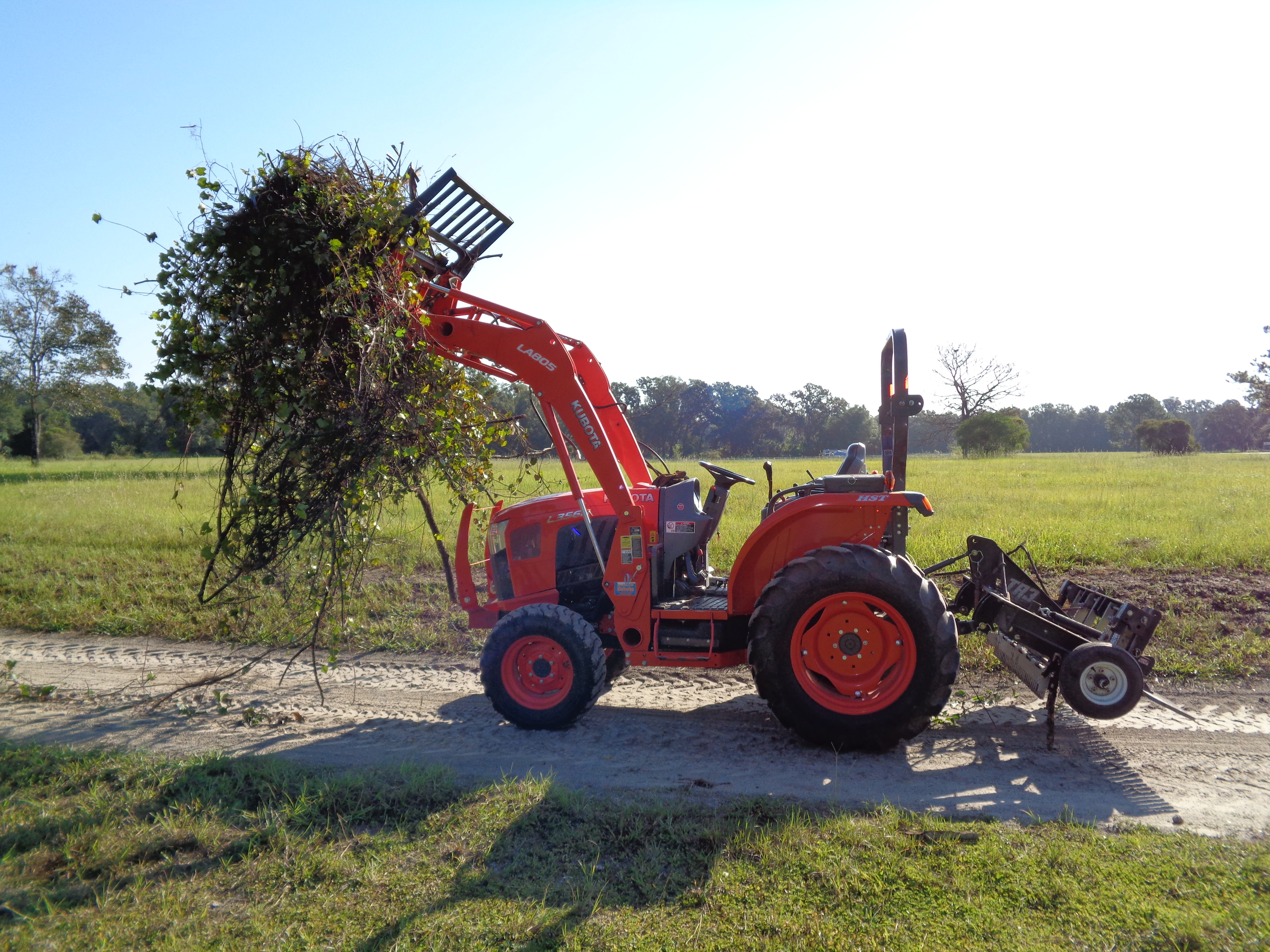

Are there any tractor implements besides a bush hog, front end loader and maybe a backhoe? We'll probably need an auger later.
Forestry munchers and stump grinders only reduce stumps to grade. You need the stumps and large roots OUT. Unfortunately, that leaves good size holes which need to be filled.
You will need a Box Blade and Rear/Angle blade for moving dirt. For the Rear/Angle blade you will want two pairs of hydraulic remotes on the rear of the tractor, so it can be adjusted as conditions change by the operator. Rear remotes are also helpful operating a Box Blade.
VIDEO: tractor rear blade - YouTube

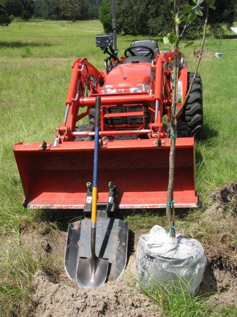

I recommend two Loader bucket attachments: A Ratchet Rake and a Bucket Spade. Each <$400. These will prepare your garden and orchard.
VIDEO: TRACTOR RATCHET RAKE - YouTube
OTHER IMPLEMENTS: https://www.lsuagcenter.com/~/media...aa214276e14dacb/pub2917tractorimplements1.pdf

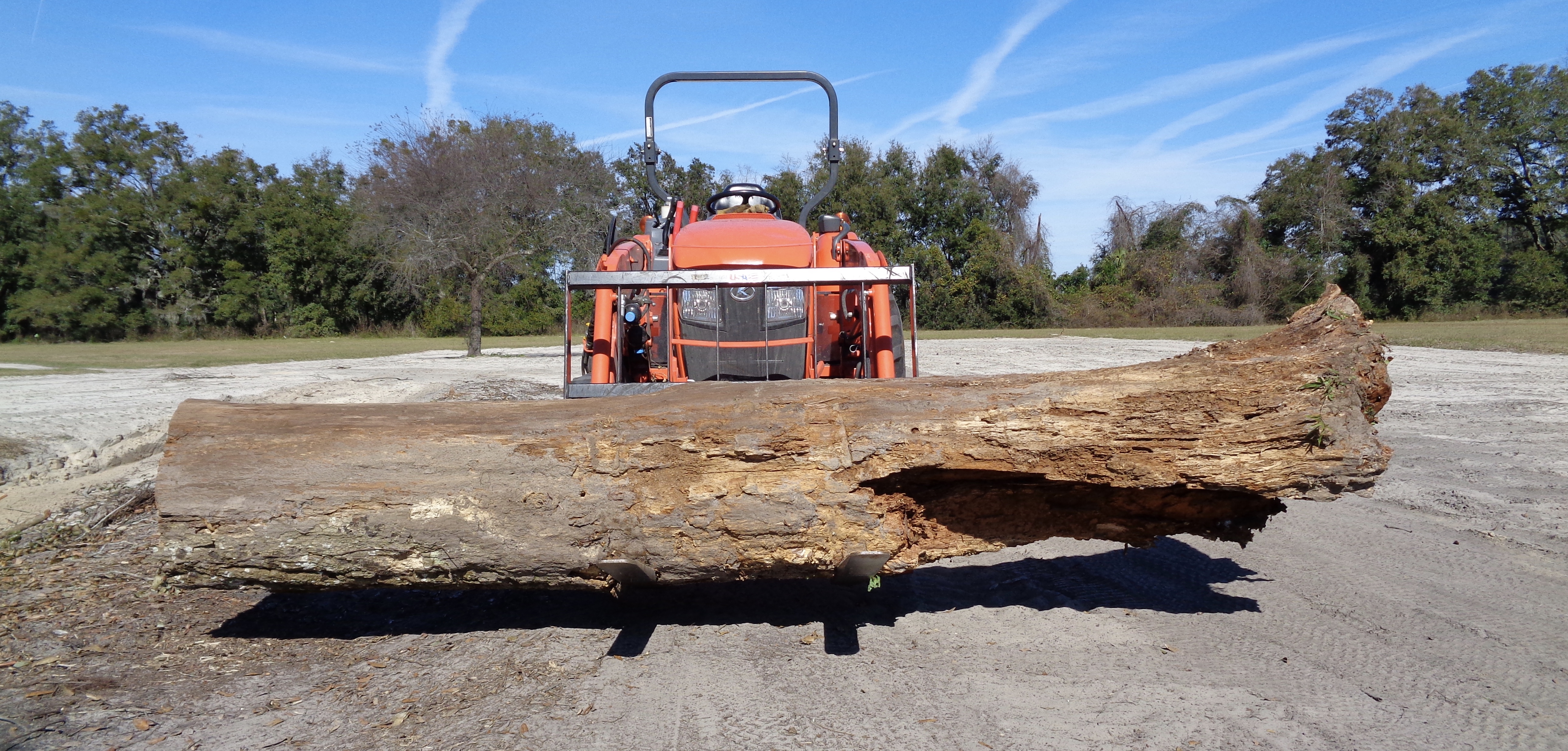

You will almost certainly want SSQA Pallet Forks for your home and barn construction and for moving tree debris corralled with the Ratchet Rake.
SSQA is an industry standard quick attach. (Skid Steer Quick Attach) Kubota terms SSQA a "two lever coupler". Same thing. SSQA is also how a Grapple is attached to the FEL.
That part takes a lot more work and detail than most people know. You can buy or rent machines to do most of the other tasks mentioned, but unless you've ever done foundation work before, you'd be better off contracting that out. It may even be required by local building code.
Stumps only have to be dug out if you plan on building over or immediately next to them. Otherwise they can be cut to grade and any sinking from rotting can be filled in later.
