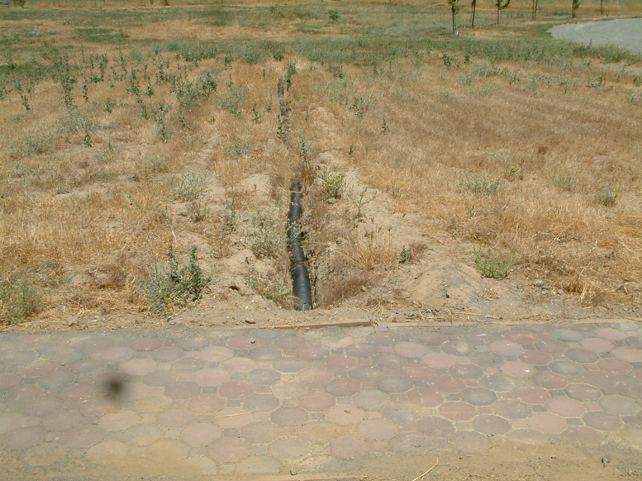

I cut a trench for 4" drain pipe last year during the rainy season when the ground was pretty soft. Used my 21-hp Kubota B7510HST and a middle buster plow. No problem getting to about 10" depth, but needed to hand shovel a lot of loose dirt out of the trench.
Whatsa "middle buster plow" ? Gotta picture ? If not, can you describe ? Sounds like the best solution to me, as I think all I need is 10 inches. I might even be able to figure out some contraption for getting the loose dirt out.

Bob, go to tractorsupplyco.com or kingkutter.com and look for "middle buster".
FYI, I live near Temple and the frost line here is about 3".:)
   / Tractor for ditch digging ? #10
The subsoiler will dig a little deeper than the middlebuster. You can switch out the blade on it to be whatever width you want. I think you want to get it as deep as possible for the electric line.
Here's a subsoiler:
And here's a middlebuster:
The only difference is the point and the subsoiler is about 5 or 6 inches longer. They should run about $150 or so for the King Kutter brand ones.
