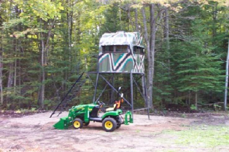

Well I didnt have the ones up I thought I did but here is a photo of the elevated blind we just put in which shows one of our food plots. All courtesy of the JD2210 /forums/images/graemlins/grin.gif

I guess it looks like to me two tractors. But your probably like me and others and can't see spending monies on two rigs even though we all would love it.
I see it with the plowing you would need a larger rig but you may only need it for plowing the one time. For mowing a smaller compact or even you could go into a sub-compact. The sub-compact would give you the best mowing job. I would seriously sit down and look at how much time you will spend on each task. If it is mostly mowing then buy for that and rent for the others. You could go with a New Holland TC24D or an equivalent of the others. This would give you an all around rig that would be able to do some serious loader work and mowing. Good to plow also. I just think a sub-compact for plowing 5 acres would be a bit light.
Go visit a few dealers, you will have lots of fun doing that and you will get a feel for which brand you like. It doesn't make much difference on the brand, it is more important to have the right size, a good dealer that you are comfortable with and will support you after the sale.

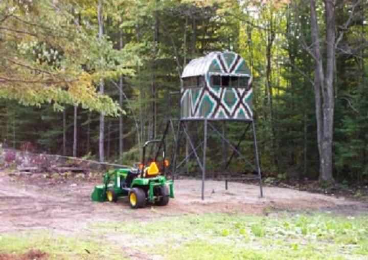

yeah it definately depends on what you want to do in regards to haying as well. Heres some more photos.

   / Tractor for Deer plots #6
This photo and the one prior give a little better view of the tractor. You also probably need to let us know a little more about what you mean by plowing up 5 acres. Is it already cleared and tillable etc.
