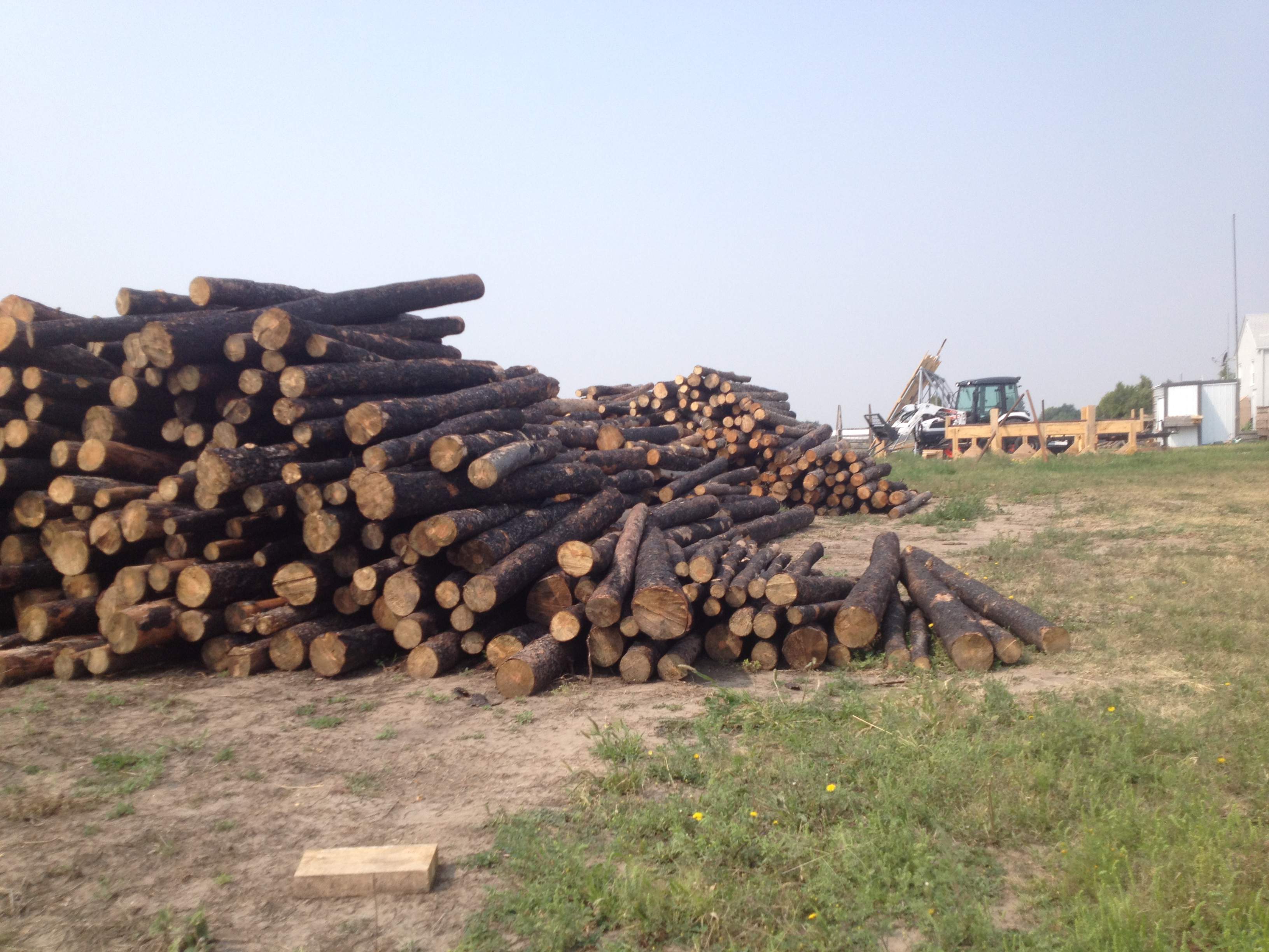

I am needing to handle more weight than my current tractor will handle and wanted to get some suggestions. My current tractor is a 45 HP Bobcat (Kioti/Daedong) with a cab and FEL. I bought it about a year and a half ago and have really enjoyed it. IT has dual rear and front remotes. Dual AG on the rear and one AG And one skid steer on the front. The skid steer OQ is tied to the loader so you can press a button and use the curl function on the loader to operate the implement. Things like a grapple work great so you dont' have to move your hand from the loader control. The cab is really nice here in the winter and the little tractor does pretty well in the snow, especially with a box blade on back with a hydraulic top link. My neighbors all have big 100+ hp John Deere tractors so they like to give me a hard time. I have recently ordered a post peeler for it. Here is that thread.
http://www.tractorbynet.com/forums/attachments/332831-pto-post-peeler.html?highlight=
While waiting for the peeler to arrive from France I have started stockpiling rap logs in the 4" - 10" range typically just over 7-8 ft long. I immediately noticed that I was not able to lift very many raw logs while unloading my trailer. I have a pretty heavy box blade I built out of some scrap I beam and Channel it it work great as a counterweight. Even with that It still takes me 5 trips to unload a trailer with about 100 logs and these are all dry. I'm supposed to start taking delivery of green material in the next few weeks and it's going to be slow going trying to unload with this setup. The machine is rated for 2050 pounds of lift capacity at 500mm in front of bucket pivot and 2,600 at the bucket pivot. I have the bob tach option so that probably adds a couple hundred pounds and the forks probably weigh a couple hundred to my guess is the machine likely has a capacity of around 1500 or less pounds halfway down the forks. So when I have about 15-20 logs on (depending on size) I am pushing the limits of the machine. Unfortunately that is not going to be enough to lift the correct size bunks that I have to bundle the peeled posts in to sell to the mill. Those are going to weigh around 2,500 up to a max of about 3,000 pound and a little more than that if I ever have them treated and have to unload them. Essentially I need a machine that will lift 2,500 pounds comfortably. Unfortunately the little Bobcat/Kioti/Daedong is not going to work. Which is too bad because the peeler only requires about 20 HP at the PTO to work so this would have been a nice little setup and been pretty easy on fuel.
I've considered just buying another piece of equipment like a little versahandler or other small telehandler or even an off road fork lift. I have a construction background and owned a JCB 550 telehandler in the past and absolutely loved that machine so I have a soft spot for telehandlers. I like the size of the little Bobcat versahandler, 10,000 pounds. But after looking at costs for those types of machines I don't think I can afford to go that route. . New ones are about 65k and I found a used one if pretty good shape for around 40k. I just can't justify having 70-100k tied up in equipment to run that little peeler no matter how much I just want a telehandler.
