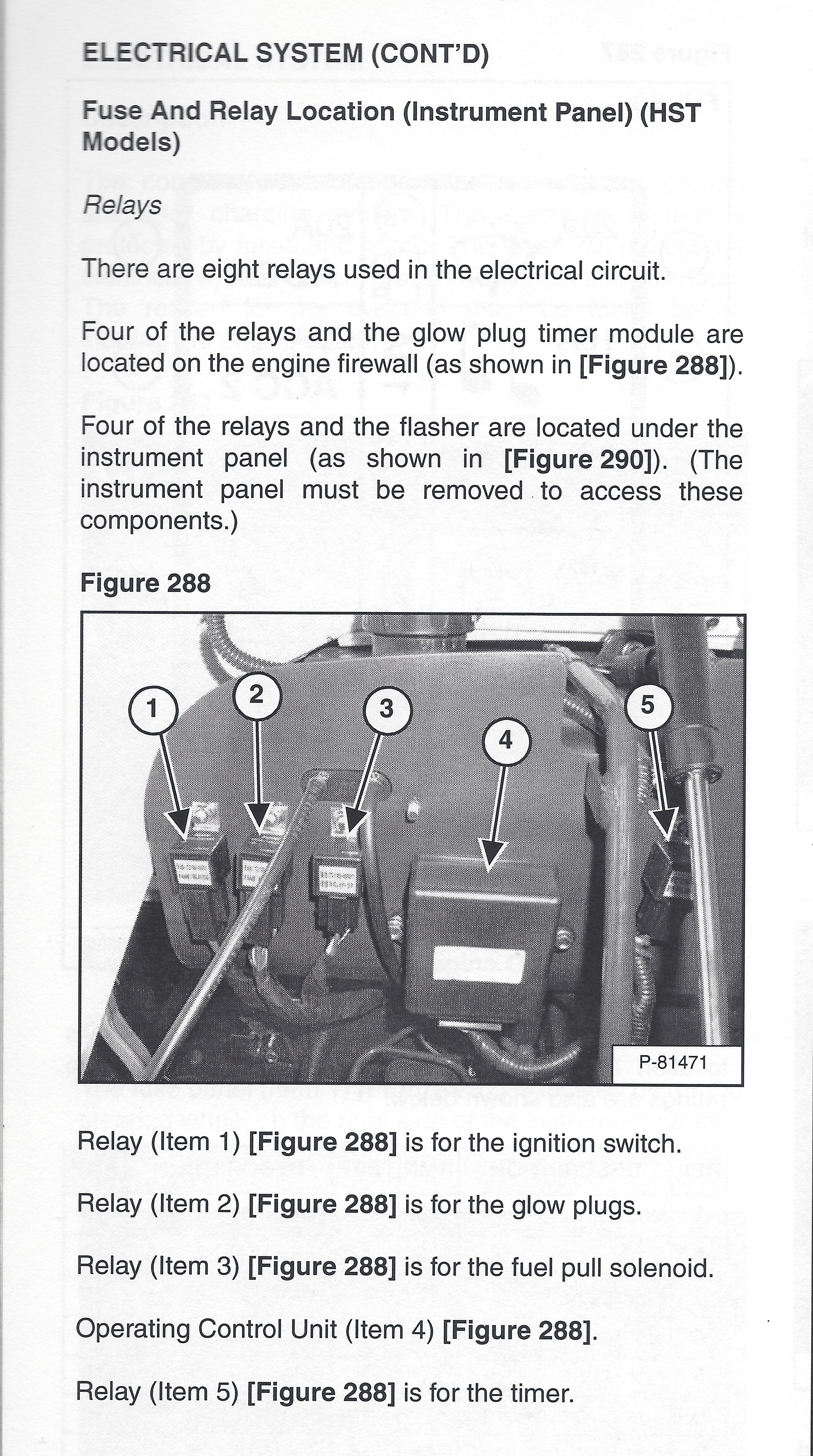

I think that you'll find that the problem is the
switched power relay - the relay shown in
the attached photo as the "eroneously labeled"
timer relay. It's item 5 in the photo below.
I've had to replace this relay twice now in the
last five years. It's failure (intermittent or continuous)
results in the same symptoms that you have described.
Good luck, and please let us know what the final
resolution is.

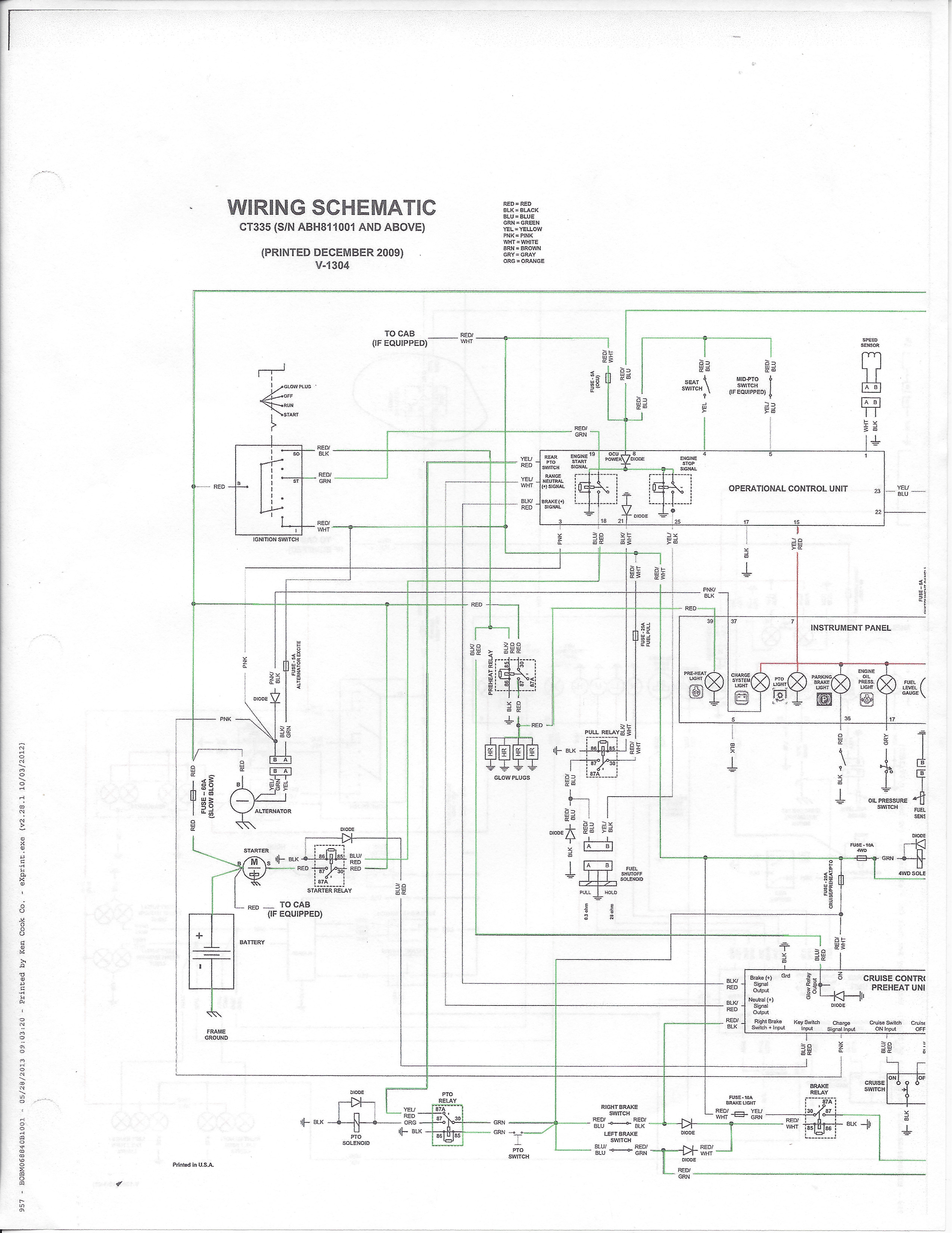

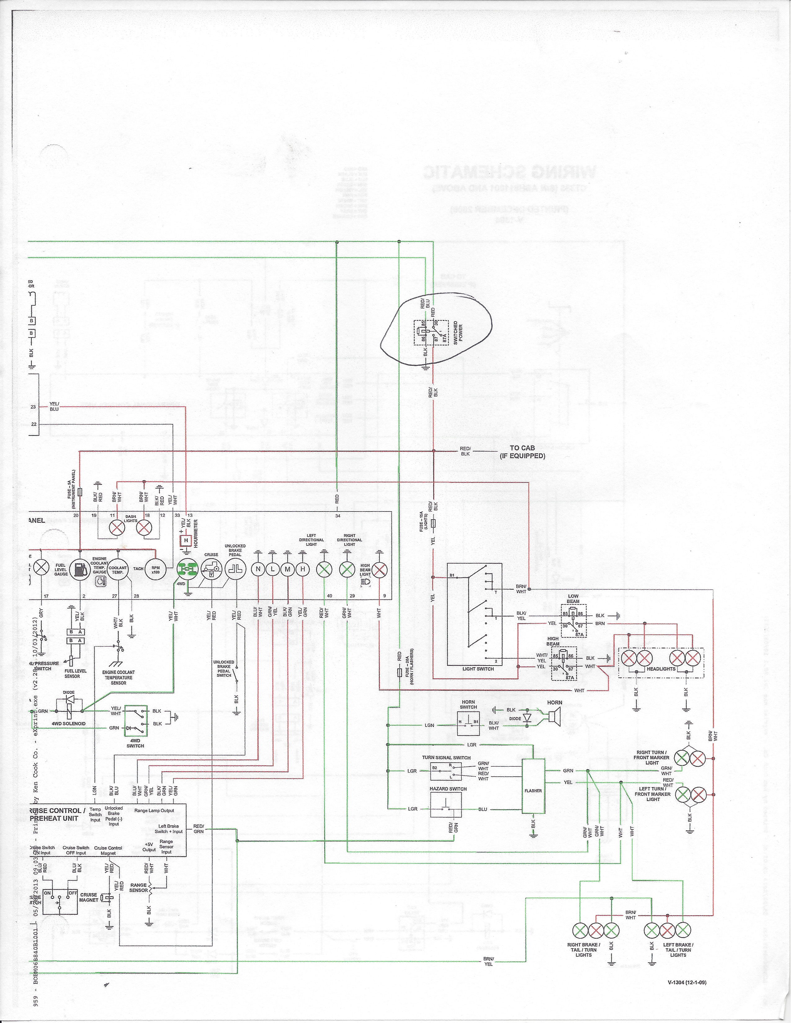

In case this might help, shown below are the electrical schematics for the CT335
electrical system. I've highlighted the parts of the circuit that are fed from the
switched power relay which is the probable cause of your problem.
