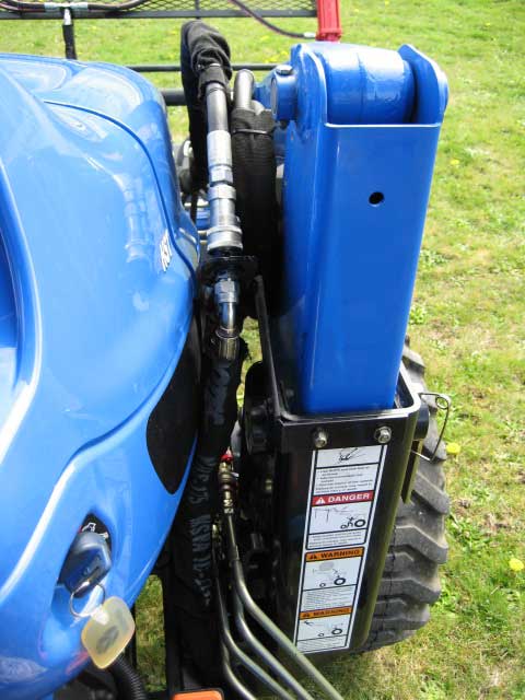

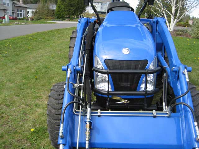

Normal?? Some people say I'm not normal, but I don't think so. :rolleyes:
I have a 3rd function setup for my grapple and it would've come with hyd lines running all the way from the rear remotes to the QCs up by the bucket, instead I have an additional set of QCs at the FEL mount. That way it's easy to either remove the FEL or just the bucket/grapple, and never have to reroute any hyd lines. All depends on $$ vs convenience.

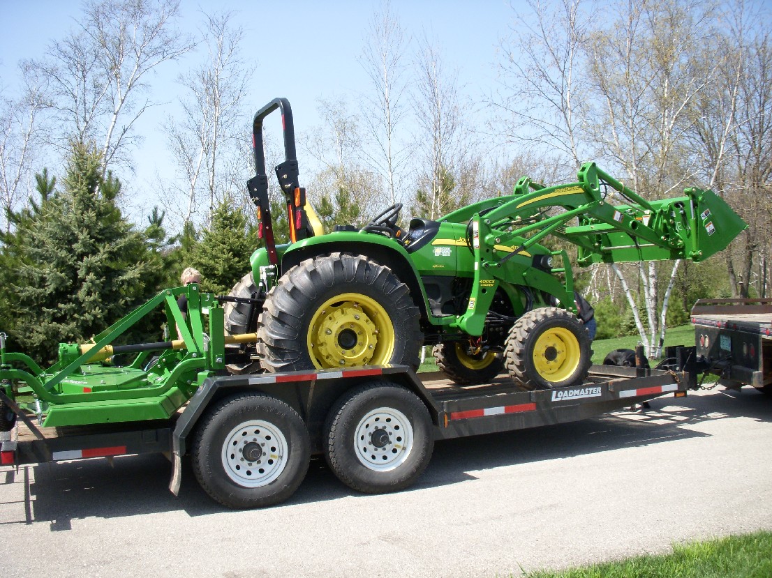

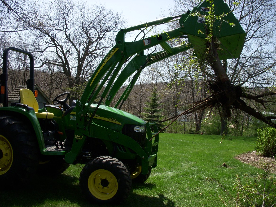

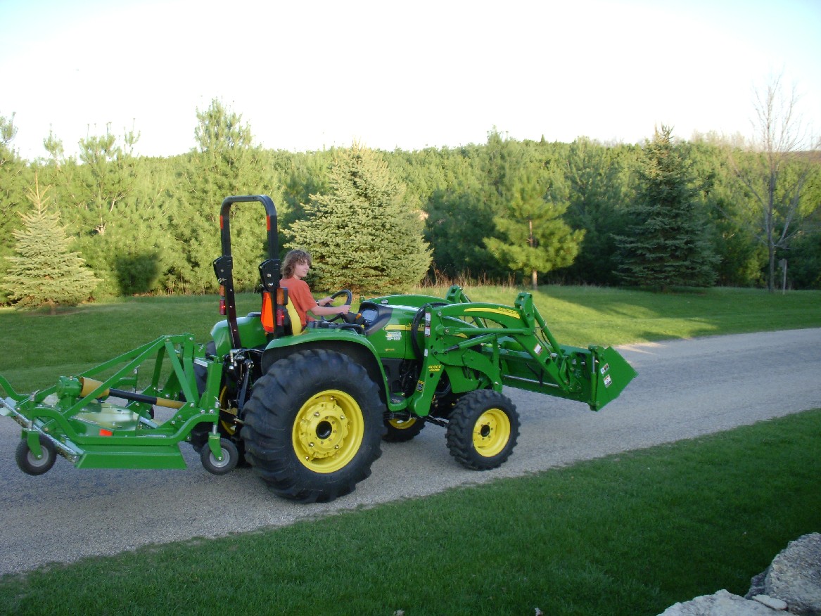

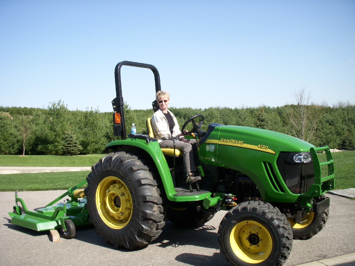

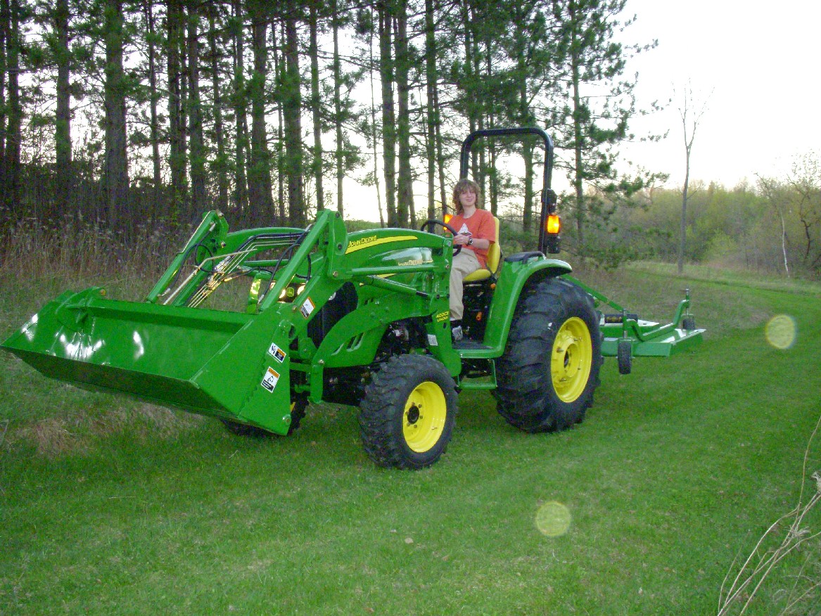

OK, Here are some pics of what my son calls the awesome tractor. I resized them so I hope this works. I promised the wife that the first job for the tractor would be to pull out a tree she wanted removed, the FEL plucked it out like a weed! 1.jpg
/ Tractor delivered! #13
do you have a clam shell bucket? i thought i saw it but wasnt too sure. great looking tractor though!
