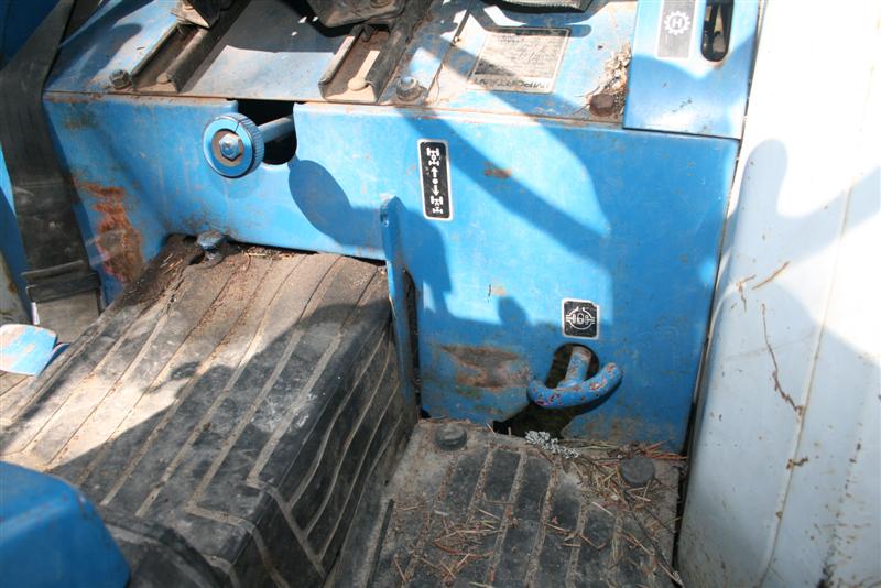

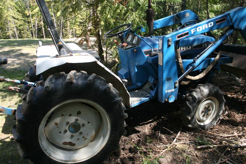

I was given a Ford New Holland 1520 tractor from my grandfather, but I am not sure what all the levers and controls do and I do not have a manual. I've taken pictures of the knobs, dials, and levers, and I was wondering if someone wouldn't mind describing what each does?
Thank you,
Luke

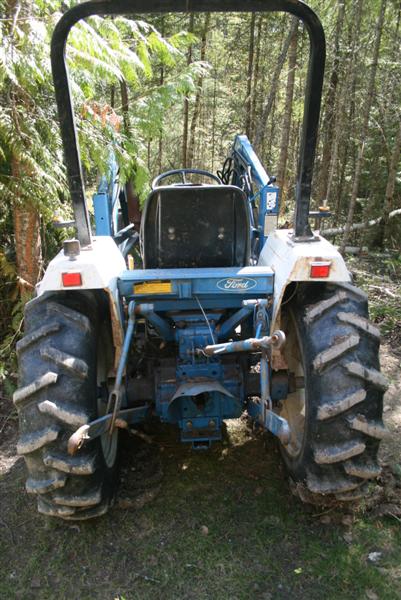

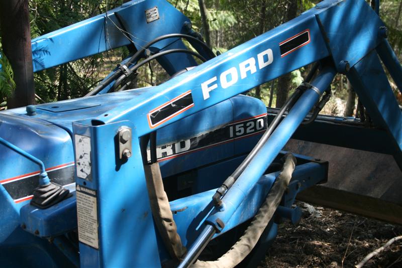

The Tractor:
attachment.php
attachment.php
attachment.php

Dial, Lever, U shaped thing:

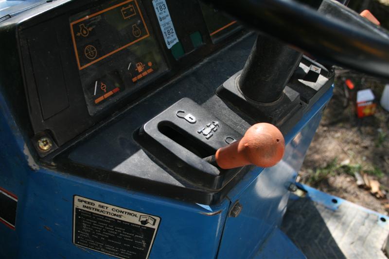

Big orange handle:
attachment.php

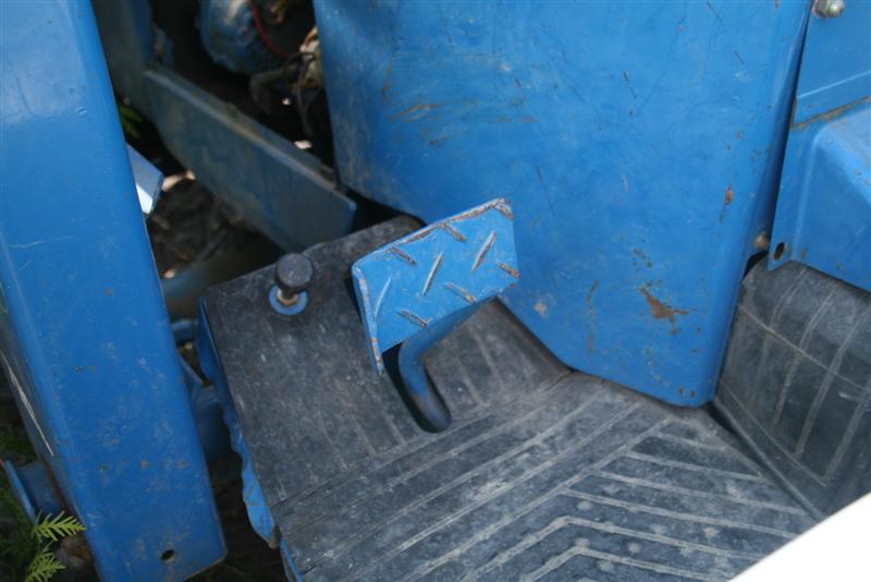

Foot Pedal: (I believe this one locks up the left rear tire?)
attachment.php

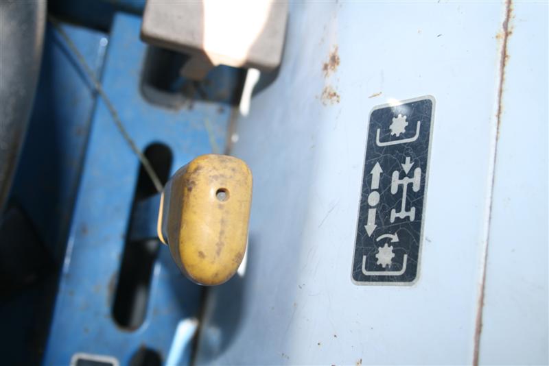

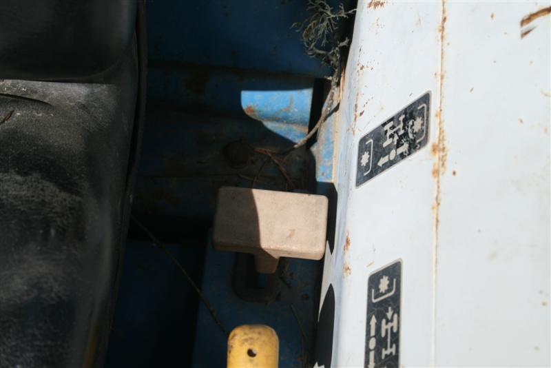

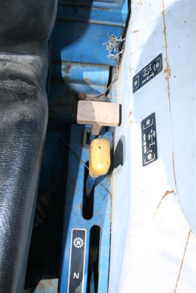

Pink, Yellowlever:
attachment.php
zoomed:
attachment.php
attachment.php

I'll start: Dial is 3-point hitch drop level - in = slower; lever is 4 wheel drive engage or not; U-shaped thing is rear differential lock pedal. I guess (only a guess) the Big Orange Handle locks the hydro so you can't move the tractor by accident getting on or off. You've got a pedal on each side controlling that side's rear wheel brakes. Pink lever engages the mid-tractor power take off; yellow lever the rear pto. Is that the reverse hydro pedal on the left in the first control pic? I don't own one of these so someone else will render more help, most likely

Wow, thanks for the breakdown Jim, and for the manual location Rick! I didn't expect such fast replies. That's interesting that you say the orange lever might be a hydro lock so the tractor can't be moved. I assume the position it's in in the picture is the locked position which would mean that so far I've been driving it locked, so I'll try driving it with it in the unlocked position and see if there is any other noticeable difference. It makes sense that that's what the control would be, so I'll have to test it out both ways.

Ah ha, you were right about the orange handle! The tractor has way more power now since I can actually push the pedal all the way forward and backward!! That just goes to show that I better get the manual.

Nice Score there fella!
That's 2200lbs of 23hp muscle. If you don't know the year, you can get the serial numbers from the Transmission housing , left side and determine the year. Somewhere between 1987 and 1996.

Luke, I read that orange knob a little differently, especially since the placard to the left and below it says, "Speed Set Control Instructions." That may be a "cruise control" for the HST transmission. With the control to the unlock position, you should be able to easily change the HST pedal position. When you reach the speed you want, moving the orange knob to the lock position will hold the pedal so your speed is maintained. Give it a try and read the placard directions to see if it says something similar.

That's a spot-on observation. It locks the foot pedal to whatever setting it was at - cruise control! That's exactly what the nameplate you describe says too. What's funny is that someone was telling me that "those little tractors" (like the one I now have), "aren't that great as tractors because since they're hydrostatic drive you can't lock the speed", which is obviously incorrect since you can, and all a person has to do is read the instructions!!
