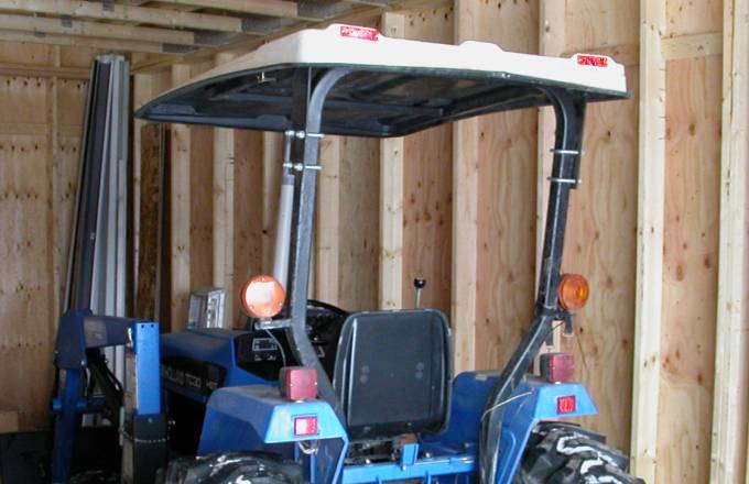

That looks exactly like the one on my TC30. Mine was dealer installed but I didn't ask who the manufacturer was. It's a very nice top, thick fiberglass and solid mounting and color matched. I paid $250 installed.
Rodger
   / Tractor Canopy from Femco #6
It looks very similar to the one on my TC30 also. The part number was F1921 and it was purchased from a NH dealer for $250.
   / Tractor Canopy from Femco #8
Scrounger, I will go along with Pineridge I bought a Firebird canopy from my dealer for my L3710, installation was a breeze everything fit just right in addition to being a very well built unit. On top of everything else ( pun intended ) a canopy make the addition of worklights very easy, I like having my front lights on the canopy because they are 24 to 36 inches ahead of ROPS mounted lights thus giving you a better angle of light on your work area.
   / Tractor Canopy from Femco #9
I called my local dealer & they have the exact Firebird fiberglass canopy instock for my Kubota. They want $430 for it. I am worried it will make noises as sometimes fiberglass does. It that skweaky raddle I dont want especially when using the loader.
   / Tractor Canopy from Femco #10
No squeaky rattles here from fiberglass. I did however remove the pins in the ROPS and replaced them with grade 8 bolts to eliminate vibration from the hinge, never fold mine down anyway with 10 foot overhead doors. All is quiet now.
