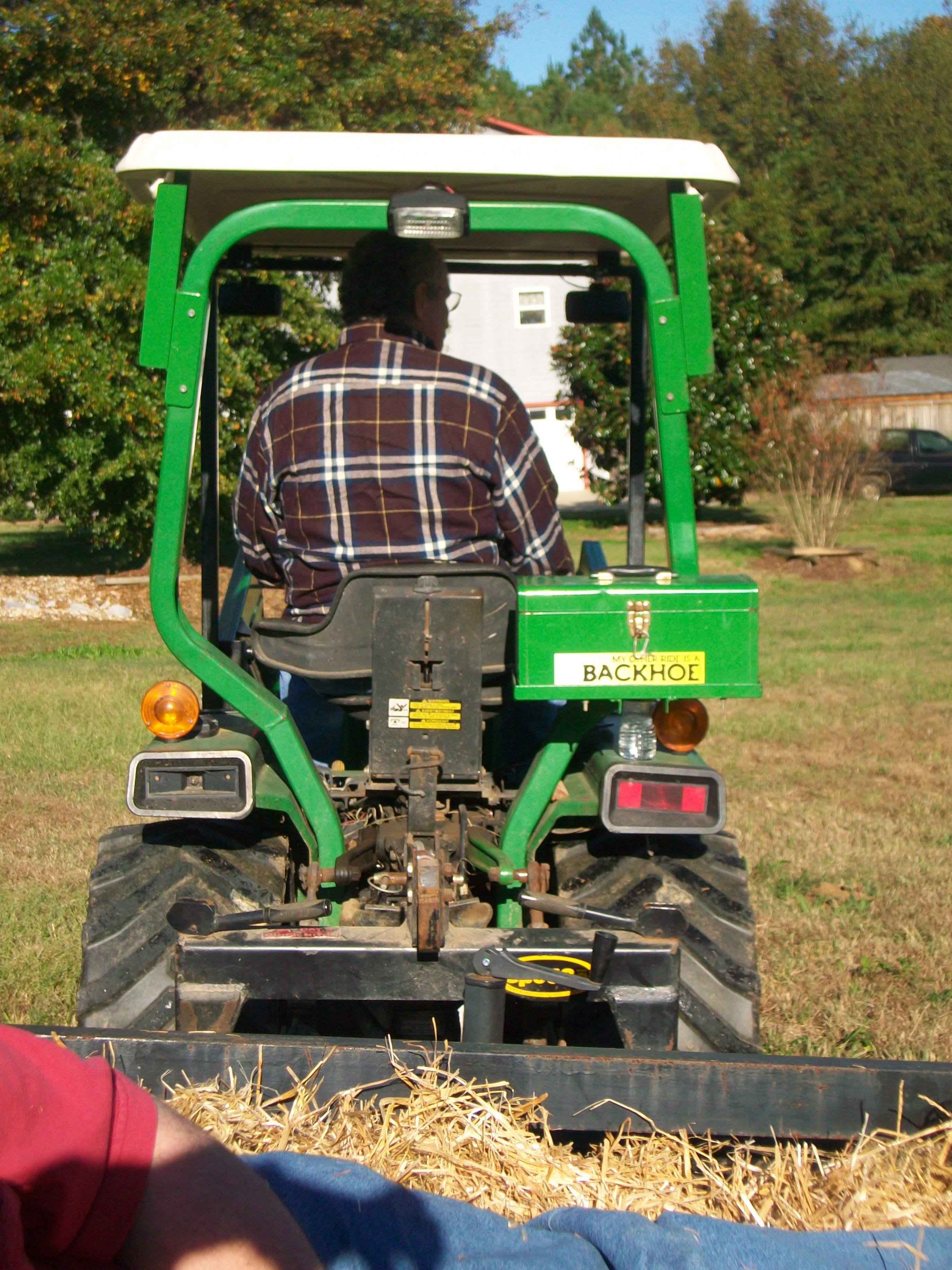

Looking for advice on constructing a safety canopy on my CK35hst. Have a crusher screen for a roof and would like to see what you folks have made. Thinking of welding 2 bars/tubes from rop to cross bar in front of instrument panel and adding the crusher screen to the top. Would need some kind of detach system to lower the rops, maybe at the cross bar and have a solid connection at the rops.

I used a golf cart top. It fits nice but I have a small tractor.

Good thought! it looks nice like that!
