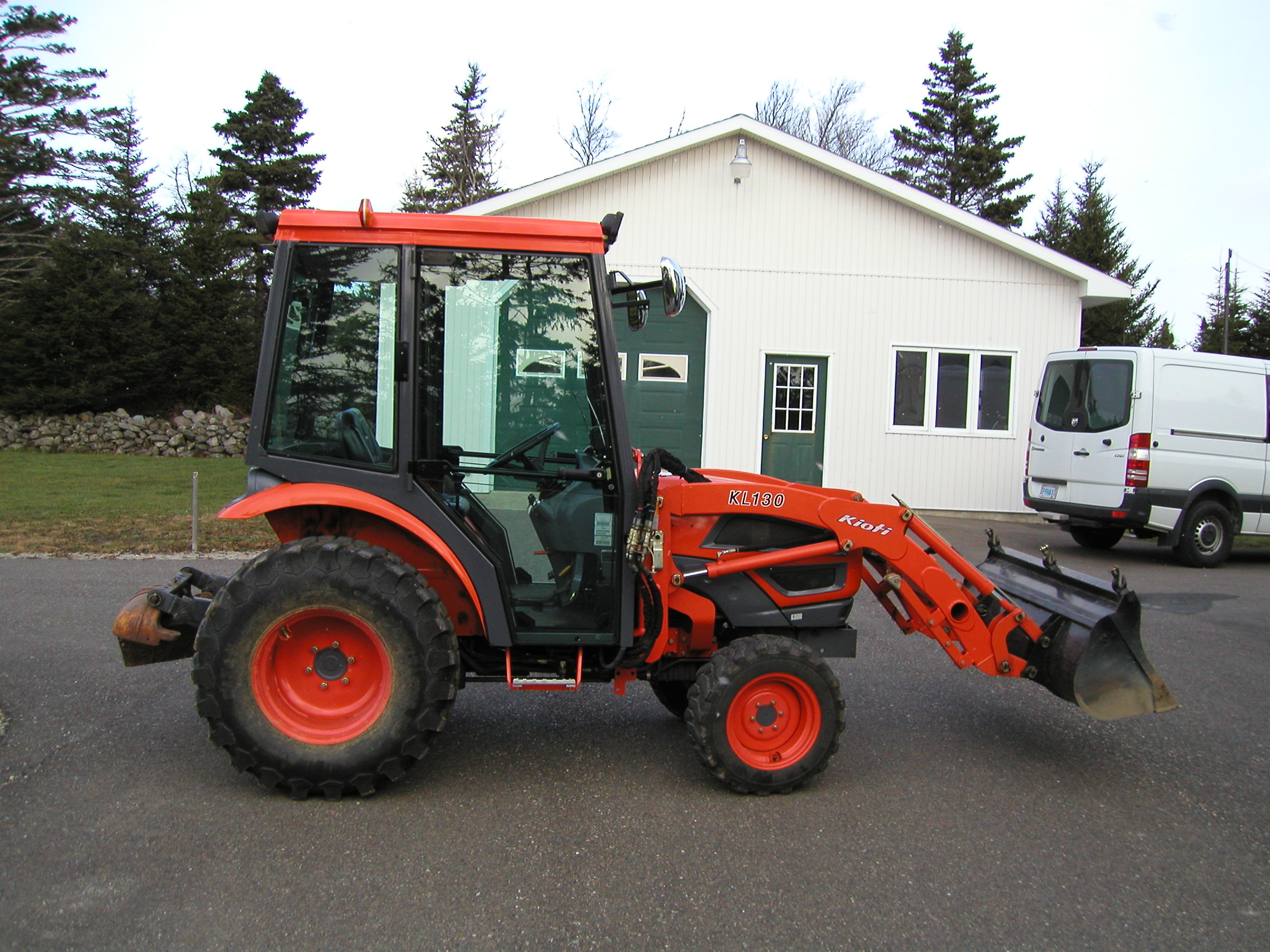

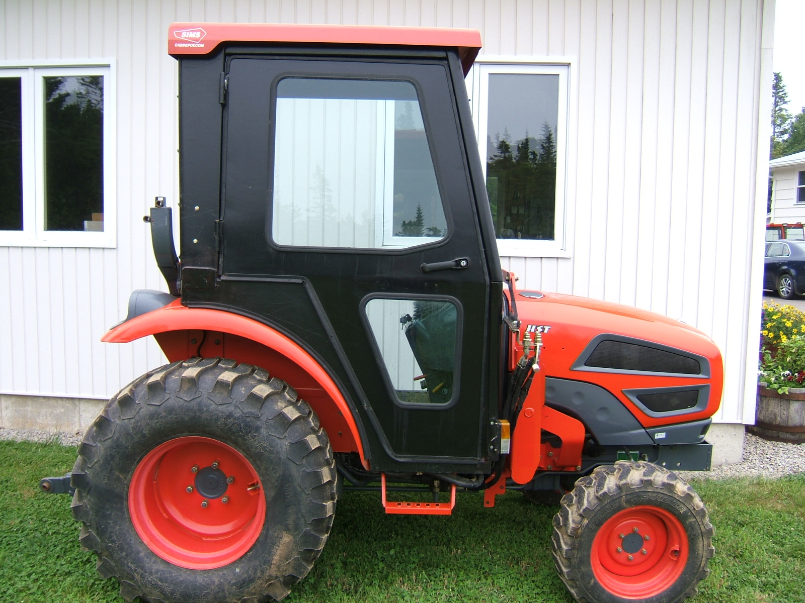

I bought my Kioti used with a Sims cab already installed, the black one.
It was designed to be mounted to the floorboards and it was. It would jump up an down and tear the whole tractor apart plus it was mostly steel and small rubber gasket windows so I couldn't see anything around me. I used the roof panel, heater, one wiper motor and the door latches and made a brand new cab. Now I have a solid cab with excellent visibility. The Laurin cabs are much better but cost about $6,000 from what I have heard. As far as interior noise, if your tractor was designed for a cab, meaning that the firewall separated the engine department from the drivers department, it will be quieter in a cab. If not it can be noisier with a cab.
