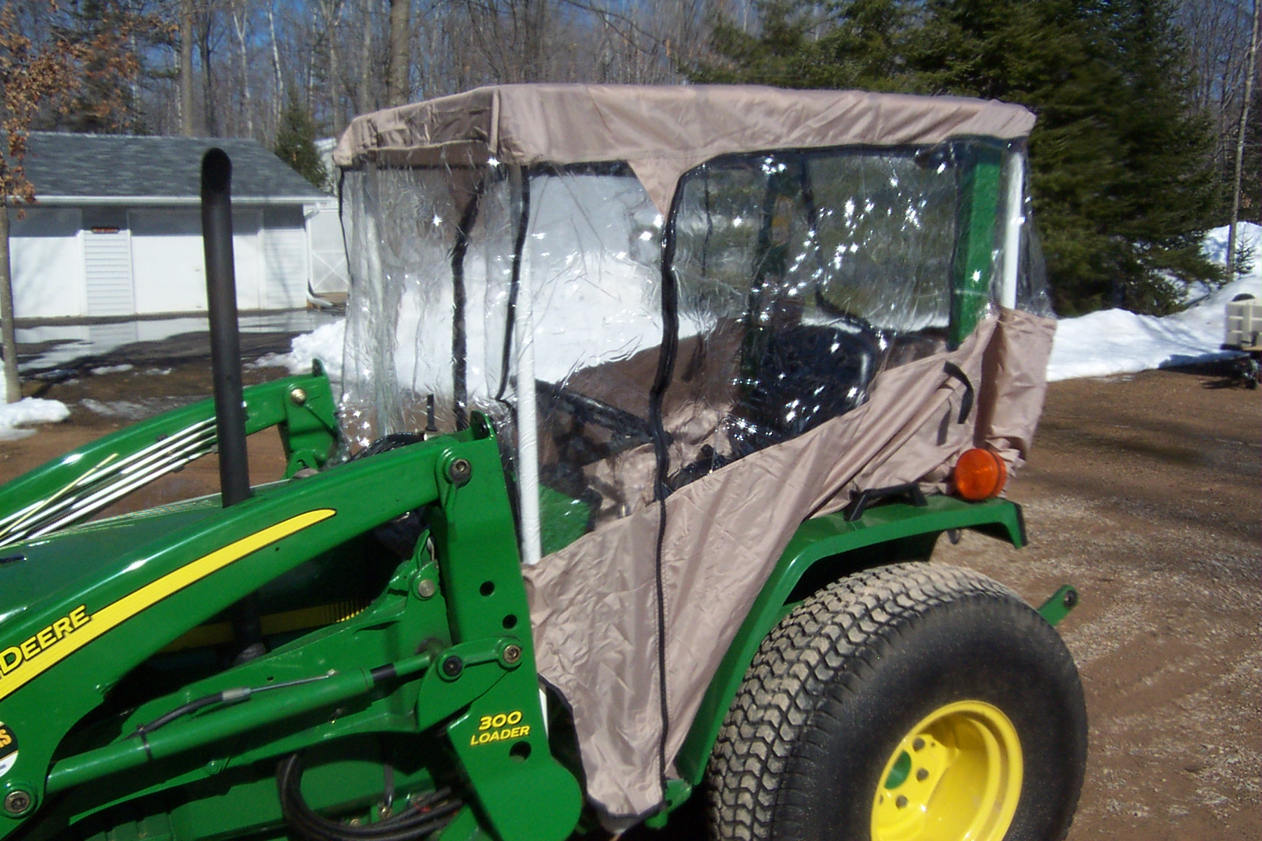

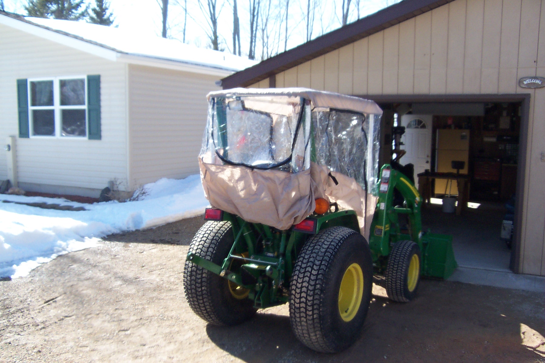

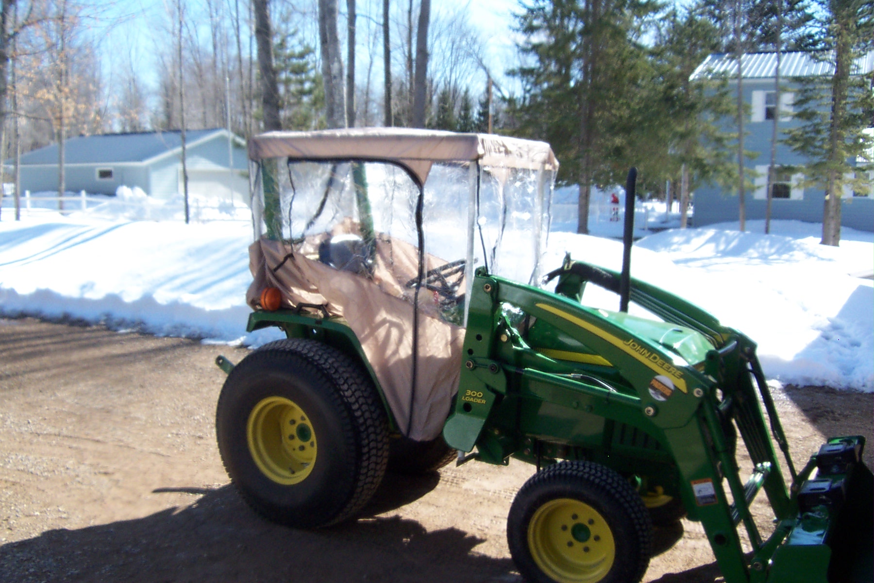

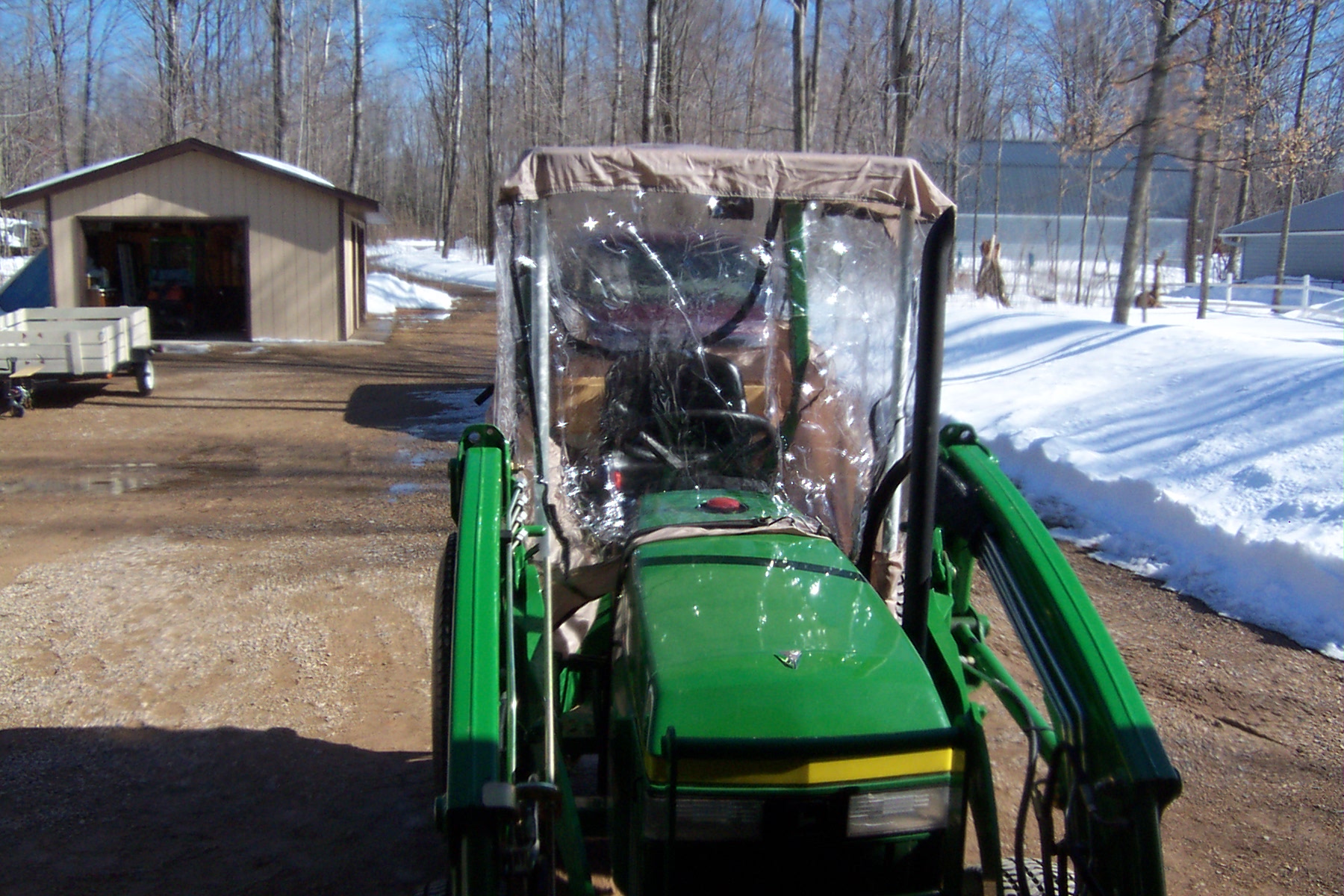

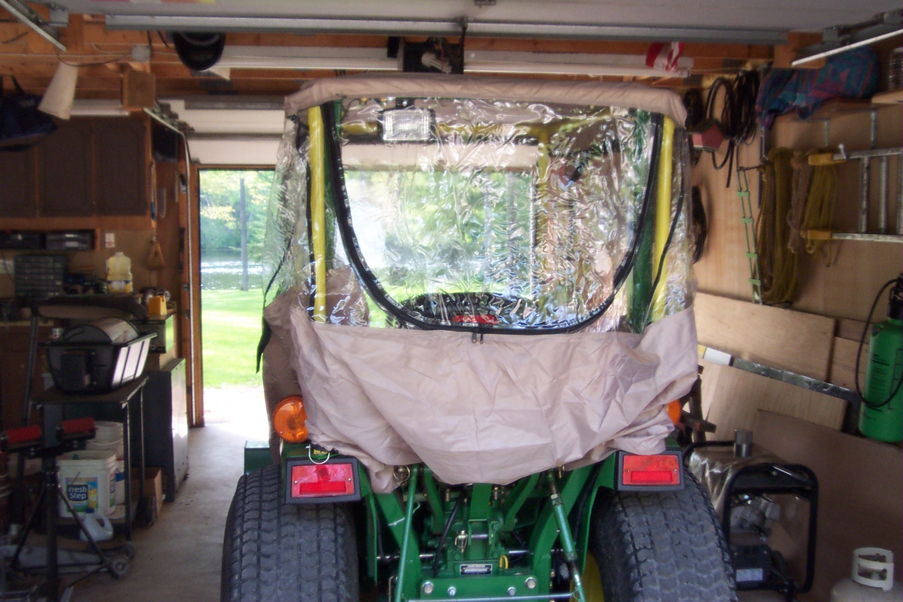

I built a tractor cab frame and bought a golf cart cover to go over it. I got the idea from posts on this sight.
Now this is my question, Is there a way to get the wrinkles out of the vinyl windows? Without melting it. Or should I just put up with them.

I wonder if you put a small electric heater inside to warm the plastic and maybe the wrinkles will work themselves out?? Just a thought.
   / Tractor cab #3
Have you tried a hair dryer? It might be worth a shot.
Joe
   / Tractor cab #4
yep, hair dryer or heat gun but keep it moving ...and, simply being patient, many wrinkles will iron themselves out

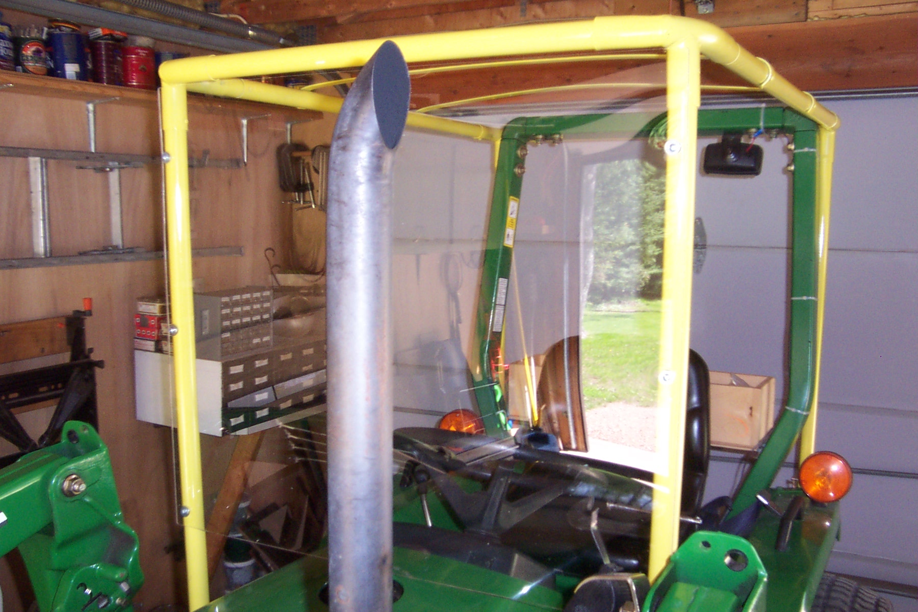

Is the frame made out of pvc pipe? How does it all hold up to wind? looks like a great idea, i'm thinking about copying it for next winter.
   / Tractor cab
NO, the frame is made out of steel tubing I had laying around from a canopy that the wind destroyed.

I've got a portable vinyl golf cart windshield for my Kawasaki Mule that secures via bungy cords attached to the roll bar. Never have been able to get the wrinkles out of it. Just about useless. Can't see much of anything :(
   / Tractor cab #9
INMHO you won't get the wrinkles out.
You can live with the sides as is, but front need to be flat for good viewing.
Maybe replacing the soft flex vinyle with a similar sheet of plexi or lexan could do the trick.
I suspect that the vinyle could be somehow glued to a plexi to make a rigid front window being as both are of the 'plasic' family. Trick would be to find a suitable adhesive.
(Could that be an automotive windshield sealant? or door seal adhesive?)
Personally, I'd try FLEXTRA, which is a polyurathane caulking 'in a tube'.
