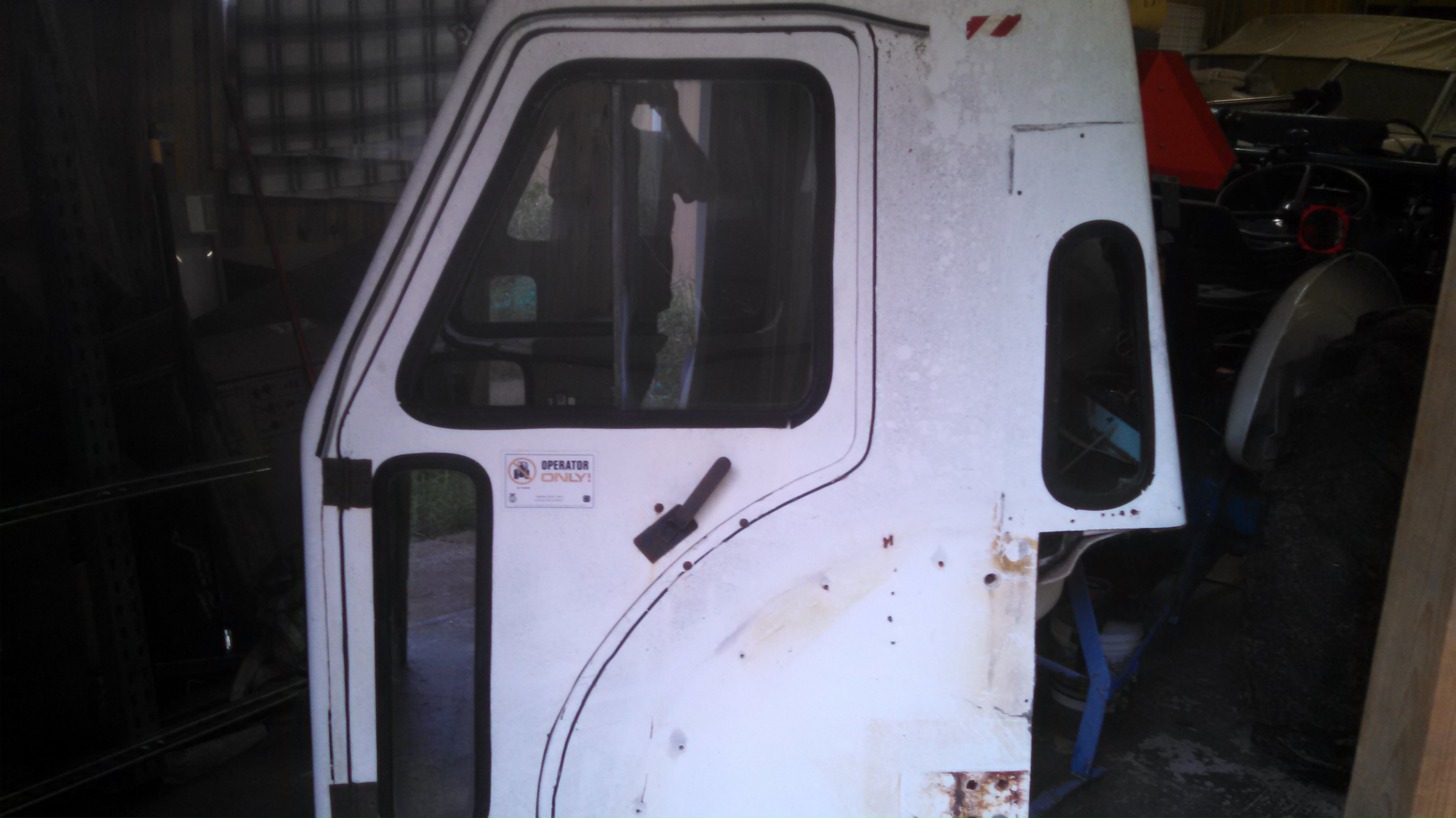

Picked up a cab from a Ford 4000 I am going to setup for my 3000. Guy took it off because front and back glass were cracked and roof mounted heat/ac quit.
The rest is very good. Its fiberglass with a steel tube frame and integral heavy rops bar. Will have to move my fenders out 2" each side and adj for different loader control position. Will post more pics later.

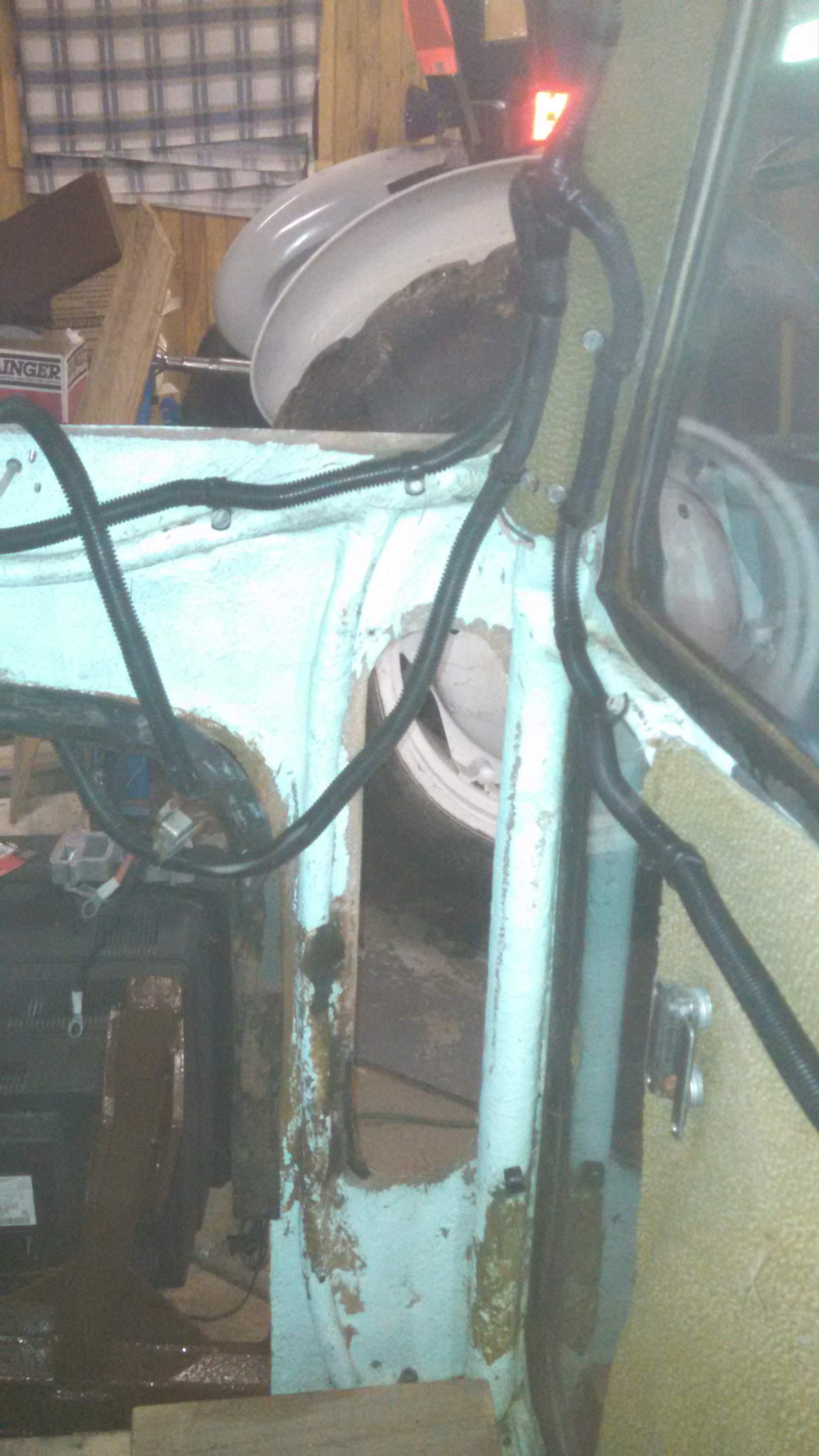

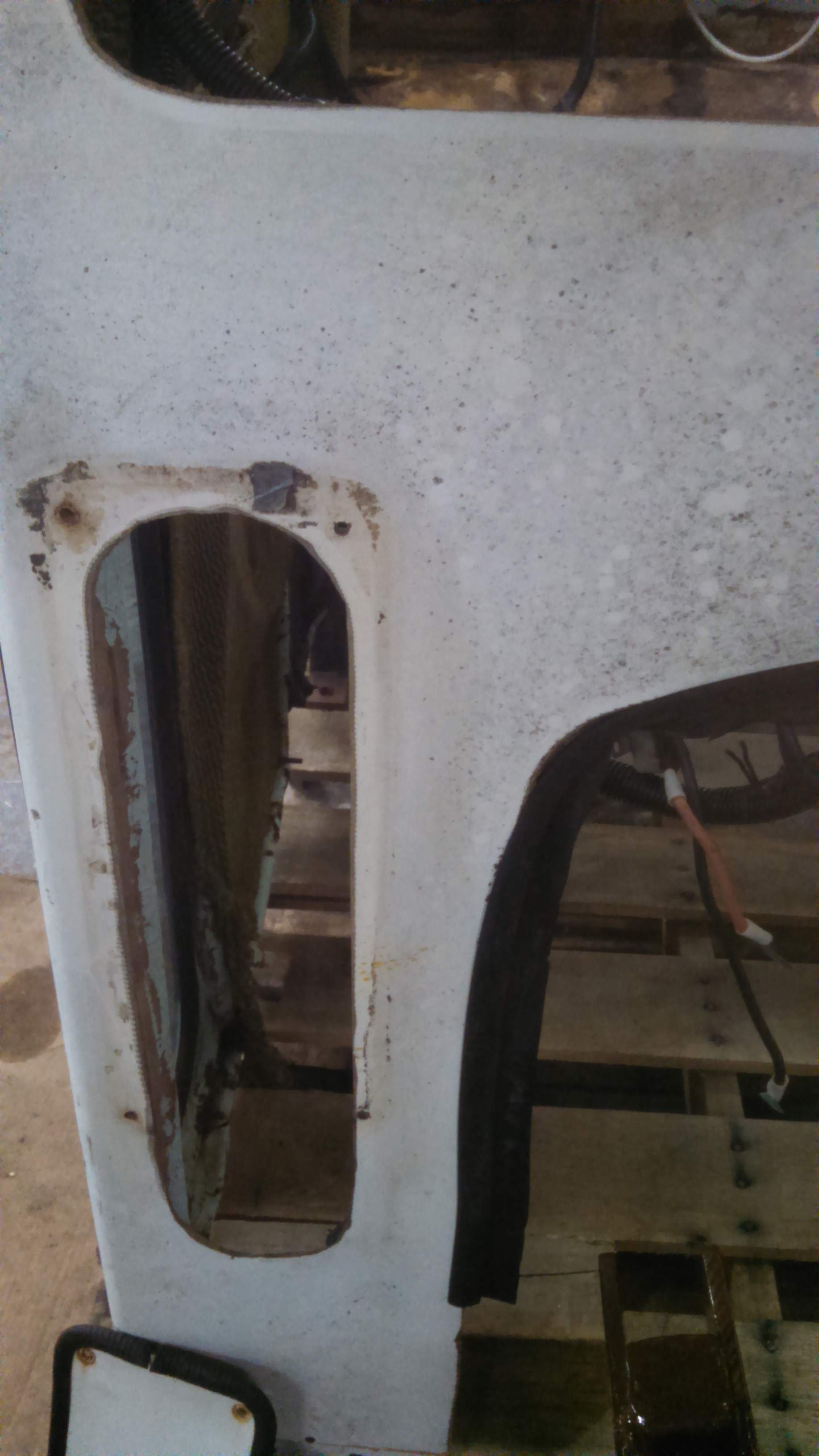

I have safety glass on the left side up front. The tricky part is around the loader valves and bracket. Current cutout is 5 in x 20 in. And a little high up. I need it 8 3/4 by 14 or so but about 5 in lower. The fiberglass will be easy to cut but I have to cut into the steel tube frame between the cutout and the hood opening. Looks like in need to take about 6 in out. Probably rigid enough without it. If not can put in a u shape section or crossbar to the side. The two pics show the areas.IMG_20140925_212440_928.jpg

Both pics did not load. This is from outside need to cut wider starting about 3in down from top of hood opening.IMG_20140925_212412_295.jpg
