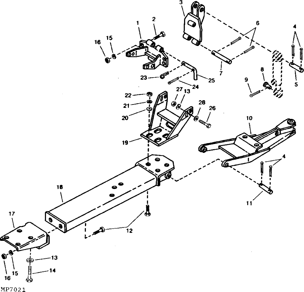

I have a john deere 750 compact tractor and I wondered if there were any type of brackets so I could mount a #380 snow blade to my tractor?

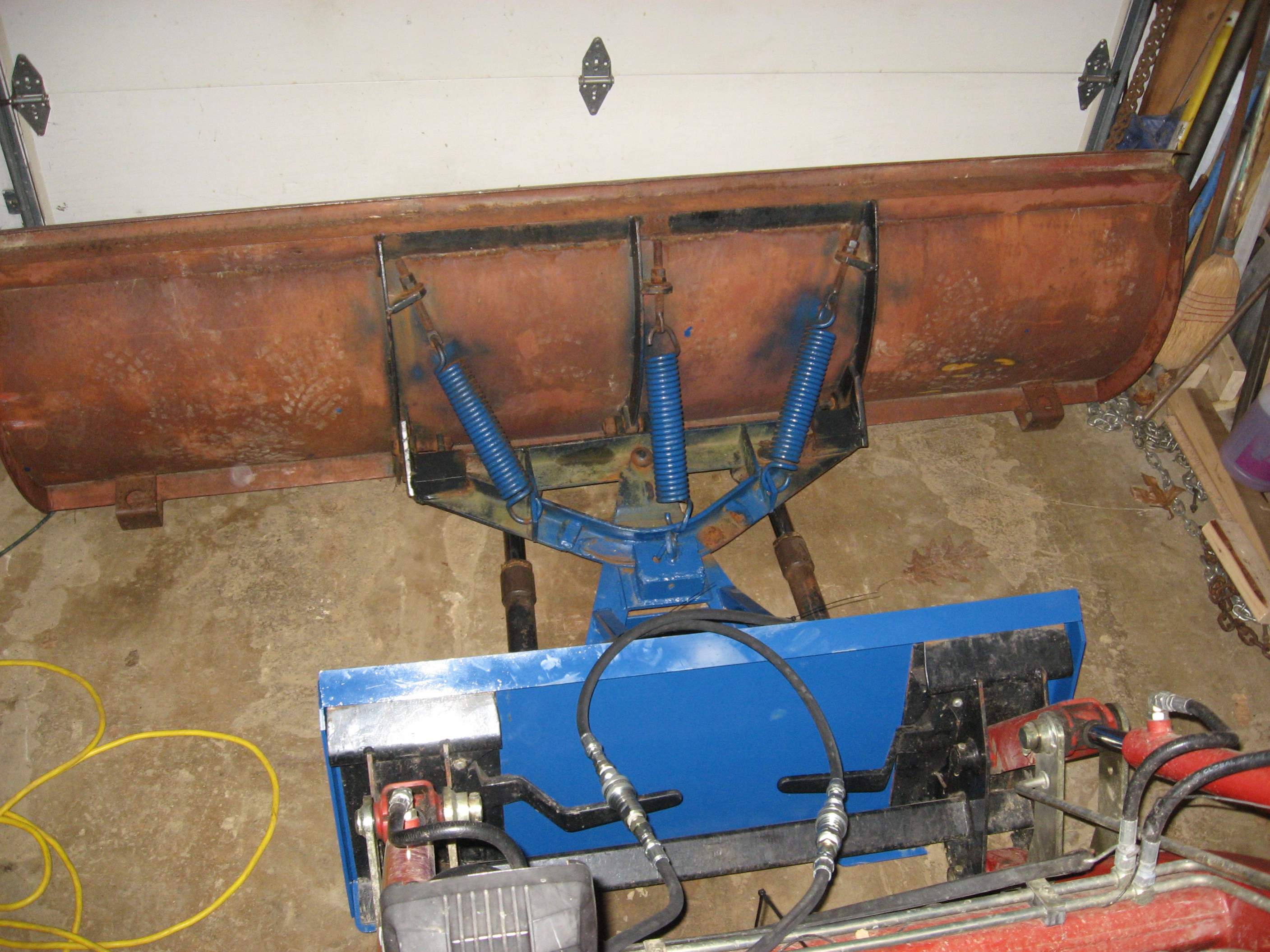

I actually just got done adapting a snow plow to my FEL. That seemed the easiest way to do it.

That's gonna be a tough find, I assume you cant weld/fabricate? Its a super heavy duty blade setup, I adapted one to me 4110 a few years ago, here are some pictures: https://picasaweb.google.com/113966569709555812037/PlowPics
User JD755 may have some info as well if you want to PM him.
Here is what JDP shows for the 750:
FRAME
FRAME - CONTINUED
Cart KEY PART NO. PART NAME QTY SERIAL NO. REMARKS
1 PT5156 PLATE 1
2 19H1978 CAP SCREW 4 7/16" X 1-1/2"
3 PT5165 SUPPORT 1 (SUB FOR PT5155)
4 11M7038 COTTER PIN 6 6.300 X 40 MM
5 PT5145 PIN 1
6 11M7059 COTTER PIN 2 3.200 X 20 MM
7 PT5157 PIN 1 9.52 MM, (3/8") DIAMETER
8 PT5141 PIN 1 19 X 50.8 MM, (3/4 X 2")
9 11M7017 COTTER PIN 1 3.200 X 32 MM
10 PT5152 FRAME 1
11 PT5160 PIN 2
12 19H2591 CAP SCREW 6 - 10881 5/8" X 2"
19H2586 CAP SCREW 6 10882 - 5/8" X 1-3/4"
13 12H301 LOCK WASHER 8 1/2"
14 19M7387 CAP SCREW 4 12 X 40 MM
15 12H293 LOCK WASHER 4 7/16"
16 14H1047 NUT 4 7/16"
17 PT5153 SUPPORT 1 REAR
18 PT5151 FRAME 1
19 PT5154 SUPPORT 1
20 24H1106 WASHER 4 11/16" X 1-3/4" X 0.134"
21 12H294 LOCK WASHER 6 5/8"
22 14H1083 NUT 6 5/8"
23 J16931 SPRING LOCKING PIN 1 (SUB FOR PT5131)
24 34H256 SPRING PIN 1 9.52 MM (3/8") DIAMETER
25 PT5158 PIN 1
26 19H2528 CAP SCREW 4 1/2" X 2", UNF
27 14H865 NUT 4 1/2", UNF
28 24H1207 WASHER 2 9/16" X 1-3/8" X 0.134"

I've got to re-route the hydraulic lines this afternoon as I just got it finished up this past week and started moving it around only to find that I had a few things too tight so I'll get some pics while I'm getting that ironed out.
   / tractor brackets for a #380 polow blade to mount on 750 compact tractor #6
I got the blade from a friend. Had been sitting in his yard and I strategically asked him "What are you going to do with that?" while his wife was there. She urged me to take it. haha.
My FEL uses a skid steer QA on the front so I welded everything to a plate for that.
I had to cut the frame on an angle because my plate on my loader does not sit straight up and down when the bucket is level, so I wanted this to be close to that. As I looked at it, I thought that 2 pieces of angle pushing on a 1/4" piece of plate may start to bend things etc. So I used a few pieces of 2x2x1/4 square tubing that I had to help spread the load out over a wider area on the plate.
I repacked the cylinders as I did not what whatever fluid was in there being run through my tractor. LOL One of my remotes controls the angle of the blade.
I ran hoses from the back to the front to get from the remotes to the cylinders. I also put in 2 ag-type quick connects at the front end of the loader. I did this in case I want to pull the blade off and use the bucket without having to pull the hoses for the full length of the tractor. It all went together fairly simply and easily.
The blue paint? I had it sitting on the shelf. I use the implement this year, find the weak points and things I need to fix.....then I clean it up and paint it to match the tractor. I'd rather use 8 year old paint that I'm never going to use again than spend money on new cans of paint that will sit on the shelf. LOL
Yes, it looks wider than the garage door. 7.5' blade.....7.5' door. She goes in and out at an angle. LOL
