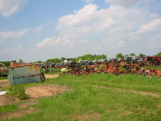

Went hunting for a gearbox with a slip clutch. This place is located in Black Creek, Wisconsin a big place, friendly folks but expensive. Good place to research models to watch for on auction bills for parts that will fit my plans on a PTO driven buzz saw rig.

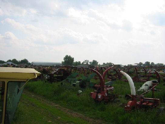

I took this one for the guys that make caster wheeled carriers to move three point equipment around. I didn't have the truck, so I'm just as sad to leave these behind. They came in a choice of blue or green.

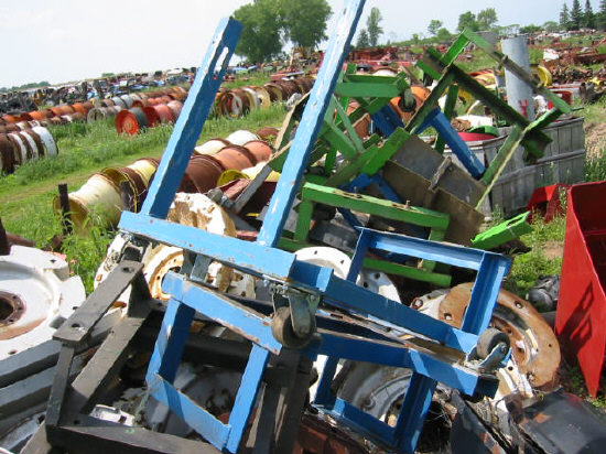

This is the style of gear box I was looking at. It has a auto type clutch for safer use, and are found on cut and throw choppers. Plug the breather and put a breather on the bottom. Flip it over so the bottom is the top and run power with v-belt pulleys back to the saw, that is the plan. This junk yard was to expensive, so I will search around to find a good deal.

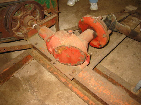

This is what a IH #15 or #16 or #350 gear box looks like on my uncle's buzz saw. The previous photo shows a 770 or 717 Hew Holland gear box.
