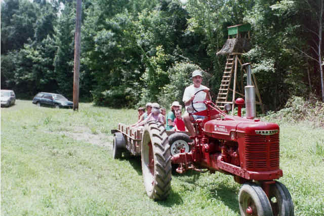

   / Tractor and Trailer Suggestion #6
Strictly amateur.
24 hp. On one of his good days.
Insurance? For this bunch?
Wm
