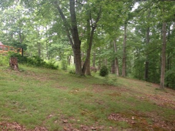

Side yard showing typical slope of hill. Due to the layout I end up doing a lot of "sidehill" mowing. According to the build-in iPhone angle finder, some hills that I need to mow are up to 25* (talk about pucker factor on my current rig!)

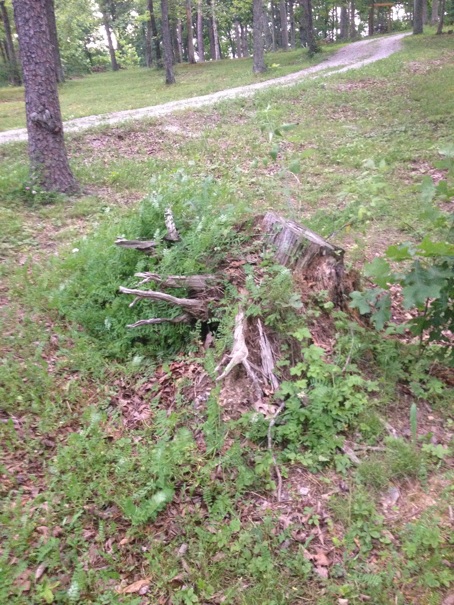

Some stumps should be easier to remove since the tree fell over taking part of the root ball with it. LOTS of other stumps in various states of decay to remove.

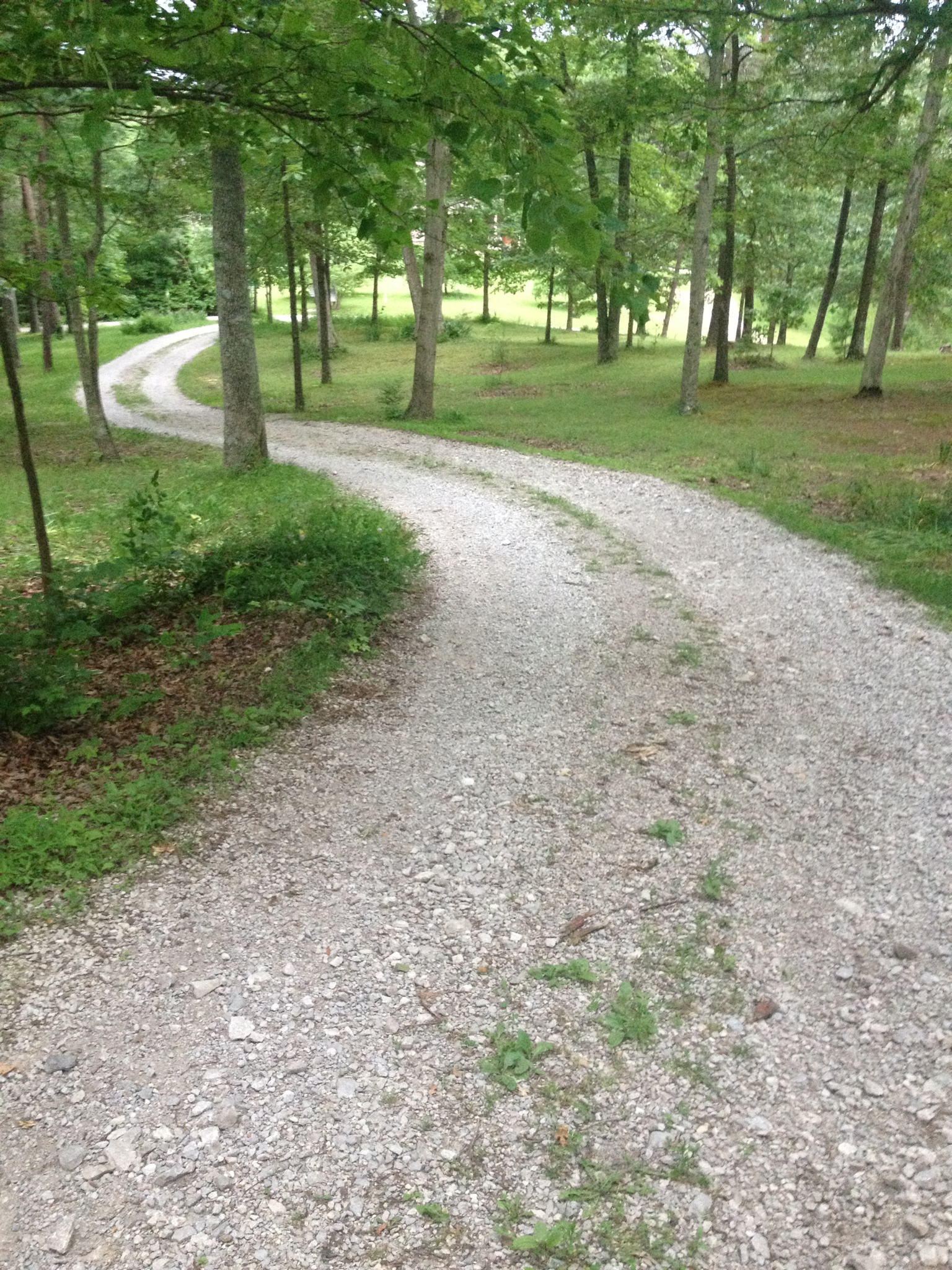

Front driveway to maintain. Gets rutted out after large downpours. Side and back gravel drives require far less maintenance since they're relatively flat.

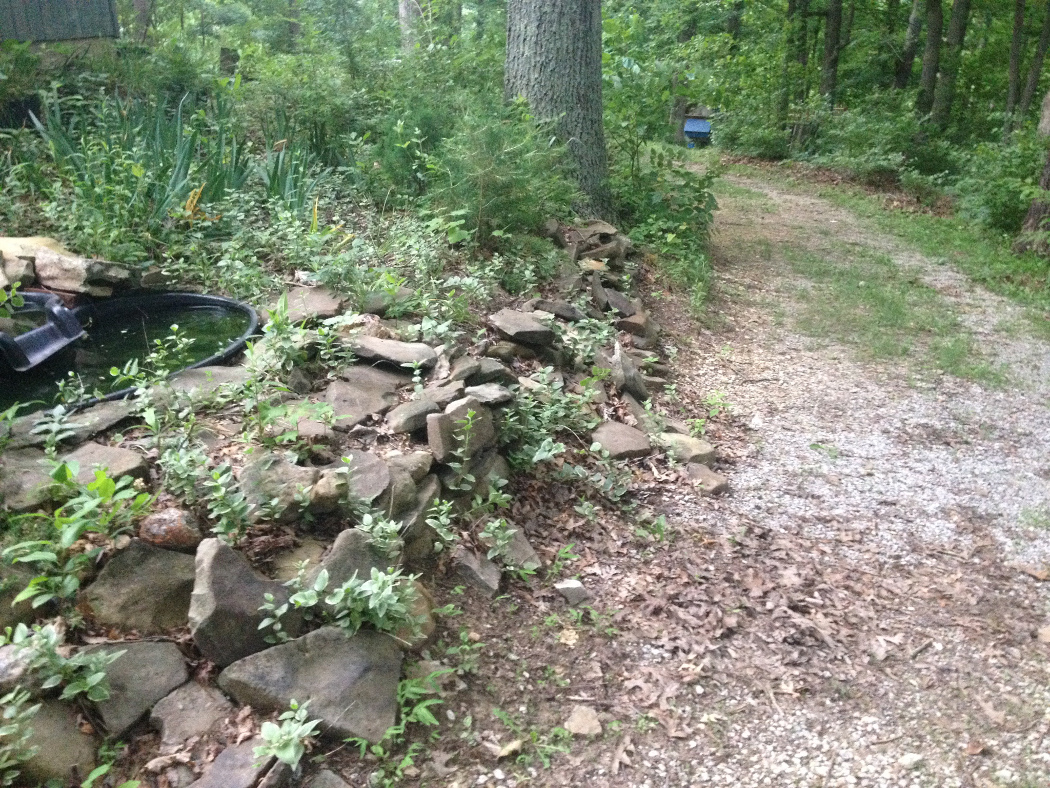

Example of an existing "retaining" wall of dry stack stones that needs to be redone. Additional retaining walls could be built throughout the property in the future.

Very nice job in your descriptions...you must like to type !! I am thinking a SCUT will be to small and under powered for your use. I live in a National Forest that is also quite hilly. So having a bigger tractor didn't serve a purpose. My Kioti is just the right size and weight to get around those trees yet heavy and wide enough to do the job.
Being on slopes you want as wide a tire track as possible, plus the extra weight to keep you stable.

Cutting across a 25* slope? Without a ROPS? Wow. Owners manual for CK27 specifies MAX 15*. I myself would want a zero turn for the mowing - a tractor for everything else.

As for the slope, the majority of the slopes that I mow along are between 15 and 20 degrees (based on my phone, haven't checked its accuracy). The really steep stuff I use the push mower on or just leave alone.
