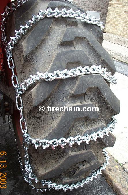

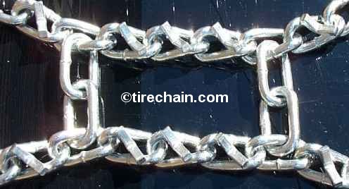

What type of chains do you recommend? I also have to bring fire wood from across a stream and up a steep hill, will chains do the job?
   / tractor almost owner owner #8
